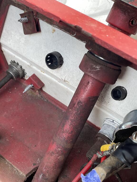

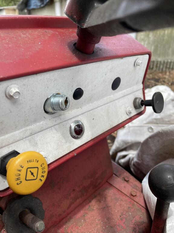

FLtractor 187 #1 Posted April 19 Afternoon, In process wiring new ignition.. what is supposed to go in these black plastic plugged holes? Cigarette lighter goes in.. larger one? What about smaller? Share this post Link to post Share on other sites

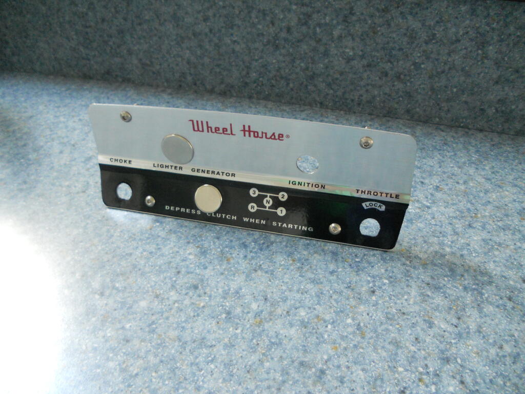

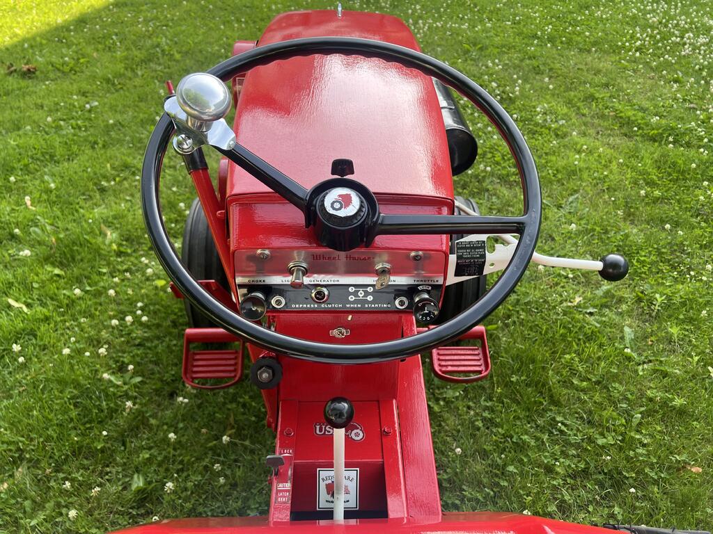

Thegearhead0324 1,710 #2 Posted April 19 It’s not exact but very similar, should go little something like this pic of my 1257. 2 Share this post Link to post Share on other sites

FLtractor 187 #5 Posted April 19 1 hour ago, Thegearhead0324 said: It’s not exact but very similar, should go little something like this pic of my 1257. Thank you for the picture… do you happen to have a link for that beautiful chrome lighter that matches? You got that dash decal from redoyourhorse? Share this post Link to post Share on other sites
Thegearhead0324 1,710 #6 Posted April 19 @FLtractor , the cig lighter is original, also works too. The decal I got from redoyourhorse, there are a lot of decals on there, very good quality as I’ve ordered a few times. 1 Share this post Link to post Share on other sites
FLtractor 187 #7 Posted April 19 12 minutes ago, Thegearhead0324 said: @FLtractor , the cig lighter is original, also works too. The decal I got from redoyourhorse, there are a lot of decals on there, very good quality as I’ve ordered a few times. Oh ok. Thank you for the info 1 Share this post Link to post Share on other sites

Racinbob 13,040 #10 Posted April 20 (edited) @FLtractor Take a peek at these offerings by Redo. I used one on the Indy. METAL DASH PLATE DECALS - Redo Your Horse Edited April 20 by Racinbob 1 1 Share this post Link to post Share on other sites
