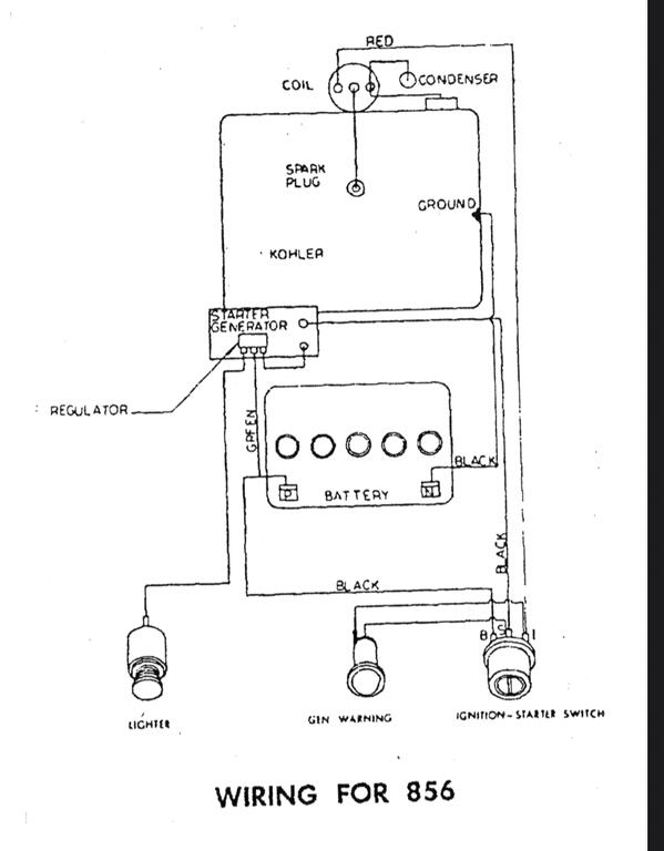

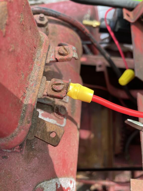

FLtractor 196 #1 Posted April 19 (edited) Afternoon, Based on 856 wiring diagram .. the middle voltage regulator wire.. to make sure I read the diagram correctly … the middle voltage regulator wire… goes to the positive battery terminal then the positive battery terminal goes to the B on ignition.. is this correct way or do I wire the voltage regulator middle wire directly to ignition Battery terminal? Edited April 19 by FLtractor Share this post Link to post Share on other sites

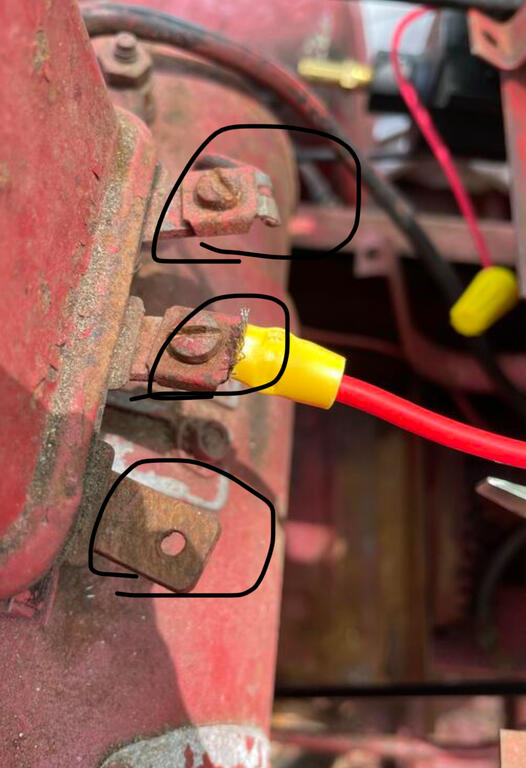

pfrederi 20,992 #2 Posted April 19 12/14ga wire Center regulator terminal to the Battery + 4/6ga wire Battery Plus to B terminal on ignition switch You need to seriously clean up regulator terminals 2 Share this post Link to post Share on other sites
Handy Don 17,189 #3 Posted April 19 4 minutes ago, pfrederi said: You need to seriously clean up regulator terminals And any other connections in similar condition. It doesn’t take a lot of rust to seriously impede the flow of those poor little electrons trying to do their job! 1 Share this post Link to post Share on other sites
pfrederi 20,992 #4 Posted April 19 My answer above assumes this is an original 4 terminal regulator. You really should clean the terminal and make sure it says BAT not GEN...On 3 wire regulators the center terminal is GEN and goes to the A terminal on the genny. 2 Share this post Link to post Share on other sites

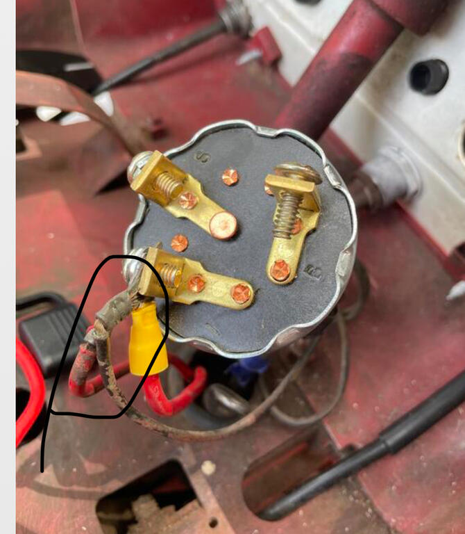

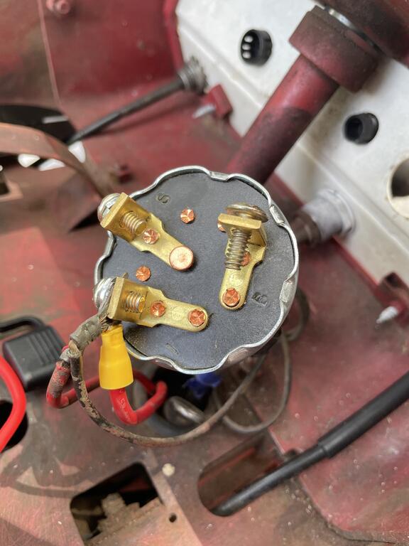

squonk 47,729 #5 Posted April 19 (edited) While you cleaning up the regulator. Repair that connection on that new switch! Edited April 19 by squonk Share this post Link to post Share on other sites
FLtractor 196 #6 Posted April 19 1 hour ago, pfrederi said: 12/14ga wire Center regulator terminal to the Battery + 4/6ga wire Battery Plus to B terminal on ignition switch You need to seriously clean up regulator terminals Battery plus - you mean positive battery terminal to ignition? Some light 220 grit sand paper the terminal to clean up the rust? Share this post Link to post Share on other sites
FLtractor 196 #7 Posted April 19 1 hour ago, pfrederi said: My answer above assumes this is an original 4 terminal regulator. You really should clean the terminal and make sure it says BAT not GEN...On 3 wire regulators the center terminal is GEN and goes to the A terminal on the genny. Where would the words BAT and Gen be.. on the circled pieces? when you say center terminal GEN.. where is the A terminal on generator that that connects to? Share this post Link to post Share on other sites
FLtractor 196 #8 Posted April 19 1 hour ago, squonk said: While you cleaning up the regulator. Repair that connection on that new switch! Which connection repair? This one ? Share this post Link to post Share on other sites

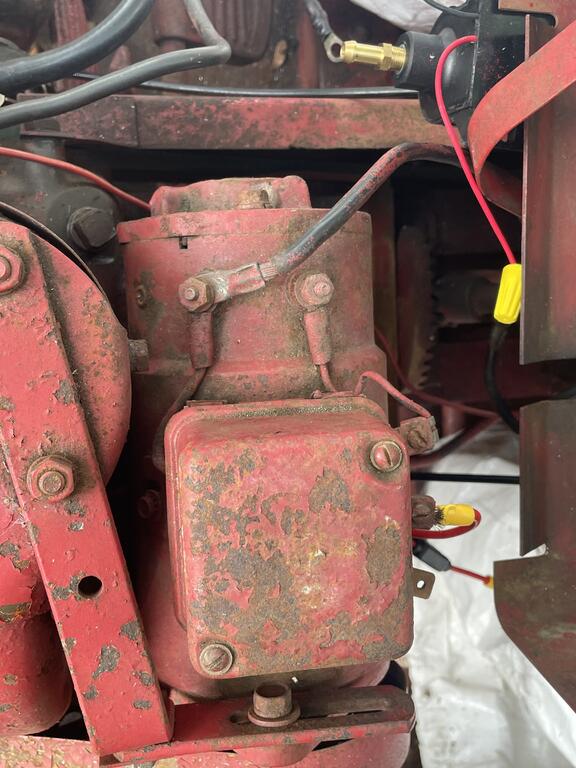

pfrederi 20,992 #9 Posted April 19 (edited) The marks are stamped into the regulator terminal. Wire brush? As rusty as the one is it may have corroded the stamping away. Is yours a 3 or 4 terminal regulator (the 4th terminal is on the bottom if it is a 4 term and a light wire runs from it to the A terminal on the Generator body Heavy 4/6 ga wire Battery + terminal to the Ignition switch. There are two terminals on the generator body and there is a stampd letter next to them an A which has two wires one light one heavy and and F one wire from the F terminal on the regulator Edited April 19 by pfrederi 1 Share this post Link to post Share on other sites
pfrederi 20,992 #10 Posted April 19 27 minutes ago, FLtractor said: Which connection repair? This one ? There are normally only two wires here I assume the new red one is for the fuel pump you are installing and is not the new red one in the regulator picture that would be wrong. Share this post Link to post Share on other sites
squonk 47,729 #11 Posted April 19 30 minutes ago, FLtractor said: Which connection repair? This one ? Yes. Those wire connections are junk. Dirty, exposed wires. Bent almost 90°. All of that makes heat. The only one that looks like it might be ok ok is the main red wire with the yellow connector. Share this post Link to post Share on other sites
FLtractor 196 #12 Posted April 19 30 minutes ago, pfrederi said: There are normally only two wires here I assume the new red one is for the fuel pump you are installing and is not the new red one in the regulator picture that would be wrong. 50 minutes ago, pfrederi said: The marks are stamped into the regulator terminal. Wire brush? As rusty as the one is it may have corroded the stamping away. Is yours a 3 or 4 terminal regulator (the 4th terminal is on the bottom if it is a 4 term and a light wire runs from it to the A terminal on the Generator body Heavy 4/6 ga wire Battery + terminal to the Ignition switch. There are two terminals on the generator body and there is a stampd letter next to them an A which has two wires one light one heavy and and F one wire from the F terminal on the regulator Only see 3 terminals on voltage regulator. light wire as in for headlights ? Share this post Link to post Share on other sites
FLtractor 196 #13 Posted April 19 (edited) 34 minutes ago, pfrederi said: There are normally only two wires here I assume the new red one is for the fuel pump you are installing and is not the new red one in the regulator picture that would be wrong. The old red wire is coil to I on ignition. new wire is fuel pump to I on ignition. Old black wire is to the jewel generator Warning 856 dash- to the I on ignition. Edited April 19 by FLtractor Share this post Link to post Share on other sites
pfrederi 20,992 #14 Posted April 19 (edited) 43 minutes ago, FLtractor said: Only see 3 terminals on voltage regulator. light wire as in for headlights ? If the bare rusty terminal cleans up to show "L" Then you have a 4 terminal system. AGAIN... is there a terminal and wire coming out the bottom of your regulator???? When i say light I mean light gauge wire... Where does the new red wire with yellow crimp terminate on your regulator go. Look I am getting old an I try to use a variety of wire colors makes tracing things much easier.... not all red Edited April 19 by pfrederi Share this post Link to post Share on other sites
FLtractor 196 #15 Posted April 19 (edited) 32 minutes ago, pfrederi said: If the bare rusty terminal cleans up to show "L" Then you have a 4 terminal system. AGAIN... is there a terminal and wire coming out the bottom of your regulator???? When i say light I mean light gauge wire... Where does the new red wire with yellow crimp terminate on your regulator go. Look I am getting old an I try to use a variety of wire colors makes tracing things much easier.... not all red Don’t see any L… the new red wire with yellow on middle voltage regulator.. goes from there to battery + on battery itself .. then the battery wire to the B on ignition. there is this wire underneath my voltage regulator.. see picture.. which I think goes to the starter gen nut terminal on top of the starter .as seen in my 2nd picture here .: .. does that mean it’s a 4 terminal? If so.. what exactly do all the terminals .. 3 on front where red middle wire do and are for exactly? Edited April 19 by FLtractor Share this post Link to post Share on other sites

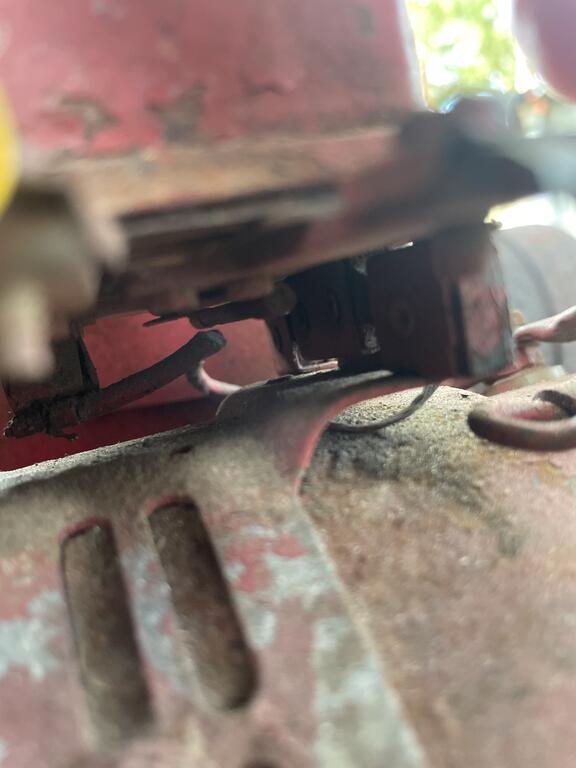

pfrederi 20,992 #18 Posted April 19 (edited) 2 hours ago, FLtractor said: Don’t see any L… the new red wire with yellow on middle voltage regulator.. goes from there to battery + on battery itself .. then the battery wire to the B on ignition. there is this wire underneath my voltage regulator.. see picture.. which I think goes to the starter gen nut terminal on top of the starter .as seen in my 2nd picture here .: .. does that mean it’s a 4 terminal? If so.. what exactly do all the terminals .. 3 on front where red middle wire do and are for exactly? you have a 4 terminal regulator. From the top of this picture .."F" Field wire goes to the F terminal on the generator body Center is Battery goes to the Positive (+) terminal on the battery , Bottom rusty one is the L load terminal (could power your cigar lighter). The wire coming out from under neath goes to the Genny A terminal. If you cleanup the Generator body you will see the stamped F and A marking the two terminals. A has the heavy and light wire. as mentioned above you really need to clean things up. Makes wiring easier. Edited April 19 by pfrederi 1 Share this post Link to post Share on other sites
702854boy 1,072 #19 Posted April 20 It looks like you might need to redo the bottom wire on your regulator Share this post Link to post Share on other sites

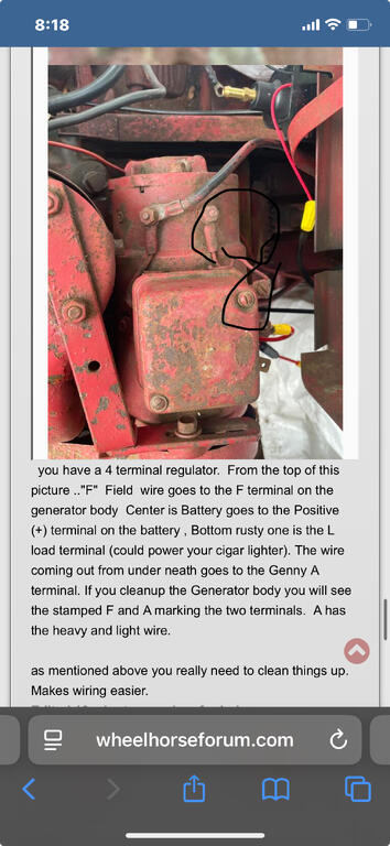

FLtractor 196 #21 Posted April 20 21 minutes ago, pfrederi said: you have a 4 terminal regulator. From the top of this picture .."F" Field wire goes to the F terminal on the generator body Center is Battery goes to the Positive (+) terminal on the battery , Bottom rusty one is the L load terminal (could power your cigar lighter). The wire coming out from under neath goes to the Genny A terminal. If you cleanup the Generator body you will see the stamped F and A marking the two terminals. A has the heavy and light wire. as mentioned above you really need to clean things up. Makes wiring easier. So is F the wire here I circled- that goes to top or leftest terminal voltage regulator. The wire underneath- that goes to generator- does that power the voltage regulator? Share this post Link to post Share on other sites
FLtractor 196 #22 Posted April 20 14 minutes ago, 702854boy said: It looks like you might need to redo the bottom wire on your regulator It appears I should Share this post Link to post Share on other sites
pfrederi 20,992 #23 Posted April 20 Yes the Field is correctly wired. F on regulator to F on the generator body. I don't see anything wrong from the picture about the wire coming from under the Regulator to the A terminal on the generator body (the thinner wire hooked up there with a heavy one ) it doesn't power the generator what it does is takes out put from the Generator A terminal and regulates the amount and feeds it to to the battery when it is in charge mode (ie,the engine running.) Share this post Link to post Share on other sites
FLtractor 196 #24 Posted April 20 1 hour ago, pfrederi said: Yes the Field is correctly wired. F on regulator to F on the generator body. I don't see anything wrong from the picture about the wire coming from under the Regulator to the A terminal on the generator body (the thinner wire hooked up there with a heavy one ) it doesn't power the generator what it does is takes out put from the Generator A terminal and regulates the amount and feeds it to to the battery when it is in charge mode (ie,the engine running.) Interesting.. so is generator A.. the part of tractor that the dash gen warning jewel refers to specifically is that amount of feed regulation? If less than battery than the dash jewel remains lit even after initial starter engagement when key is turned? Share this post Link to post Share on other sites
pfrederi 20,992 #25 Posted April 20 If generator output is less than battery voltage light glows.. When you turn key to run there is no output from generator so it is less than battery voltage so light glows. Share this post Link to post Share on other sites
