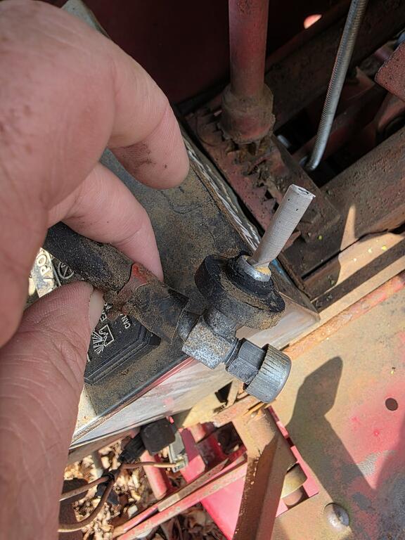

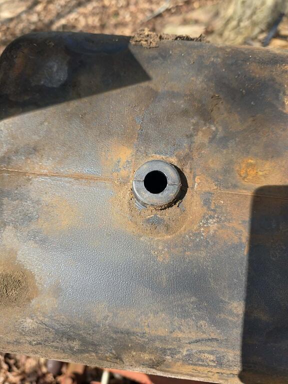

i know its probably been asked a million times. but i cant find it in here. anyone got a part number for the rubber or a fix to get rid of it?

I get ours from
Aircraft Spruce & Specialty.
They have several types of valves, grommets, and the good quality electric fuel pumps available.
Pricing is excellent. Service as well.
  • Like 7

@Jayoutdoors  do your self a favor , get some  dielectric grease , small tube , makes that  replacement  easy simple , the rubber  slide difference  is amazing , also added a  fuel filter  at each  end to  carb along with a  fuel check valve just before carb ? holds  fuel up to  carb  for quicker starts , pete
