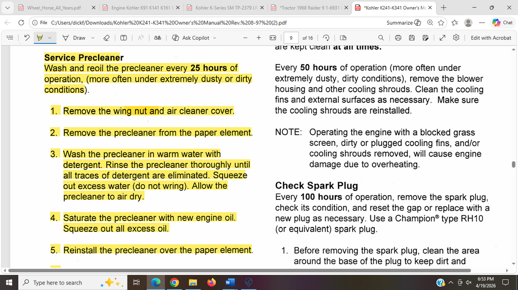

953 nut 68,495 #5 Posted April 19 (edited) I have always oiled my prefilters, about a teaspoon of oil applied to one side, turn it inside-out, put it in a plastic bag and massage the oil into the entire prefilter. Wring out any excess oil into the badg, turn it right side out and apply it to your filter. This is from the Kohler operaters manual. Edited April 20 by 953 nut fat finger 1 1 Share this post Link to post Share on other sites
