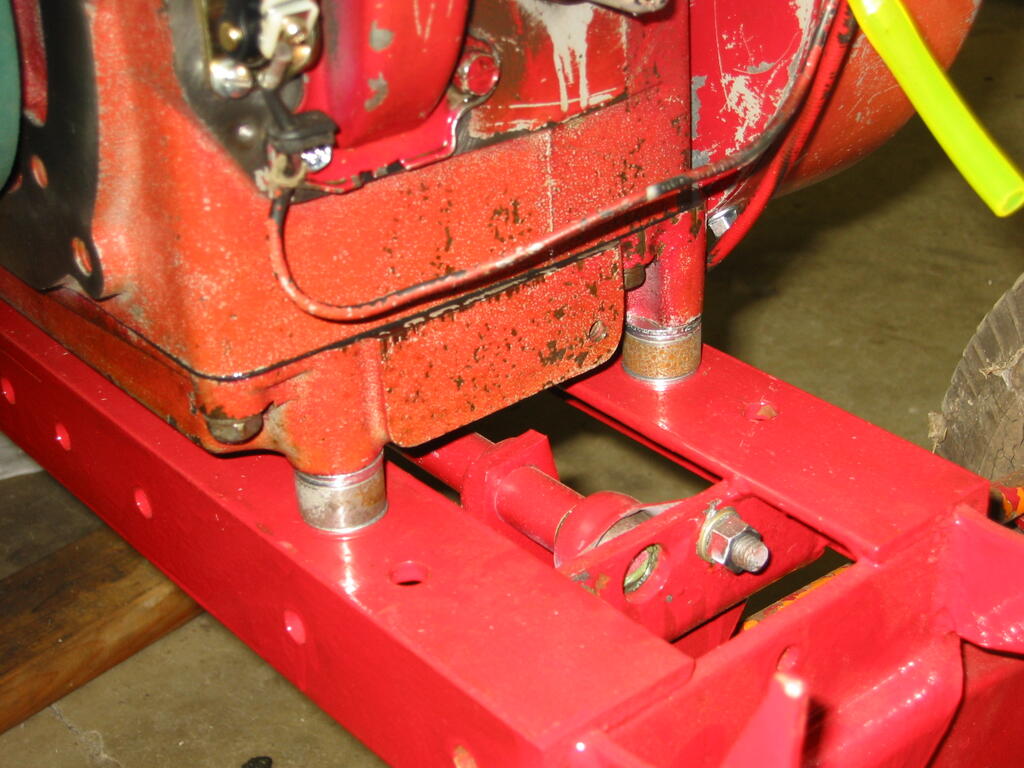

pfrederi 20,924 #4 Posted April 19 (edited) Here is a shaker mount K bolted direct to frame. Spacers are the same ones used in a 8hp shaker mount plus 3 washers... No belt guard mods needed Edited April 19 by pfrederi 7 Share this post Link to post Share on other sites

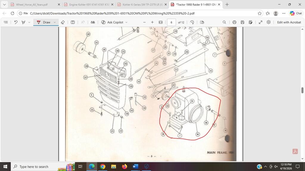

953 nut 67,644 #5 Posted April 19 (edited) 2 hours ago, ebinmaine said: I'd agree with that based on the 1974 C160-8 Tecumseh / Kohler belt guard being interchangeable. Looked into this a bit further. Acording to our friends on AI all Kohler 241,301, 321, and 341 have the same crankshaft center line but the HH100 Tecumeh is about 2 1/2" shorter. The Ponds were nororiouslt thrifty so the Tecumseh was on a mounting riser to make it work with the same belt guard as shown below. But, since he has a K-301 on the B-100 now I'm rather sure the cradle will work out foe that one too. For 10-16 HP Kohler K-Series engines (K241, K301, K321, K341), the centerline of the crankshaft to the mounting base (deck height) is typically 8.625 inches. This dimension is consistent across the 10-16 HP cast iron block series, facilitating interchangeability. The factory crankshaft centerline distance from the base of the engine (mounting plate) for a Tecumseh HH100 is typically 6.125 inches. well, the site won't let me add the drawing with the engine riser here so I will do another thread. OK, It let me edit the post with the drawing. Edited April 19 by 953 nut 1 1 Share this post Link to post Share on other sites
