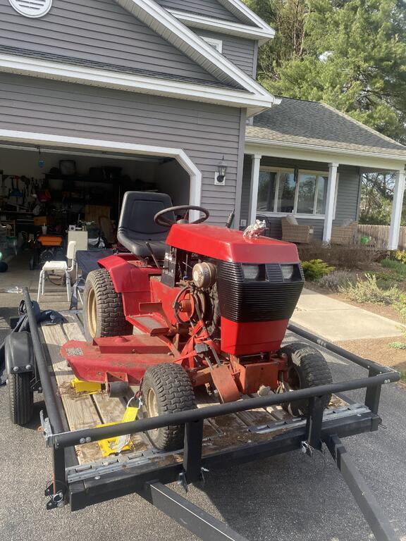

Phil K 1 #1 Posted April 19 Hello I am resurrecting a barn find 1985 312-8 for an old gent. It was his father’s. Been in the barn since 1996. i dragged it out and brought it home. Some soap and water did wonders. Pulled the tin and cleaned out the mouse nests. bought a battery. Replaced the starter. Good compression. No spark. Had a used coil , new condenser and points for my k321. All the same. set at .020 with feelers. Now no fuel to carb. Replaced pump and fuel line from tank. Now fuel. Won’t fire. Pulled the carb. Took the bowl off. Filled with shellac. Bought an aftermarket #26 carb. Put it on. Had to shorten the new rod from carb to governor arm to fit. Fires right up. I can’t seem to get the governor set right. Held open throttle and turned rod CCW until stop hit. Tightened bolt. Fired up. Give it throttle and then after a bit the rpm’s increase on its own. I’m at wits end. Help! Share this post Link to post Share on other sites
