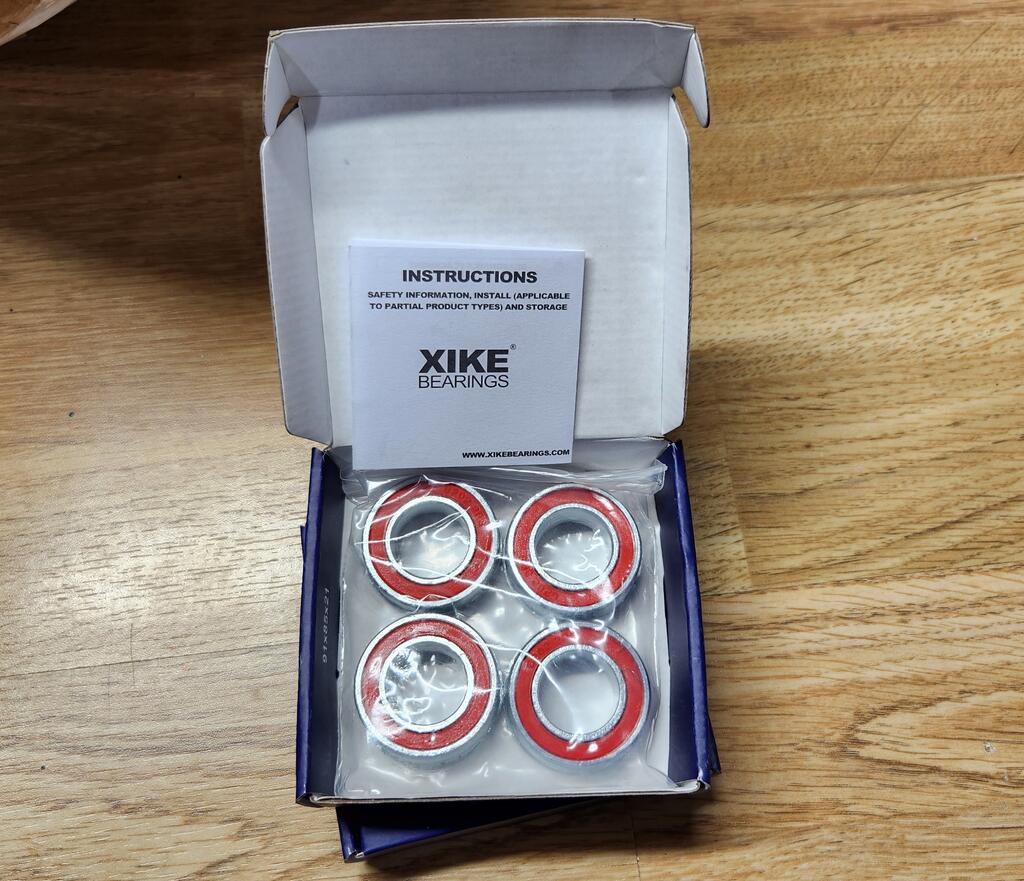

Racinbob 13,040 #10 Posted April 20 Been using these for quite a few years now. About $12.00/4. I can change a lot of bearings and still be ahead but I haven't had to yet. 4 Share this post Link to post Share on other sites
