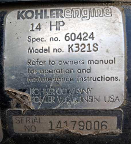

gwest_ca-(File Mod) 12,557 #2 Posted April 17 There are 3 models of each so post the model numbers and serial numbers when you get them. If not possible the engine spec number and engine serial number will help with identifiation. 2 Share this post Link to post Share on other sites
nyquil junkie 333 #3 Posted April 17 Will do thanks. 1 Share this post Link to post Share on other sites

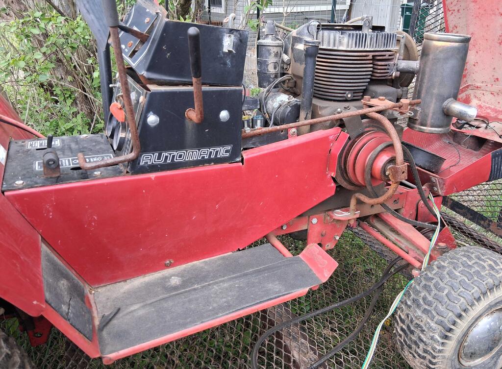

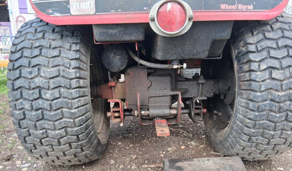

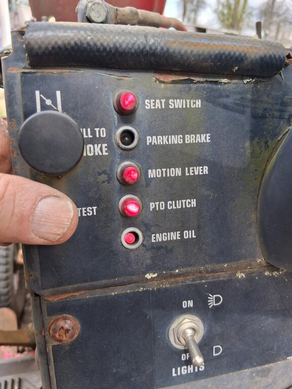

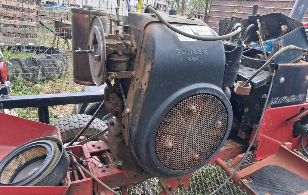

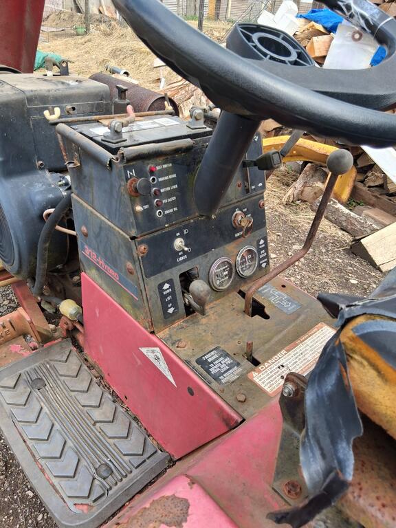

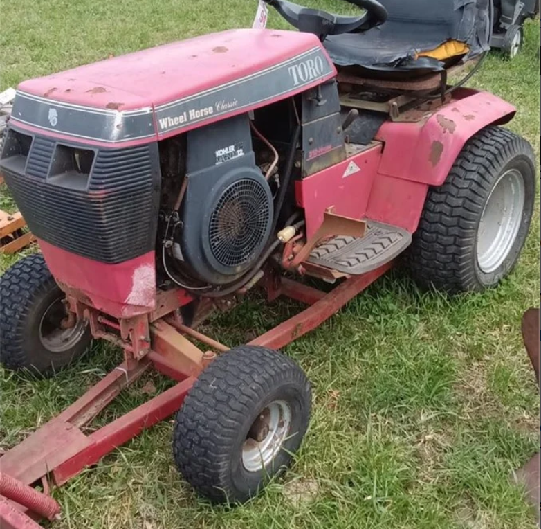

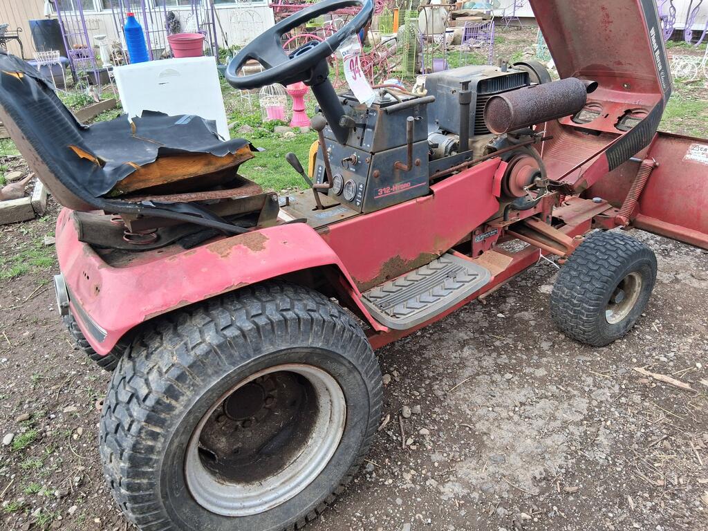

nyquil junkie 333 #7 Posted April 17 Here's a few screen caps. 3 Share this post Link to post Share on other sites

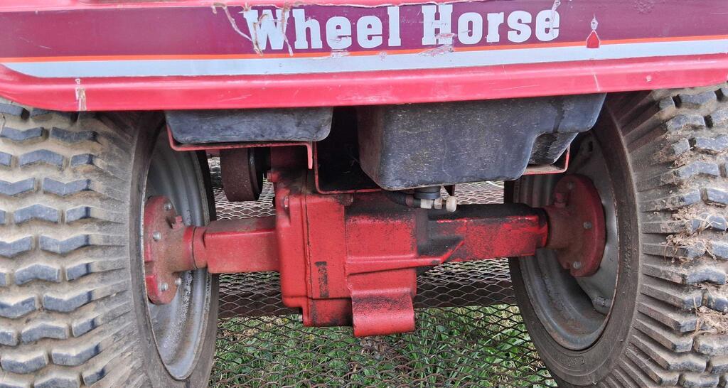

953 nut 70,649 #8 Posted April 17 The one with the Eaton 1100 can be pushed with no problem, The Eaton 700 well need to have the rear wheels put on a pair of dollies. Share this post Link to post Share on other sites
nyquil junkie 333 #9 Posted April 17 Mmm. aint got a dolly. maybe it'll rain tonight and it'll slide in the mud when I drag it on the trailer. That sucks. 1 Share this post Link to post Share on other sites
Pullstart 71,561 #10 Posted April 17 16 minutes ago, nyquil junkie said: Mmm. aint got a dolly. maybe it'll rain tonight and it'll slide in the mud when I drag it on the trailer. That sucks. If you give it a shove in a manner that you can spin a wheel backwards, it’ll scoot right along. Put your hip into it so that backwards spinning wheel is lighter than the forward spinning wheel. 3 Share this post Link to post Share on other sites
JCM 11,470 #11 Posted April 17 Am I missing something. Both the A and the 1100 are both automatics correct. My Eaton 1100's don 't push very far at all. That's what your WH Classic should be equipped with. The A has the Eaton 700. Share this post Link to post Share on other sites

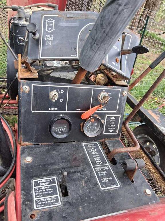

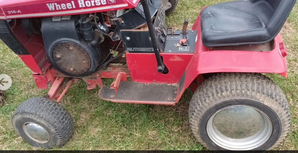

nyquil junkie 333 #21 Posted April 19 Ok I got em here. The running one fired right up and drove on the trailer. The dead one I hooked a winch to and slllooowwwly inched it onto the trailer. The 312hydro runs fine, its been used hard and needs some adjusting and whatnot. It likes to inch forward or backwards on its own, the F-R lever wont stay put, it springs back to N. A little TLC and it'll be a good scraper/puller. The 314-A, someone there at the auction looks like they tied a rope to the steering wheel and tried to lift it, pulled the shaft out of the rack and bent the dash. Probably nothing that cant be fixed. Overall it looks like somebody took care of it, clean oil no leaks, all the wires and whatnot seem to be where they are suppose ot be and havent been messed with or spliced up. The problem with that one is, it has no spark, I put a battery on it, turned the key, and nothing happens. I pushed the seat safety button down, still nothing. So I jumped the starter right to it, and it spins over good. Compression is good. No sparks, on the plug or on the coil wire to it. So, I'll have to figure out why here at some point. I'll have to start an engine group thread and go from there. Heres some pics.. first up the 312hydro 2 Share this post Link to post Share on other sites
nyquil junkie 333 #22 Posted April 19 here is the dead 314-A 3 Share this post Link to post Share on other sites
nyquil junkie 333 #23 Posted April 19 Found it.... bad solenoid. We piped gas to the pump and it fired right up... idles like a new one. Now, if it only could steer. 1 2 Share this post Link to post Share on other sites
