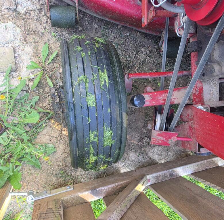

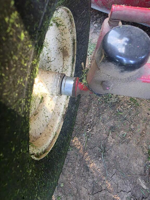

Goldnboy 1,156 #1 Posted April 16 I know a lot of members here run V61's on there tractors but I don't recall anyone mentioning that the mule drive can interfere with turning. I couldn't turn left fully without rubbing on te mule drive. So i added a 1/2" collar on the spindle two machine washers and then inserted a bushing inside the rim along with a longer bolt and problem solved. However for those running newer machines that use a snap ring in place of a bolt this would not be a viable solution. 1 1 1 Share this post Link to post Share on other sites

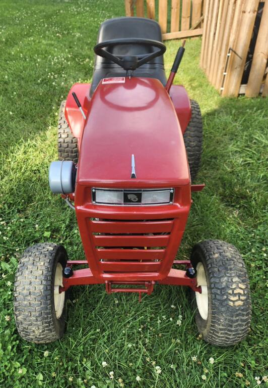

sqrlgtr 4,225 #7 Posted April 17 (edited) Here is mine on the C160 and they look like they have enough room for mule drive but I hadn't had one on this mochine in awhile. 1974 year model Edited April 17 by sqrlgtr 1 1 Share this post Link to post Share on other sites

sqrlgtr 4,225 #10 Posted April 17 11 hours ago, Goldnboy said: The V61's are the smaller 16x6.50x8/170x60x8. same thing on the C160 pictured above and I "think" they are on 4" wide wheels. Share this post Link to post Share on other sites
