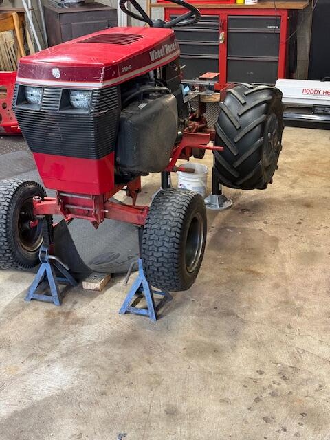

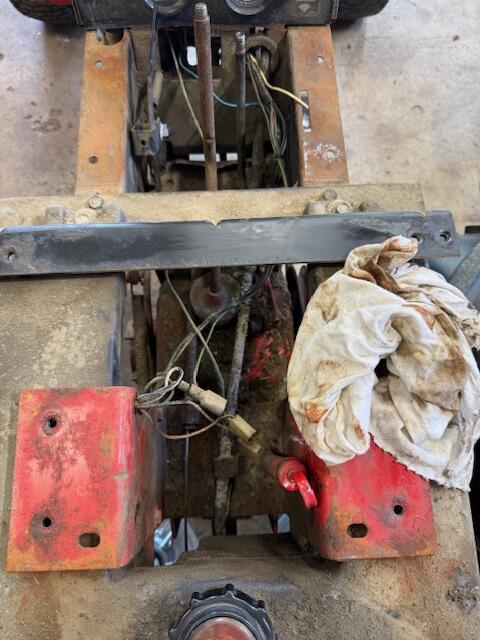

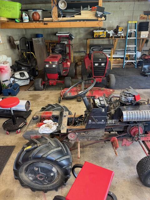

so I took a few days off work to play and work around the house, since it was nice outside today I mowed grass and then had some play time with the recent acquired 418-8. Wow the PO didnt clean it much at all, he kept it under an awning outside so the dirt just built up each season. I took the covers off and the seat pan to try and clean up to see some red paint. I used the purple power stuff letting it soak a min and then used my pump up spray jug to spray off the crud and grease. It really did a decent job cutting a good bit off, then taking a scraper and working the more stubbern stuff and then soap and spray again. Theres a good bit of red paint now to see, but a good bit of corrosion too. Had to cut a couple bolts off removing the tins due to the elements fusing them together. pics are a start and Ill get some after pics in a day or two. I think Ill paint a few of the tins before putting back together but nothing speacial at this point.

Are these Wheel Horse wheel weights?

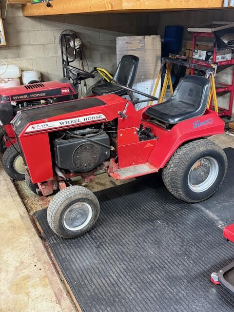

Thor27
The super in the background looks good too!
Thats funny cause I thought that too when I took the pic, but it’s just a 175 with 520 wheels on the back. But sitting next to the 520 makes it look bigger for some reason. IDK maybe difference in tire pressure? Plus it’s not a concrete floor in that part of the garage, just gravel with carpet on top. Lol! But still it’s a big difference in looks. Wow just looked at the tires size and never realized they are 24” instead of 23”.
