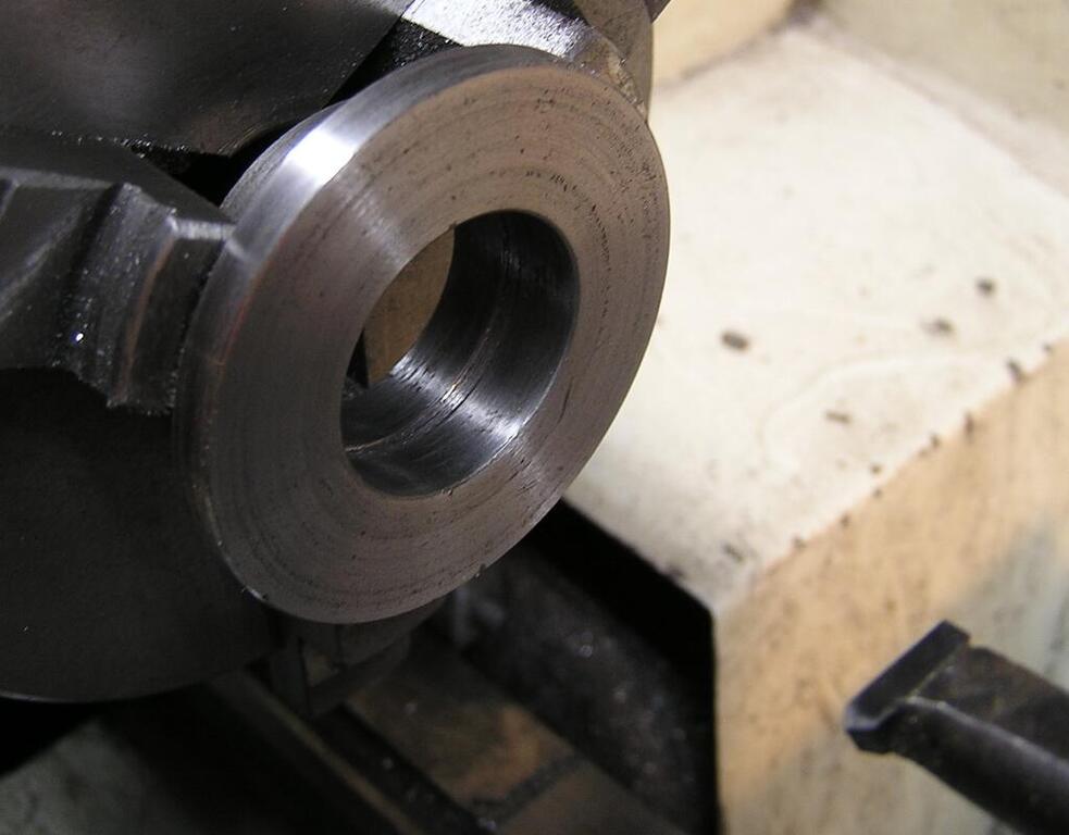

ri702bill 13,055 #1 Posted April 13 Before reinstalling the large flange bushings for the C series Lift Lever, I decided to add a shallow grease groove centered in the ID. (@peter lena would approve) The 60 degree internal threading tool works perfectly for this. Judging by the fine powdery chips prodiced, these bushings are made of iron.... I did not expect that. 3 Share this post Link to post Share on other sites

ri702bill 13,055 #3 Posted April 13 (edited) 2 minutes ago, 702854boy said: Your title is made up of the four most expensive words in the whole English language I see your point - it often requires a detour, but seldom to a deadend road.... Those bushings and the lack of them at all where the clutch goes thru the frame are almost impossible to lubricate under normal use except with a hit-or-miss spray wand. So.... Edited April 13 by ri702bill 1 3 Share this post Link to post Share on other sites

ri702bill 13,055 #5 Posted April 13 23 minutes ago, ebinmaine said: Another excellent maintenance addition. Even if this were done in place using a Dremel (and both the good eye & steadiest hand), it is still an improvement.... 3 Share this post Link to post Share on other sites
