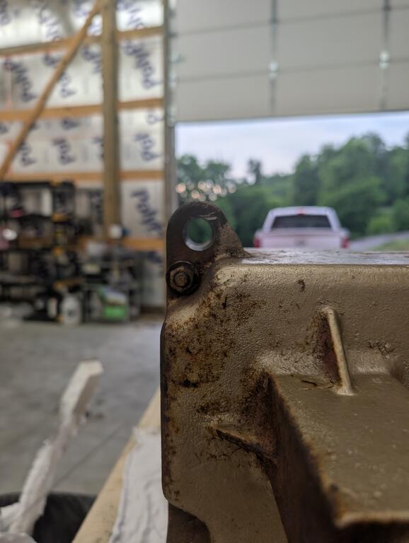

Handy Don 16,927 #51 Posted May 5 14 minutes ago, Buschlight13 said: I think larger diameter rod with bigger threads lol. Gonna have to make the inside wider... I've almost spent more on getting this pin out than I did on the tractor 😂 Threaded rod is not particularly strong. It might be worth buying a higher grade bolt and nut. Share this post Link to post Share on other sites
wallfish 20,214 #52 Posted May 5 (edited) 1 hour ago, Buschlight13 said: Really thought this was gonna do it. But it actually ripped the threads off the bolt and rod. Crank tight but before over doing it beat the other end into the hole, crank tight again, beat again. Rinse and repeat. Maybe a 1/2" rod or bolt but the head needs to fit through the hole. If you do get it to budge, maybe reverse the direction and do the same thing. Rinse and repeat that back and forth while spraying lube in there too. It should move a little farther each time you reverse direction. This one might need to be drilled out. Edited May 5 by wallfish 1 Share this post Link to post Share on other sites
Buschlight13 15 #53 Posted May 15 It defeated me. Dropped it off at a machine shop though, and they are gonna try to get it out. If they can't.... Idk. lol Share this post Link to post Share on other sites
Buschlight13 15 #54 Posted May 27 Hitch pin is out. 5 Share this post Link to post Share on other sites
