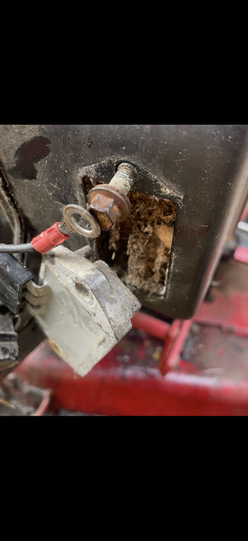

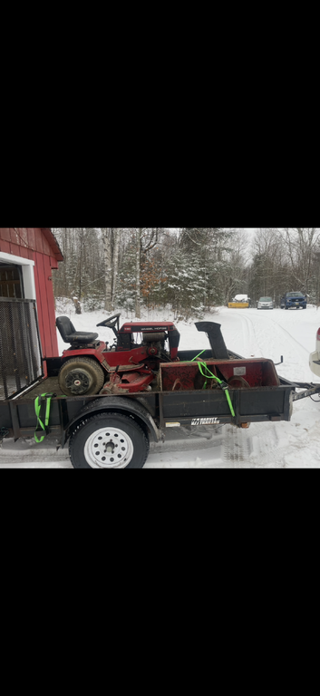

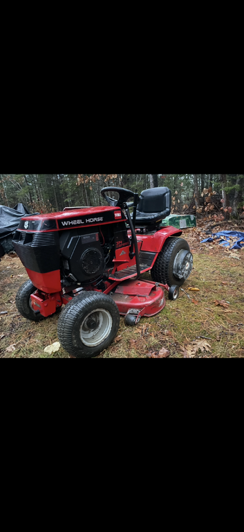

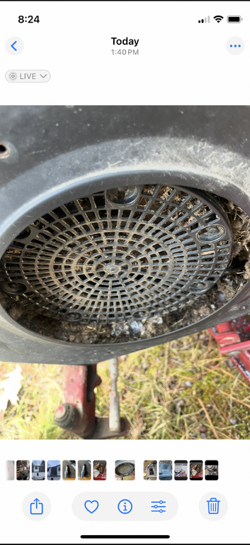

AHS 1,701 #1 Posted April 12 11/16/25 I was going to look at a 314-8 with a BerVac 46” snowblower and a 42” RD (pretty mint!). 462 hrs!! He was the original owner and had all the paperwork from when it was new. So, we struck a killer of a deal. Did I mention that he said it hadn’t run in 6 or 7 years?! I rolled the dice, (I mean, hey it was a Kohler!!) I got it home. It was snowy out but i got the mouse nest out from under the motor tin and i pushed it back into the garage for the winter. Till today!! I did all the usual… cleaned out the tank, put in a new shut off valve, new lines, filter and primer bulb. I rebuilt the fuel pump and cleaned out the carb. There may have been a few things i forgot in there. But, primed the motor and it fired right to life!! It was a bit Smokey at first, 30 seconds into it and it didn’t smoke a bit! I made it around the yard once and the drive belt had had enough, it was toast!! 9 6 Share this post Link to post Share on other sites

My_horse 131 #3 Posted April 13 Looks like mine! Have fun with it. I have the bervac rear weight bracket and weights for mine when I used the blower. I just have the single stage WH blower. The weights pretty much make it unstoppable! 2 Share this post Link to post Share on other sites

AHS 1,701 #5 Posted April 13 10 hours ago, My_horse said: Looks like mine! Have fun with it. I have the bervac rear weight bracket and weights for mine when I used the blower. I just have the single stage WH blower. The weights pretty much make it unstoppable! Ya, the weights and chains were thrown in with it! 2 1 Share this post Link to post Share on other sites

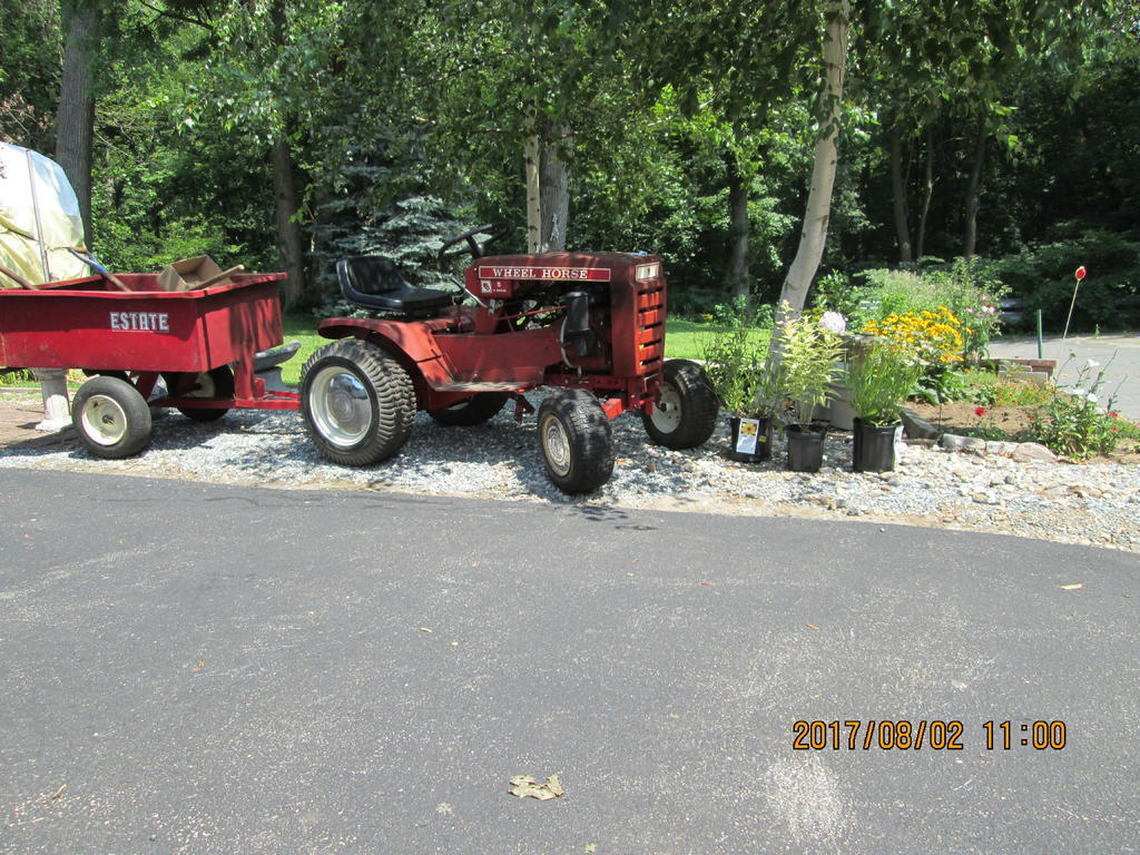

Retired Wrencher 6,989 #16 Posted April 16 15 hours ago, sqrlgtr said: I guess we can say the same thing about the 73 no name 8 had a totally different rims and tires on them with extended axels.. Also, If I remember correctly. They only had a 3 bolt rims and very small tires front and rear. 1 Share this post Link to post Share on other sites
clueless 3,439 #17 Posted April 16 19 hours ago, rick said: Wheel Horse garden tractors were not matched with a deck when shipped, you bought the tractor and chose a deck at time of purchase/order. The 6" wheels were/are required when the tractor is equipped with the 37" cutting deck. The 37" deck has two blades with the left blade offset to the front causing interference with the 8" left front tire on sharp left turns. The lower horsepower rated tractors were more apt to be purchased with the 37" deck than the 14 horsepower and up units. Now why in the world my 1990 416H tractor was factory equipped with 6" wheels is a mystery to me. you could get the 37" deck on the 400 series also if you ordered it, it just came with the 6" wheels. An optional bagger kit was for the 37" deck. 1 1 Share this post Link to post Share on other sites
sqrlgtr 3,929 #18 Posted April 16 A few tid bits of info I had not heard before in above post. 1 hour ago, Retired Wrencher said: I guess we can say the same thing about the 73 no name 8 had a totally different rims and tires on them with extended axels.. Also, If I remember correctly. They only had a 3 bolt rims and very small tires front and rear. I had seen one before and thought that someone had done this on there on and didn't realize they came from the factory like that. 1 Share this post Link to post Share on other sites
kpinnc 18,960 #19 Posted April 16 1 hour ago, sqrlgtr said: they came from the factory like that. Yep. 10 inch rear wheels, 6 inch fronts. Rear axles were about 2.5 inches longer than standard to make up for the wheel offset. Mine did have 5 bolt hubs though. 1 Share this post Link to post Share on other sites
