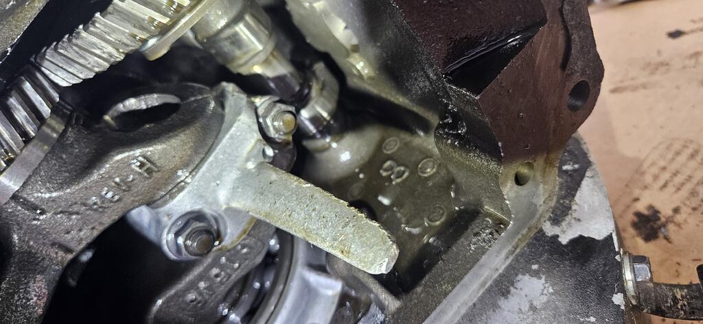

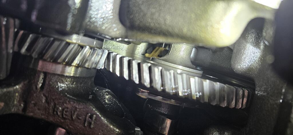

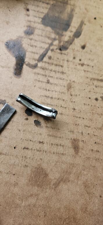

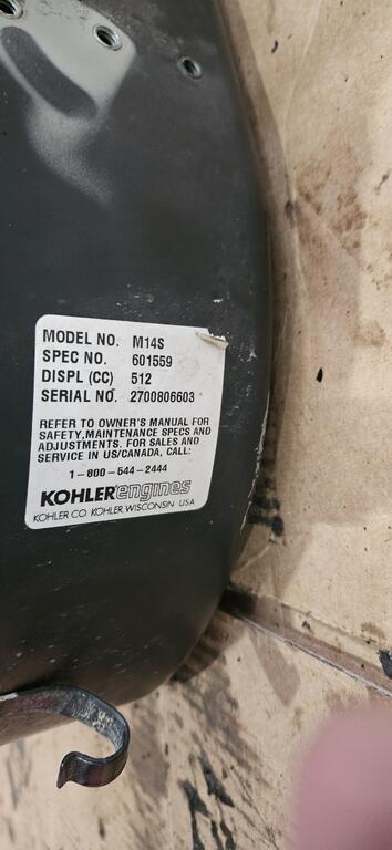

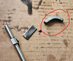

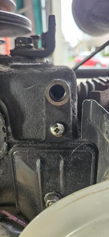

Red Barrons 13 #1 Posted April 12 Long time lurker, first time poster. I always appreciate the information available on these forums - so, thank you! I have a 1997 Toro Wheel Horse 314-8 that was handed down from my grandfather to me some time ago. Recently, while running the tractor, it started to rev heavy. I throttled it down hard, pulled it in the garage, and shut her down. Quickly discovered that the governor shaft was spinning freely. Pulled the engine (Magnum M14S), dropped the oil pan, and was able to remove the governor shaft without any other disassembly (crank shaft, cam shaft, etc). . Sure enough, the flag on the shaft was broken off. Looked in the oil pan and quickly found the "flag". However, I also found another piece of metal in the pan that I cannot, for the life of me, figure out what it is (photo attached). I'm looking for some help determining what exactly the mystery piece is. As far as I can tell from from looking deep into the crankcase, the governor gear appears fine (flyweights are still both attached and move freely, teeth appear fine, middle piston moves in and out freely). Looking at diagrams and videos, the mystery part does not appear to be anything involved with the governor gear - which, if true, makes me happy, as I'm really not in a position to pull everything apart right now. Also, I think I can get a new shaft installed without doing so - though I welcome thoughts from those who've actually done this before. Any help here from someone with more experience than I would be greatly appreciated. Thank you all again for keeping this information, and these old Wheel Horses, alive! 1 2 Share this post Link to post Share on other sites
953 nut 69,724 #2 Posted April 12 When a Kohler single cylinder engine is assembled the first part that goes in is the governor shaft so I don't think you will be able to replace it without an engine disassembly . 4 Share this post Link to post Share on other sites
JoeM 10,316 #3 Posted April 12 Piece of fuel pump lever? 4 1 1 Share this post Link to post Share on other sites

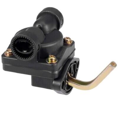

Red Barrons 13 #4 Posted April 12 Quote When a Kohler single cylinder engine is assembled the first part that goes in is the governor shaft so I don't think you will be able to replace it without an engine disassembly Thanks for the welcome and the reply! Ugh, not what I wanted to hear - but appreciate the insight and the manual! If I don't have to replace the governor gear, I'm going to give it a good college try with a pocket extend-o-magnet and some patience. I have very little faith it'll work - but may be worth a try? Quote Piece of fuel pump lever? Okay, so you might be onto something with this - as the fuel pump lever is actuated via the camshaft (which aligns with how it got inside the crankcase). Also of interest, which aligns with this theory: I installed an electric fuel pump about a year ago or so because I was having trouble with cold starts. I have a feeling that that, if true, that broken lever is exactly the reason I was fighting for fuel on starts. I'll try to pull the fuel pump here in the next few days and will let you all know what I find. If this is it, that would absolutely be best case scenario all around. More to come! I can't say THANK YOU enough to both of you! 1 1 Share this post Link to post Share on other sites
953 nut 69,724 #5 Posted April 12 You should take a close look at the camshaft while you are3 in there, lots of action going on around it. 1 Share this post Link to post Share on other sites
Red Barrons 13 #6 Posted April 13 Okay, couldn't wait because it was driving me nuts. You were 100% correct. Broken fuel pump lever. The tractor only has 305 hours on it - meaning it has sat a lot. Looks like that fuel pump froze up and likely broke the lever on a start. Going to replace the pump, of course. Also, will absolutely take a look at that camshaft. Want to make sure nothing got marred up, bent, etc. Thanks to both of you for the help here! I will let you know if I find anything else and/or if I'm successful in doing this without a full disassembly. Fingers crossed! 1 Share this post Link to post Share on other sites

Red Barrons 13 #15 Posted April 21 Hey everyone! Just wanted to follow up with how things went, both to give closure and to maybe help anyone in the future. I was able to get that governor shaft in place and installed without any further disassembly of the crankcase. Took one strong magnet placed on the outside of the governor shaft hole, one extend-o pocket magnet to move the shaft around in the case, and about 10 minutes of my time. Turned the engine on its head, dropped the shaft down at the bottom, then maneuvered the shaft into position using the extend-o magnet. Once it was "in place"-ish, I moved it close enough to the magnet covering the shaft hole. The shaft attracted to the magnet and grabbed over. Then, I just pulled the magnet outward (with the shaft attached) and the shaft walked through the hole. Checked the alignment was correct, installed the shaft sleeve, torqued down the nut, and voila! - new governor shaft installed and ready to go. Reassembled everything (new oil, new oil pan gasket, new fuel pump installed, but not hooked-up to fuel lines (for closure - still using the electric fuel pump)), started her up, and bingo-bango - throttled up and governor-ed down as expected. Thanks again to everyone for the assistance and help here! It is GREATLY appreciated. Thank you! 4 4 Share this post Link to post Share on other sites
