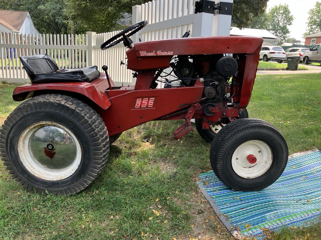

Retired Wrencher 7,043 #2 Posted April 8 (edited) I would say small moves all the way around the caps or moons. A long screw driver or small prybar. Send up a picture of them if you can. How do you like the 856? This one came from the big show a few years back. I like it. Edited April 8 by Retired Wrencher 5 Share this post Link to post Share on other sites
sqrlgtr 4,225 #3 Posted April 8 856 one of my Favorites. This one came back with me from Big Show last year. 1 Share this post Link to post Share on other sites

Retired Wrencher 7,043 #10 Posted April 9 On 4/8/2026 at 7:22 AM, sqrlgtr said: On 4/8/2026 at 7:22 AM, sqrlgtr said: 856 one of my Favorites. This one came back with me from Big Show last year. Nice looking 856. They made them to last back then. Does yours still have the original fuel pump or did you put an e pump on it? Share this post Link to post Share on other sites

sqrlgtr 4,225 #14 Posted April 9 10 hours ago, Retired Wrencher said: Nice looking 856. They made them to last back then. Does yours still have the original fuel pump or did you put an e pump on it? Not original but it does have one of the later plastic mechanical pumps on it. The PO had installed it but works great so far. Share this post Link to post Share on other sites
