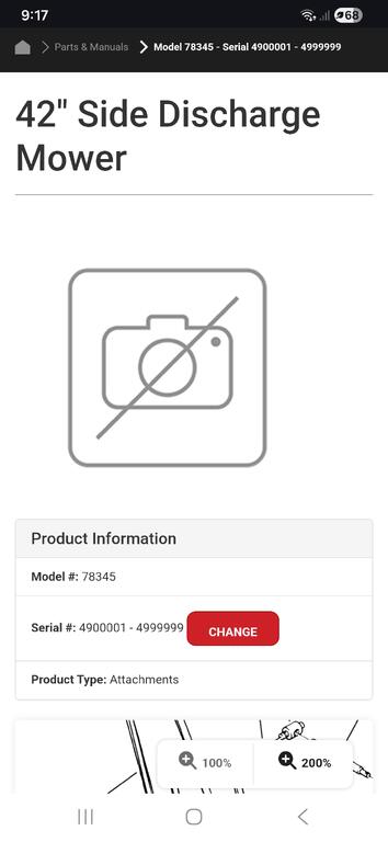

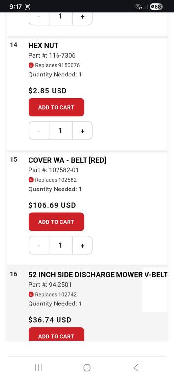

Cee245 881 #1 Posted April 7 (edited) My sil has a model 73401 1994 314H with a model 78345 42" SD deck. I am looking for the pto to deck belt. Part #: 94-2501 according to toro.com In looking on toro.com it's showing that a 52" SD v belt on their site. The 2 pictures are the same page, just had to scroll on my phone to get it all... Anyone know a site to order from with confidence im getting correct belt at reasonable price. Id like oem if possible. Edited April 7 by Cee245 Add model #s 1 Share this post Link to post Share on other sites
gwest_ca-(File Mod) 12,557 #2 Posted April 7 94-2501 is the correct drive belt. The same belt is used as a spindle belt on the 52" deck for the 5xi models. 2 Share this post Link to post Share on other sites
Bill D 3,213 #3 Posted April 7 PTO to deck is 103". Deck belt is 86". 2 Share this post Link to post Share on other sites
