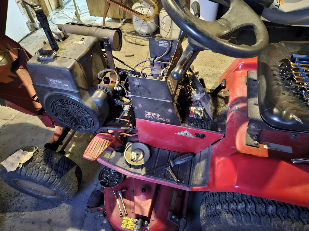

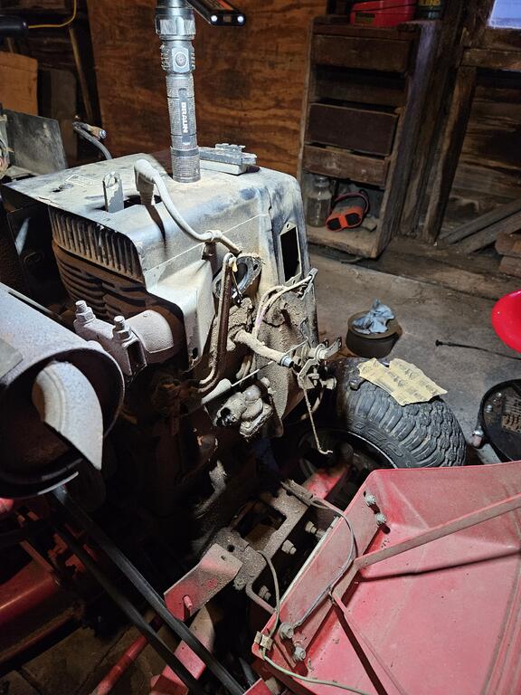

Mike'sHorseBarn 3,681 #26 Posted April 8 Went to work on it tonight. Was told it ran last year, the carburetor would argue otherwise. It was so gunked up it was hard to get apart. Dang near ruined the head of the high speed needle and I don't have walbro stuff laying around 😕 Anywhere, got that off and cleaned up, gotta order a kit, choke cable is broke, gotta get one of those too and an air filter. I put a battery in it and it did turn over after I put a new battery in it. More to come... 4 Share this post Link to post Share on other sites
WHX?? 58,125 #27 Posted April 8 Little dirty but that'll buff out. 2 Share this post Link to post Share on other sites
Handy Don 17,474 #28 Posted April 8 29 minutes ago, Mike'sHorseBarn said: so gunked up it was hard to get apart I've (expensively) learned that when there is resistance, penetrant and patience are allies and haste is the enemy. 2 1 Share this post Link to post Share on other sites
Mike'sHorseBarn 3,681 #30 Posted April 22 I FINALLY got it going tonight! Washed it up and tested it, changed all the fluids! Now to put it to work! 20260421_194503.mp4 1 6 Share this post Link to post Share on other sites

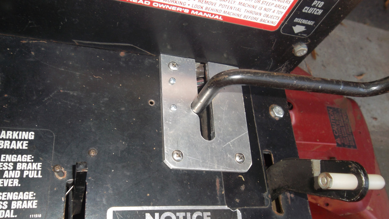

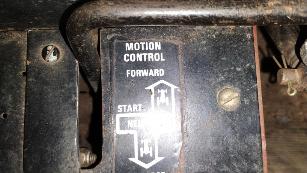

DLF 74 #31 Posted April 27 On 4/7/2026 at 8:43 AM, sqrlgtr said: Guess I'm in the minority I just can't get comfortable with the foot control, but around here you have to be able to slide around on the seat to keep right side up . I can see the foot control being handy pushing with dozer blade or using front end loader though. BTW great score on the 314-H. I improved on the console hand control om my 520-H. 2 1 Share this post Link to post Share on other sites
Handy Don 17,474 #32 Posted April 27 28 minutes ago, DLF said: I improved on the console hand control om my 520-H. How did you handle the “neutral to start” microswitch? Share this post Link to post Share on other sites
sqrlgtr 3,931 #33 Posted April 27 1 hour ago, Handy Don said: How did you handle the “neutral to start” microswitch? I just assumed that is what the 2 screws or holding in the plate he has made but might not be? Share this post Link to post Share on other sites
DLF 74 #34 Posted April 27 1 hour ago, sqrlgtr said: I just assumed that is what the 2 screws or holding in the plate he has made but might not be? I moved the switch with the two small screws. 2 Share this post Link to post Share on other sites
sqrlgtr 3,931 #35 Posted April 27 (edited) 2 hours ago, DLF said: I moved the switch with the two small screws. where to? I thought it looked like the control stick was making switch it when it went into the neutral spot you had made into plate? Edited April 27 by sqrlgtr Share this post Link to post Share on other sites
DLF 74 #36 Posted April 28 2 hours ago, sqrlgtr said: where to? I thought it looked like the control stick was making switch it when it went into the neutral spot you had made into plate? The original neutral slot was deeper had to move the switch for that half circle notch. Also had to cut out some the original plate for the straight groove. 1 Share this post Link to post Share on other sites
cleat 9,333 #37 Posted April 28 18 hours ago, DLF said: I improved on the console hand control om my 520-H. That looks like how wheel horse should have done it from the start. If mine weren't all foot control I would do that as well. Looks like it would be a more natural movement from forward to reverse. 4 Share this post Link to post Share on other sites
Ed Kennell 47,323 #38 Posted April 28 I made a straight slot adapter plate for all the units I converted to foot control. 3 Share this post Link to post Share on other sites
