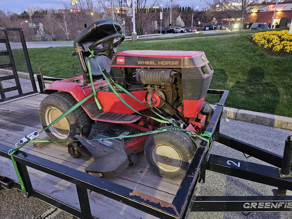

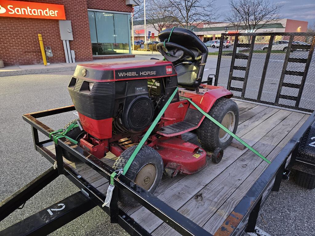

Mike'sHorseBarn 3,712 #1 Posted April 6 I'm going to pick up a non running 314H tonight and was wondering if they had a hydro release to free wheel it? I downloaded the operator manual and the eaton manual and can't find anything. Share this post Link to post Share on other sites
WHX?? 58,388 #2 Posted April 6 No no release on 1100s. Might be a sticker on it that says push slow. 2 1 Share this post Link to post Share on other sites
Mike'sHorseBarn 3,712 #3 Posted April 6 5 minutes ago, WHX?? said: No no release on 1100s. Might be a sticker on it that says push slow. Should be a fun time then lol I've been looking for an anniversary 314H to use to mow with and finally found one. Guys says it's been sitting in the garage a few years since his grandpa died. 4 Share this post Link to post Share on other sites

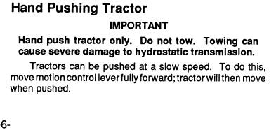

gwest_ca-(File Mod) 12,557 #4 Posted April 6 From 1995 operator manual 2 Share this post Link to post Share on other sites
nylyon-(Admin) 9,196 #5 Posted April 6 If I recall, the owners manual says push directional lever all the way forward, and hand push only. It may move slowly, then lock up. Just stop and wait a minute and push again, it can be a slow push. edit: Haha, he beat me to it, yeah that ^^ 1 Share this post Link to post Share on other sites

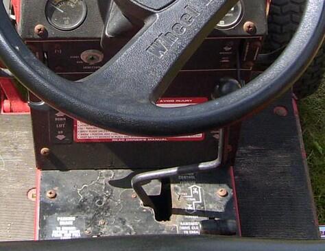

Bill D 3,213 #14 Posted April 7 Congratulations on that 314H! Great tractor. Love the bagger setup as well. Personally I hate the hydro controls on the column so I built foot pedals for all of mine. 2 Share this post Link to post Share on other sites
Ed Kennell 47,942 #15 Posted April 7 44 minutes ago, Bill D said: Personally I hate the hydro controls on the column so I built foot pedals for all of mine. 1 Share this post Link to post Share on other sites
cleat 9,448 #16 Posted April 7 1 hour ago, Bill D said: Congratulations on that 314H! Great tractor. Love the bagger setup as well. Personally I hate the hydro controls on the column so I built foot pedals for all of mine. I also second that. 1 Share this post Link to post Share on other sites

sqrlgtr 4,225 #20 Posted April 7 1 hour ago, Bill D said: Personally I hate the hydro controls on the column so I built foot pedals for all of mine. Guess I'm in the minority I just can't get comfortable with the foot control, but around here you have to be able to slide around on the seat to keep right side up . I can see the foot control being handy pushing with dozer blade or using front end loader though. BTW great score on the 314-H. 1 Share this post Link to post Share on other sites

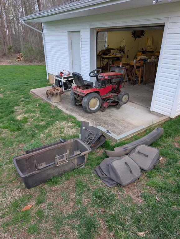

Mike'sHorseBarn 3,712 #21 Posted April 7 2 hours ago, Bill D said: Personally I hate the hydro controls on the column so I built foot pedals for all of mine. Honestly I don't mind the column hydro controls, when i was growing up my dad had the old red cub cadet's that had the column hydro's so I got used to it. 1 hour ago, WHX?? said: Let us know what it takes to get it running. Will do! Hopefully I can start digging into it tonight! 1 hour ago, 953 nut said: Looks like it was well cared for. Having been sitting for years all the oil has drained to the sumo as @Darb1964 said above. Good, it didn't run so I was a little nervous about the hydro pump. It seems like it was well cared for, the guy I got it from, it was his grandfather's and he bought it new. He passed away a few years ago and it sat since then. The battery has a 2020 date on it so it hasn't been sitting horribly long. He had a 1054, a 1075 and an 854 sitting there as well as a tub cart, but he didn't want to part with any of that lol I told him I didn't blame him. 3 Share this post Link to post Share on other sites
lynnmor 9,081 #22 Posted April 7 1 hour ago, sqrlgtr said: Guess I'm in the minority I just can't get comfortable with the foot control, but around here you have to be able to slide around on the seat to keep right side up . I can see the foot control being handy pushing with dozer blade or using front end loader though. BTW great score on the 314-H. I never could understand the need for a foot control, I have dozer blades, snowblowers and a loader and get by just fine with the hand control. I don't want a contraption taking up space on the running board getting in the way of my size 12W boots. I have a treadle pedal on my Kubota and it is a PITA, not because of my shoe size but the need to keep finding the D@!% thing. 1 1 Share this post Link to post Share on other sites

kpinnc 19,107 #25 Posted April 7 9 hours ago, sqrlgtr said: Guess I'm in the minority I just can't get comfortable with the foot control, but around here you have to be able to slide around on the seat to keep right side up Swapping in an older center console DCL is pretty easy. You just gotta find the parts. Just the handle, a spring, and a top plate. It is all bolt on to existing parts. 1 Share this post Link to post Share on other sites
