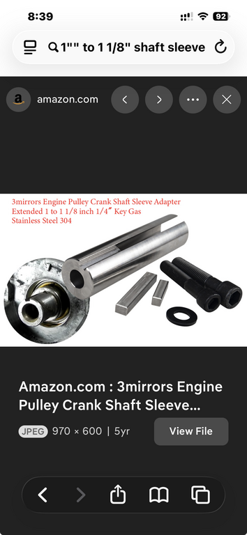

SylvanLakeWH 32,504 #3 Posted April 4 Yes... Something like this... I'd compare pulley cost to shaft sleeve cost... 1 Share this post Link to post Share on other sites

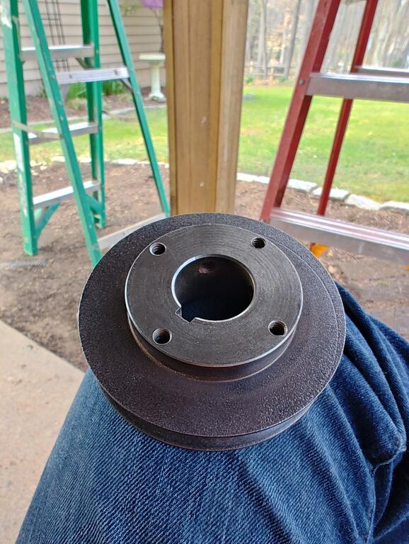

rmaynard 17,582 #6 Posted April 4 1 hour ago, JoeM said: Bob, I have a 1 inch WH engine pulley for a gear drive. I can send it to you. Might cost you a sandwich at the show. Let me know. JoeM This is the pulley we are replacing. PTO plate mounts on it. Share this post Link to post Share on other sites

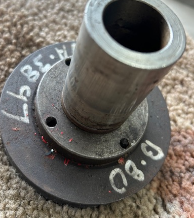

Racinbob 13,189 #7 Posted April 4 Yes. I sleeved the entire shaft on my reborn B-80. I had the pulley and pto bearing race for the 1.125" shaft so I found a sleeve that covered the entire shaft. I may have trimmed it to fit. The sleeve required the key to be 1/4" x 5/16" and a full length key was provided. 3 1 Share this post Link to post Share on other sites

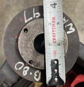

JoeM 10,267 #8 Posted April 4 5 hours ago, rmaynard said: This is the pulley we are replacing. PTO plate mounts on it. Looks like a 4 inch diameter. I'll be up at the shop in am, I can get some pics and I think I have the PTO sleeve also. Share this post Link to post Share on other sites

JoeM 10,267 #11 Posted April 5 This is the one I have 4" OD 1" ID and the PTO sleeve Send an address if you want them Share this post Link to post Share on other sites
