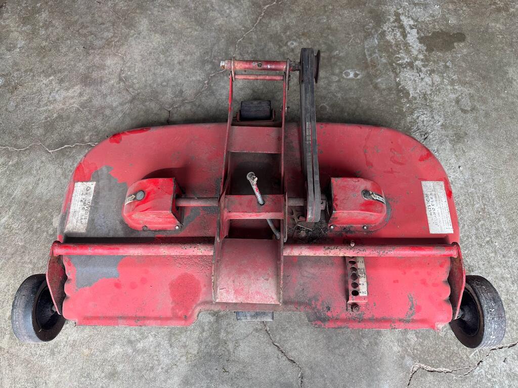

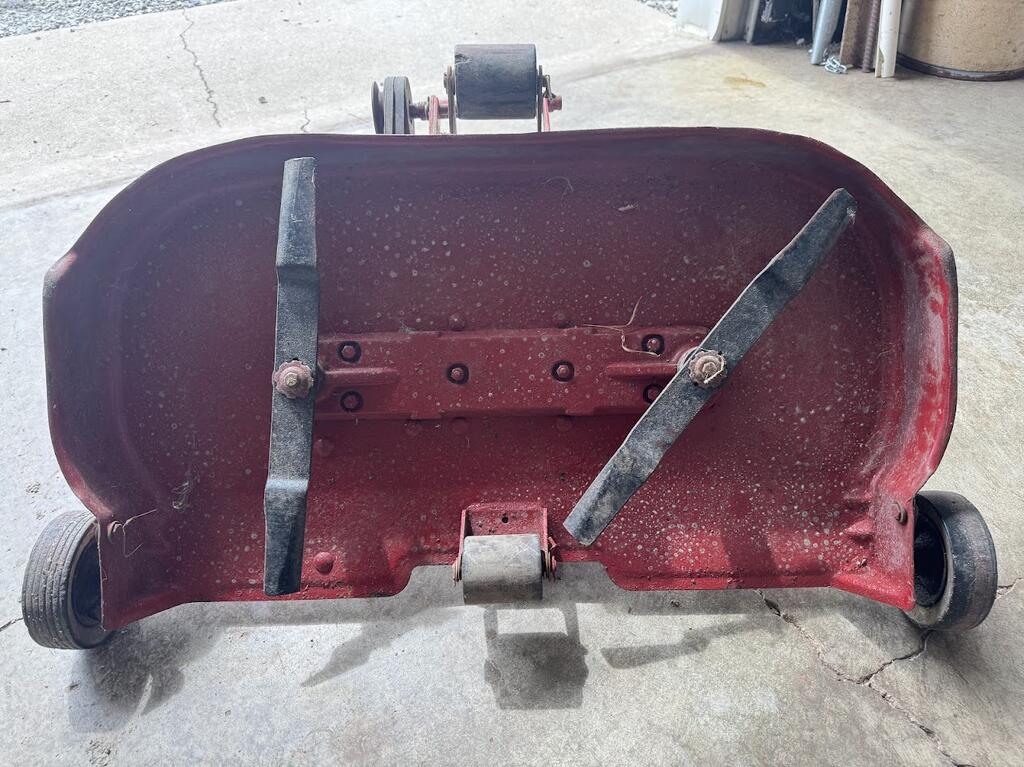

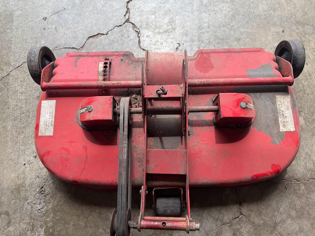

Bar Nuthin 3,038 #1 Posted April 2 My neighbor picked up this deck when he got his '69 Charger. We think it belongs on an older tractor. The drive pulley doesn't extend out far enough to line up with the PTO, or we're missing part of the idler setup. There's no tag to get a model number. Does anyone know what tractors this would fit and perhaps what a fair value is. It doesn't have any rust holes, and the blades appear to be in near new condition. Share this post Link to post Share on other sites
ri702bill 12,790 #2 Posted April 2 Looks to be about a 1965 to 68 short frame tractor style, 36 inch cut. Look up RM-366. I use the same on my 854. It appears to be in usable condition. I see the height adjustment knob is missing.... 1 Share this post Link to post Share on other sites
Bar Nuthin 3,038 #3 Posted April 2 57 minutes ago, ri702bill said: Looks to be about a 1965 to 68 short frame tractor style, 36 inch cut. Look up RM-366. I use the same on my 854. It appears to be in usable condition. I see the height adjustment knob is missing.... Thanks! We are fortunate enough to have a tractor graveyard near us with a pretty good Wheel Horse section. Perhaps my neighbor can find a useable height lever. Almost Heaven Lawn Mower Graveyard 1 Share this post Link to post Share on other sites
