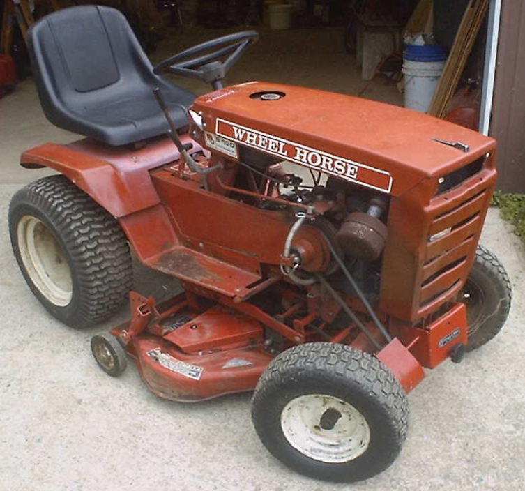

JoeM 10,120 #3 Posted April 2 this is a 75 with a newer deck, was my first WH bought it in the 80's used. 2 Share this post Link to post Share on other sites

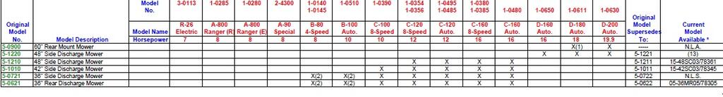

gwest_ca-(File Mod) 12,416 #4 Posted April 2 This is a list put together from the Attachment Interchange. It lists the deck (2) that replaced the original (1) and the deck that was available when the Interchange was created (4). What is missing are the decks (3) between (2) and (4). They are listed but you have to follow a deck year by year to find the others. Mower DNA 1972 model 5-0620 replaced by 1973-1974 model 5-0621 1975 model 5-0622 1976 model 65-36XR01 1977 model 75-36XR01 1977 model 75-36XR02 1978 model 85-36MR01 1979 model 95-36MR00 (Blades up to this point have the 5/8" x 3/4" double-D center hole unless the spindle has been upgraded) --------------------------------------------------------------------------------------------------------------------------------------------------------------------------- (These decks used blades with a 3/4" center hole) 1979 model 95-36MR01 replaced by 1980-1982 model 05-36MR01 - Last year for bearings with 3/4" ID 1983-84 model 05-36MR02 - First year for bearings with 17mm ID unless older spindles were updated. 1985 model 05-36MR03 1986-1990 model 05-36MR04 1991-1993 model 05-36MR05 1993-2006 model 78305 Note - 17mm is .669" 1 Share this post Link to post Share on other sites

Brockport Bill 2,448 #9 Posted April 2 10 hours ago, JoeM said: this is a 75 with a newer deck, was my first WH bought it in the 80's used. when you say "newer deck" -- that deck looks to me like a 80s era version of a 36 -- in the family of 05-36mr01, 02,03,04? yes ? 1 Share this post Link to post Share on other sites

JoeM 10,120 #11 Posted April 2 1 hour ago, Brockport Bill said: yes ? Yes the machine came with the deck on the front of the manual that I highlighted. in the later 80's I purchased a new deck and replaced the original one. the one in the pic is the newer 80's deck 1 Share this post Link to post Share on other sites
gwest_ca-(File Mod) 12,416 #12 Posted April 3 The right side of the attachment interchange list tells you what deck replaced the original deck and the current deck available when the interchange was created. The (2) footnote calls for a different belt. The list I posted includes all of them. 1 Share this post Link to post Share on other sites
Brockport Bill 2,448 #13 Posted April 3 1 hour ago, gwest_ca said: The right side of the attachment interchange list tells you what deck replaced the original deck and the current deck available when the interchange was created. The (2) footnote calls for a different belt. The list I posted includes all of them. thanks --forgot all about that end column being over there -- 2 Share this post Link to post Share on other sites
