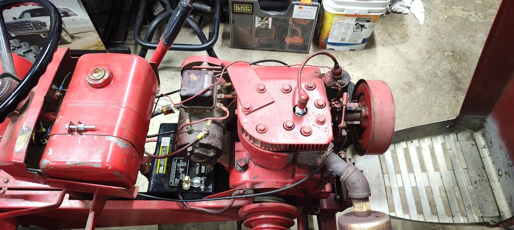

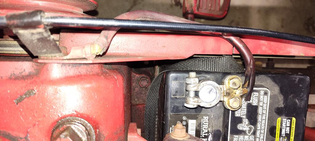

dsmreaper 12 #1 Posted March 30 So, I had to do some terminal work, basically I needed to install shims on the top post terminals as they were tight but still loose, any who, after I began I noticed the positive of the battery was hooked strait to the frame!!! Does that mean my tractor(67' 1077) is what they call a positive ground? Anyone have diagrams on this? Share this post Link to post Share on other sites

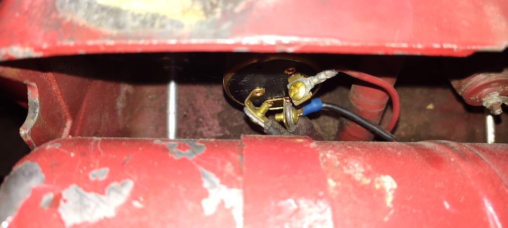

pfrederi 21,342 #3 Posted March 30 (edited) It is possible that some PO really messed up. But as long as he switched the wires to the coil and you have an S/G that gets polarized when you start it ... it may work. I know regulators are sometimes listed as + or - grd. but they still sometimes work.... Is the small + terminal on the coil hooked to the ignition switch or is it hooked to the points and condenser. Edited March 30 by pfrederi 1 Share this post Link to post Share on other sites
ranger 1,871 #4 Posted March 31 Has someone fitted a positive cable, which has a larger clamp, to the negative post on the battery? That could explain why it is loose? Assuming the battery has the conical posts of course? 3 Share this post Link to post Share on other sites

dsmreaper 12 #7 Posted April 1 Yeah not sure what is going on, the + on the coil goes to the ignition switch though. You can also see the POS on the battery clearly in the photo. Share this post Link to post Share on other sites
wallfish 20,744 #8 Posted April 1 (edited) Does it start and run like that? Can't imagine it would charge the battery Kinda looks like someone slid the battery in backwards and hooked'er up. Reversing the polarity I've never tried that, yet! LOL SG for Starter /Generator of which that engine has. Edited April 1 by wallfish 2 Share this post Link to post Share on other sites
dsmreaper 12 #10 Posted April 1 24 minutes ago, wallfish said: Does it start and run like that? Can't imagine it would charge the battery Kinda looks like someone slid the battery in backwards and hooked'er up. Reversing the polarity I've never tried that, yet! LOL SG for Starter /Generator of which that engine has. Oh okay, and yes it does start and run, I haven't check the charging system while running so I can't say for sure it charges.perhaps the older models and tech were so simple it didn't matter as long as there is voltage? I definitely had the thought the battery is in backwards though when I saw how close the terminals were to the S/G though. Share this post Link to post Share on other sites

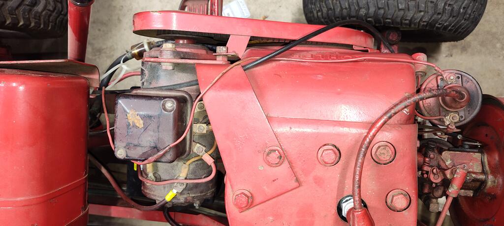

pfrederi 21,342 #13 Posted April 1 I have a couple old big tractors with positive ground and old school generators and the whole thing works great... but that your coil + is fed from the ignition switch is a question. I think (not sure) they will run with the coil reversed just not well. In your case I would switch back to a negative ground. After you do make sure have 12v at the small + on the coil when the ignition switch is in run. The S/G will polarize itself the first time you start it. Does your Generator red warning light work at all?? Also from your photo it is hard to see if your regulator is wired correctly. It is easy the terminals on the regulator are marked . The 3 you can see should be F field and that wire should go to the F terminal on the generator body. There is a B and that wire will go to the + on the battery (when you redo you r system). the L load goes to the cigar lighter. There is a hidden terminal on the bottom of the regulator it goes to the A terminal on the generator body along with the heavy wire already there. 2 Share this post Link to post Share on other sites

dsmreaper 12 #17 Posted April 2 43 minutes ago, pfrederi said: The light should come on the moment you turn the key to run. Not sure I understand how you tested to find out Positive is positive. Swap in another battery and wire it correctly (you can borrow it from another tractor or a car). + terminal to the heavy cable going to the ignition switch - terminal to the engine block. The light has never come on at all so probably not or isn't connected correctly. As far as the battery test, I used a multimeter and put red to red and black to black set to vdc, got a positive of almost 12 volts, when I reverse the probes red to neg and black to pos, it shows the same voltage as a negative, telling me the POS terminal is actually positive. 2 Share this post Link to post Share on other sites

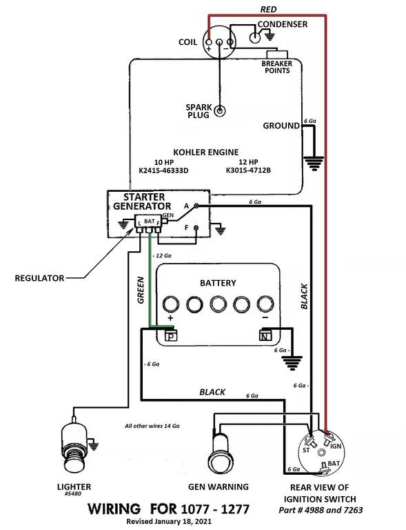

953 nut 70,651 #18 Posted April 3 Here is a simplified diagram of your electrical system and how the parts and pieces interact. 1 Share this post Link to post Share on other sites
dsmreaper 12 #19 Posted April 6 (edited) Okay, so I have a little update and a question. After asking my friend and coworker who gifted this tractor to be, about the battery connection. He told me that is how the previous owner had done it as that's the only way they could get the cables to reach(I do not believe they tried hard enough!!) and connect to the battery. He also stated that whatever was changed, wiring wise, was done by the same owner. So my question is this, what exactly would you change to make it run with a negative ground? I already checked the coil wires and such and they all seem correct, I will double check them with an appropriate wiring diagram with me next time. Also, I will add that upon closer inspection, all the diagrams posted here, have 4 connections it appears on the voltage regulator, mine only has 3. I have checked and double checked, and there is for sure only 3 terminals on it in total. Edited April 6 by dsmreaper Share this post Link to post Share on other sites

pfrederi 21,342 #22 Posted April 7 If you have only 3 terminals they will be F goes to Field terminal on the genny body, B or Bat goes to Battery +...A or Gen goes to A terminal on Genny body.. Having only 3 means it is not the original regulator...but 3 terminal ones work just fine. 1 Share this post Link to post Share on other sites
