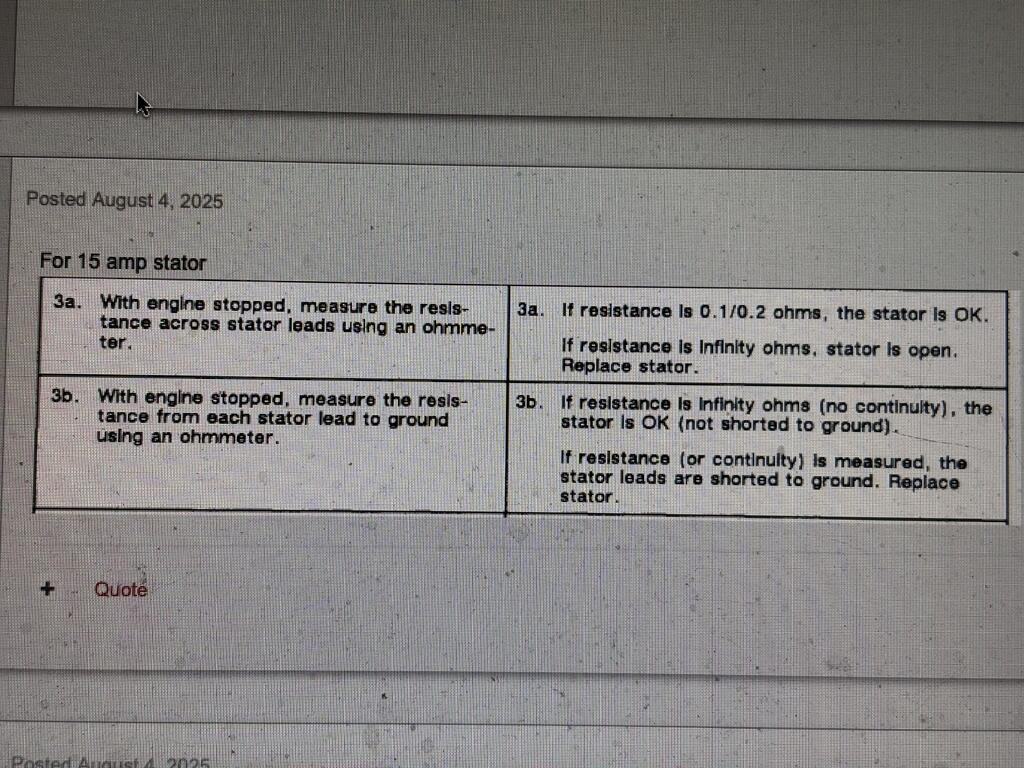

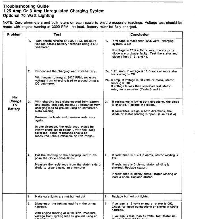

Railboy 13 #27 Posted April 22 pfrederi, is the below Kohler Stator Trouble Shooting Guide the one I need to go by and use for the Stator that is already on the Tractor? I am going to double check things, that is for sure. But yes, thank you for the help, so this is my next question for I am inquisitive to clear it up. The Diode as you said goes to the A Accessory White Wire Rectifier Input on the Ignition. Correct? This is on the Wiring Diagram. Kohler Stator Trouble Shooting Guide I found on the RedSquare Site, which I think is for mine??? Follows... Also, I can do the lead to lead test of the Stator, but have a question if it is accurate for grounding, for I see two winds tied together and anchored to the Green Plate with a flat-head screw on the Stator that is grounding I would think??? Why the question if the Trouble Shooting Guide is accurate for mine? This is the 3b. section. See, the Stator is grounded out to the block, which is to the chassis for test 3b and will fail it, Correct? And also, read that between the leads of the Stator, in one direction with a continuity meter it can have the .1-.2 Ohms. but in the opposed direction, not, the leads will show an "open" circuit? I think I have my thoughts comprehensible with that of the Stator Image and in contrast to the below Guide. Which to me is baffling regarding the "Chassis Grounding" test??? Share this post Link to post Share on other sites

Railboy 13 #29 Posted April 24 (edited) pfrederi, I am not certain of the Stator in the engine at this time, I have never seen it. But the Engine is on a 1987 Wheel Horse M10 Platform. So, in regards to that, are there any test I can do with the Engine Off, Engine/Tractor Connector Disconnected and I can do test with the Engine Connector to the Stator? See, that way I can also test out the new Stator I have. And if there is an I.D. method there, we will know for sure what Stator I have in the Engine Currently. But here you go. During the Engine Start, I blow the 15 amp. fuse. So, I am not sure of how to conduct the Guide that is above Test's? Why I am looking for an Engine Off, and Disconnected Engine Connector Test Guide? Thank you for your help, and hope you are having a good day, and everyone, thank you for helping. Note- Bet the Stator Leads got reversed.... Why I like to test with Engine Off, at the Connector the Stator Leads again to see if it is fried? But also, can do as I said above, test the new stator for certainty that it is fine before install. Yea I am currently using the tractor, grass season is here. Edited April 24 by Railboy Share this post Link to post Share on other sites
pfrederi 21,342 #30 Posted April 24 Since the engine runs after the fuse blows you can do the tests above. You can test your new stator #3 and # 4 Use the metal ring of the stator as the ground. Share this post Link to post Share on other sites
