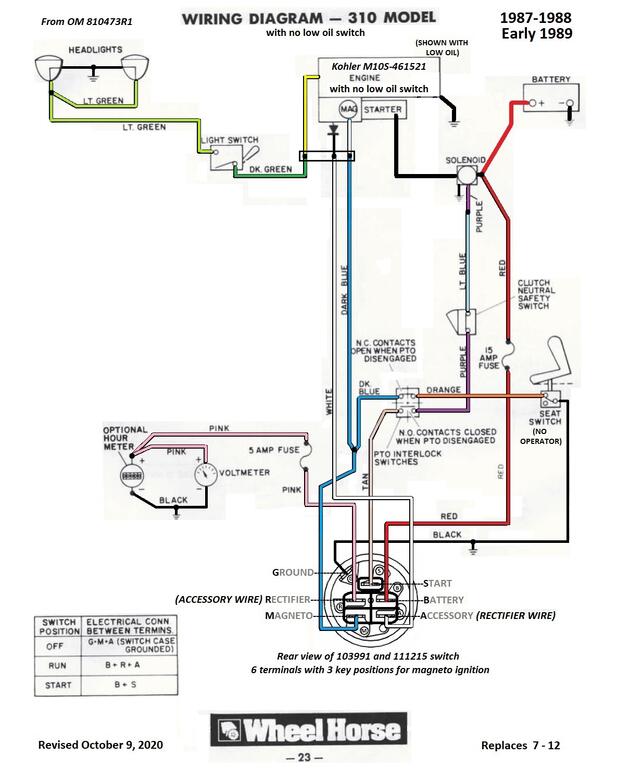

Railboy 13 #1 Posted March 30 (edited) Hello and yes, another thread under Electrical. I did get the Wheel Horse out today and grass cut, but of course if you know that I have been working on it, I have been studying the Electrical Diagrams of a 1987 Wheel Horse 310-8. Here is my question, which wire on the diagram "Charges the Battery? Dark Blue Wire or Tan Wire? I am looking for a voltage regulator or rectifier of some sort and want to collaborate what the diagram says, that is the ignition has a rectifier built in? I have read this on the net and the net says the ignition has a built in rectifier in it, so wanting to confirm mine. Why, if the ignition switch has a rectifier, I will not over charge the battery. Is this true? Or is there a component I am missing that needs a wire for charging the battery and this is in the diagram and I am over looking it or a wire? And yes, some work has or will be having done to the electrical, I just want to have everything in mind taken care of before I dive iny. And yes, over-charging the battery is a concern if the other work plays out correct, illuminating a short-circuit, which I will do continuity checks to find out about. Thank you for your help. Edited March 30 by Railboy Share this post Link to post Share on other sites
gwest_ca-(File Mod) 12,320 #2 Posted March 30 The white wire charges the battery through the ignition switch. The diode is on the Kohler side of the connector. Feel the wire for a small lump that is likely taped over - that is the diode rectifier. No regulator because in theory the stator will not put out enough current to overcharge a battery but we have seen it happen. Keep an eye on the voltmeter. Share this post Link to post Share on other sites
wallfish 20,147 #3 Posted March 30 I believe it's the white wire from the engine. A 3 amp charge circuit does NOT have an external regulator/rectifier. That Magnum engine uses a diode in the wire to achieve the rectifier from AC to DC. The key switch doesn't have ANY circuitry in it, just contacts to direct current and ground. A rectifier - converts the AC current produced by the stator into DC current A regulator - regulates the current for charging a battery to prevent over charging The ignition circuit has nothing to do with the charging circuit and vise versa Starting circuit has nothing to to with either Consider them 3 independent circuits that run through 1 common key switch. 3 3 Share this post Link to post Share on other sites

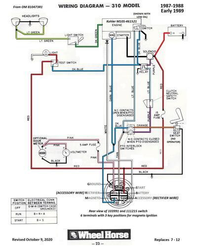

Railboy 13 #4 Posted March 30 Ok guys, thank you for the answers. I have been worried that in doing the following if you have not seen my other "Electrical" thread already this is what I am up to. This post I have a feeling may be a little long... I had the engine rebuilt over the winter, and in doing so the "Oil Sender" was taken out do to it is made of plastic and could break causing internal engine damage. Ok, I know I have said it and repeating it now, but for the new people, since I do not have the Oil Sender nor its Positive Circuit of the Dark Blue Wire Connected to the Light Blue Wire, is to mimic the Oil Sender by putting in a Jumper Wire. This jumper wire as I was told to do will be connecting the Purple at the Solenoid to the Light Blue Wire, which the Light Blue Wire ties into the Tan Wire to the ignition. So, have this question, if I am by-passing the Dark Blue Wire, am I getting rid of a circuit that does anything? Why I am into this post's descriptions. See, I do not have the relay that the Orange, Purple, Dark Blue, or Tan Wires run into. It was taken out by a previous owner and I do not have a seat switch, which I guess is why the relay was taken out. Also, the Clutch and PTO now tie into the only relay I have, the Short Purple Wire Relay. But to wrap this up, I was told when I do put the Jumper Wire in between the Purple Wire and Light Blue Wire, to take out the Relay the Short Purple Wire goes to from the Solenoid, for it is by-passed. So, that is why I have the question now of the Dark Blue, with no relays and the Dark Blue Wire omitted from the tractor, is this ok as long as my continuity checks of the 15 Amp. Fuse Red Wire Check out against the chassis(-)? I have been blowing the 15 Amp. Fuse, and the tractor starts when the fuse blows(do to grounding), but, you have to replace the 15 amp. fuse every time when starting. And this development started once the engine was put back in, with out the Oil Sender. So, does the Jumper work out for ya'll and I will keep my "Normal" charging System Operational of the Battery? And do not worry about the Dark Blue Wire? Also, On the Kohler side of the connector, I have a Black, Yellow and White Wire. The Blue's, the light blue and dark blue wires were cut off at the oil sender and prongs removed from the Kolher's Side of the Connector. So more or less the question, do I need to do anything with the Dark Blue Wire to repeat myself or just over-look it when I do the jumper of Purple and Light Blue? Sorry for the rambling, what I stated makes since to me, but I am a Newbie at Wheel Horse Electrical Diagrams, and plus taken direction for the Wheel Horse did great all last year's grass season, just drank oil but since putting the engine back on with out the Oil Sender and no wires from it, this has been taken place and how to fix it has been pointed out to me. And thank y'all for the advise, I have yet to have anything melt, there are no pinched wires or chaffed wires, but getting a ground to the 15 amp. fuse red wire and trying to illuminate it with out upsetting the tractor. And to pass it along, I did find a ground at the relay, at the short purple wire. Oh, after rereading this post, I do have a last question about the Stator and Magneto. When I do a continuity check between the 15 amp. fuse Red Wire, can it ground out continuity wise with either the stator and magneto with no cables to the battery? I do not know much on how stators and magnetos are wired. Thank you for your help, sorry for the long post. Just trying to get my chores layed out before me before diving in on how to go about solving the above. 1 Share this post Link to post Share on other sites

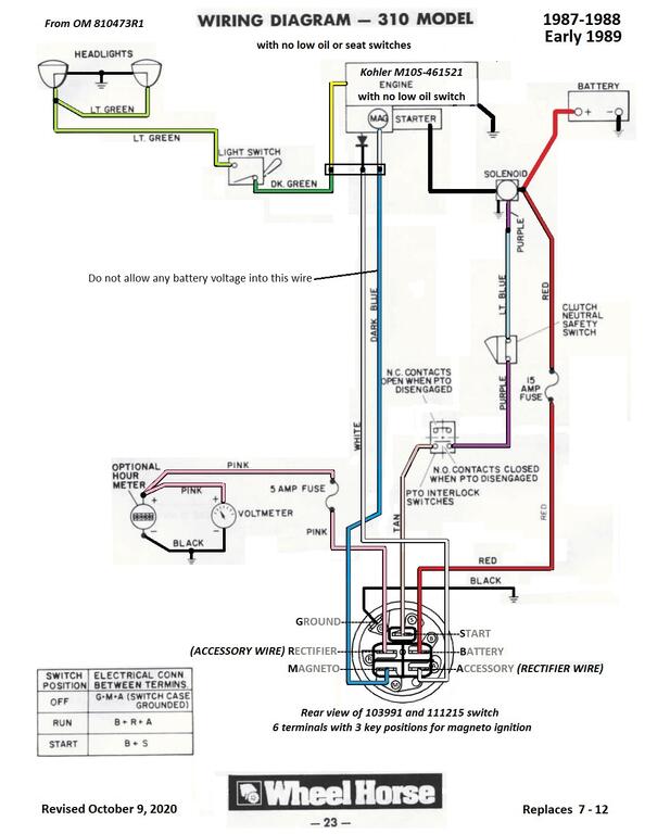

gwest_ca-(File Mod) 12,320 #5 Posted March 30 Compare the wiring diagram above to this one. The dark blue wire to the oil lamp has been removed along with the battery power red to the low oil light. Magnetos are self-powered. The ignition wire simply grounds the magneto to shut it off. Do not allow any battery voltage to get to that ignition wire. It will release the magneto magic smoke. 1 Share this post Link to post Share on other sites
Railboy 13 #6 Posted March 30 So is it recommended to tie the Light Blue and Purple Wire that run into the relay with the Dark Blue and Ground, there, tie those together at the connector of the relay? Also, I was told to dispose of the relay there, correct? Thing is I am not sure if I need to worry of the Dark Blue Wire? And yes, see them on the diagram for both Oil Sender and Magneto, this is the full diagram. Also, don't forget of the other relay I am already missing. On the up and up, I am going to have to do continuity checks on wires if it is more than that for my wires are all painted or something. I have blues( Dark and Light) for the oil sender, but have an additional blue that turns black and a green that turns black at the tractor side of the engine connector. The engine side of the connector is White on top, with Yellow and Black(Painted or Something) below it on the engine side. I don't mind taken the time to do continuity checks on wires to make sure I have a complete wire, but today as of right now is a wash for me to work on it. I have to open up a 10X12 Shed to get to the Tractor and have light and its raining, and I am not sure what the day may hold. I do continuity checks by using Stick Pins through the Shieldings. 1 Share this post Link to post Share on other sites

Railboy 13 #12 Posted March 30 @pfrederi, well here it goes. I was told that wires on the diagram are positive, unless the negative symbol is at an end point. Like, on the only relay I have, the one with the Light Blue, Purple, Dark Blue and the Black has the Symbol to terminate into the chassis(Ground). This is illistatrated, Also, this is the relay that the Purple runs or you can say is a short wire and connects to the Solenoid. That Black has the symbol of ground. This is the illustration I want to point out of the Positive's and Negative Wires in how I was told, and also the Purple Wire I want to pick-up. So, what I am preposing is this. For, I was told that the Dark Blue and Light Blue at the Engine/Tractor Connector of the Oil Sender are Positive. And when actuated, the oil sender, it throws in a negative(ground) for no starts or low oil light, when you have low oil or no oil. True? If so, what I have now is a broken circuit do to the Oil Sender and wiring is gone, So, Connect the Purple Wire from the 1/4" Nut Post of the Solenoid to "Both" of the Light Blue and Dark Blue at the tractor side of the Engine/Tractor Connector. These are easy to find, and this way I am mimicking the Oil Sender for the Light Blue and Dark Blue will be Positive there. True? Then this coencides with mimicking the missing relay and what the previous owner did already, and also I can take out my last relay, and I do not have to touch anymore wiring for the relay is gone like the relay the seat switch went to, but the Tractor will be back to normal like last season, the Wires, Light Blue and Dark Blue are Positive at the Tractor Side of the engine connector. And like above, mimicking the Oil Switch. No more work for there is not a ground of the relay as I illustrated, it will be illuminated. I then can do my continuity checks to see what's up from 15 amp. fuse to what ever. And if there is an issue, be back, lol.. What through me is that the Dark Blue Wire is used for a couple things, and keeping this basic as I can, this is what I came up with. And so you know, the battery cables will be off, both of them. Not that you just need one, just can't afford to fry anything, parts are hard to come by. Items are being discontinued in making all of the time I am learning. Share this post Link to post Share on other sites

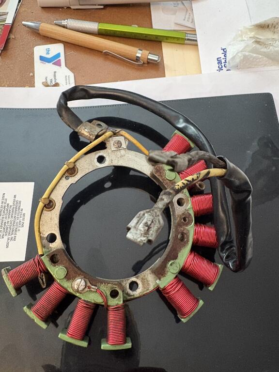

Railboy 13 #25 Posted April 22 It looks like my other thread on chasing this issue down regarding the Stator-Diode has come to a halt. So, I am looking for a two basic answers from some experienced ears and eyes on these two topics. One topic, is the Stator below that I have to install, does it look like a Stator for an 1987 Kohler M10 with Magneto and has the internal Diode in the Stator's wiring harness, its own rectifier diode if it is called that? I do plan on cutting back the sheathing to get the wires right, for the image shows multiple colors. And you will see in the photo, the colors are not clear of the wires. This is in correspondence of the wiring diagram. I have to see if the white/yellow wire is diode and black is continuous, unsure right now? And also the last question that File Mod and wallfish hit on, the Diode Side Wire of the Stator ties into the White Wire of the Tractors Side of the engine connector and goes to the "Rectifier" Side of the Ignition, as the Wiring Diagram says? I am looking to take my Ohm meter to continuity check it out to make sure? See, I am taking a guess at this, but makes since, but see, it must be my dyslexia that is messing with me, for ya'll have called the Diode Side of the Stator the Charging Circuit, and the only thing I figure is ya'll are regarding it as the White Wire, Rectifier Connector on the Ignition, and it charges the battery. And the last wire of the two wires of the Stator goes to the other prong, side by side, the Headlight circuit I guess? My Stator to put in, I have to swap the connectors female to male to go into the connector yet. But so you know, I have never done this operation, so making sure or things when I dive in. Thank ya'll for the help. Oh, by the way, I have a new Ignition to put on, and I just hope it is the correct one to install. The vender said it was for a Magneto Kohler M10 Engine style. Share this post Link to post Share on other sites
