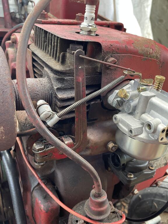

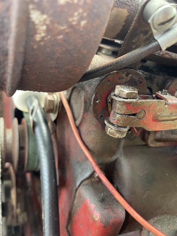

FLtractor 223 #1 Posted March 28 Afternoon, I started a whole thread on this last year but am now in a rush against the rain and can’t find the exact post that someone told me where to attach the throttle cable to the frame to then properly attach it to the governer wheel.. previous owner attached it by bypassing the governer to the carb.. which bolt would be best to attach on frame? So I can get proper tension to the left most governer wheel hole? Pictures would be most helpful. Share this post Link to post Share on other sites

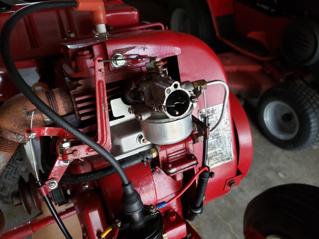

Racinbob 13,192 #2 Posted March 28 I did this so I had a longer throttle lever throw. 3 Share this post Link to post Share on other sites
FLtractor 223 #3 Posted March 28 1 hour ago, Racinbob said: I did this so I had a longer throttle lever throw. To understand what you did.. did you rotate the metal governor wheel so the metal arm protruding from it is in the position of yours.. where you secured the throttle cable to? Also if that’s exactly what you did, how does the metal protruding arm stay where it is In your photo. Thank you for prompt reply Share this post Link to post Share on other sites
Lee1977 7,772 #4 Posted March 28 The arm where cable is attached is tighten behind the the governor bushing. The arm also controls max RPM of the engine. 2 Share this post Link to post Share on other sites

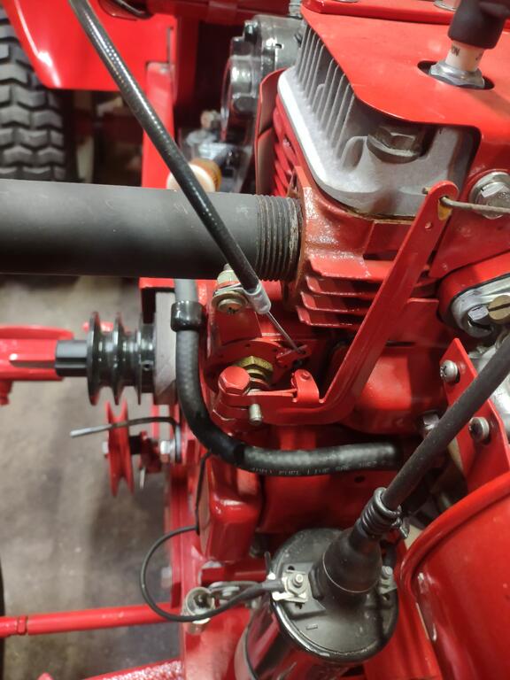

Achto 32,704 #5 Posted March 29 (edited) 7 hours ago, FLtractor said: Pictures would be most helpful. Factory routing for small block Kohler models. This is on my 867, yours should be th same. Edited March 29 by Achto 1 1 Share this post Link to post Share on other sites
FLtractor 223 #6 Posted March 29 47 minutes ago, Achto said: Factory routing for small block Kohler models. This is on my 867, yours should be th same. Oh I see now.. your cable is attached on the same governor wheel lever.. difference I see is mine is in front of lever .. yours is behind.. so I need to move mine as yours is.. and move the cable further up the clip so it’s holding tension right near the metal exposed piece so it holds tension on the governor wheel. Did I get all that correct? 1 Share this post Link to post Share on other sites
FLtractor 223 #7 Posted March 29 (edited) 2 hours ago, Lee1977 said: The arm where cable is attached is tighten behind the the governor bushing. The arm also controls max RPM of the engine. After looking at acto picture and reading this reply of yours, that makes sense.. someone once sent me the Kohler 181 digital manual so i can properly set the governor timing .. I need to find that link again so i don’t blow up the engine with too much rpm Edited March 29 by FLtractor 2 Share this post Link to post Share on other sites
