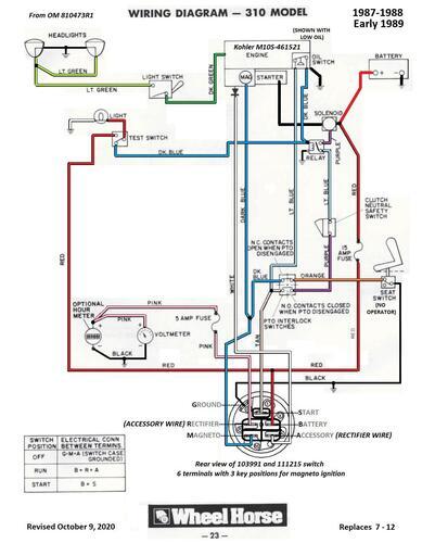

Railboy 13 #1 Posted March 26 (edited) Hello, I was advised to start a New Thread here at "Wheel Horse Electrical" for my 1987 Wheel Horse 310-8 Model #211OK04 on my blowing a 15 amp. fuse situation. I am Blowing the 15 amp. fuse that is part of the Charging Circuit at time of Start-Up but the Tractor Runs on its Magneto fine, but the Stator for it has that as well, is not charging do to the Blown Fuse that is part of that circuit and the Voltmeter stays at 8 Volts bottomed out when the engine is running. I am getting continuity between the 15 amp. fuse Circuit and Chassis. Also, been told I need to put in a Jumper Wire to Mimic that the Oil Sender is in the Engine, but was taken out at time of Rebuild over the winter do to the Oil Sender is made of Plastic and can break causing internal Engine Damage. The engine ran fine all last year's grass season but drank oil like big time. Why the rebuild... So, below is my wiring diagram for the Tractor and please follow for I have not melted any wires or shortened anything out, it is that I am and want to be verified on what I am doing in that I have learned through the forums being a Newbie, that the diagram show all wires as "Positive" unless the Negative Symbol is illustrated. So, this is what I have been told to do under my original post at "Wheel Horse Tractors" when I was identifying my Tractor and learning at first on what to do on the Fuse? Here is the diagram to follow: And I was told to do this... Simply go to the Solenoid's 1/4" Nut Wiring Post were the Purple Wire Picks up, then Tie that into the Light Blue Wire by-passing all the relays to have power to the ignition. This way I am mimicking the Oil Sender existence and have power looped to the ignition completing the charging circuit at the same time, and by-passing all the relays and there Safety Switches. This will illuminate my grounding for the relay after my Solenoid is grounded out to the chassis at its mounting point(bolted). I do not have the Relay that the Tan Wire ties into, the what I call, the Seat/Clutch Relay. Also the Clutch Safety Switch on my tractor currently from what I gathered looking at the tractor, the Clutch Safety Switch goes to the only relay I have, after the Solenoid. Which now, I will be connecting the Purple to Light Blue Wire going to the ignition I have totally illuminated all electrical Safety Switches do to relays are yanked out for there by-passed because the Purple Wire and Light Blue Wires are tied together? So in theory is this, I will have no relays to worry about grounding out anything and all wiring is Positively charged at time of Running. And in doing so, the 15 amp. fuse should hold? This is do to that there is no more grounding points for the 15 amp. fuse as I follow the diagram is what I gather and reading the electrical diagram correctly? Thank ya'll for your time. I am a Newbie, and the Tractor cut grass with no issues all last year. But since putting the engine back in with out the Oil Sender, the Fuse issue has been a pain to deal with. I have been in a crash course on the Wheel Horse's Diagrams and Learning Curve. But thanks to ya'll, I think I know what I have stated here and all makes since and past directions from other members are working out, I should not fry anything if this thread is accurate and I am following the diagram correctly???? One last thing to add, the reason for the Jumper Wire is to mimic power going through the Oil Sender, and when the Oil Sender reads low oil or no oil it passes along a negative pole. So this is why I need the jumper, for currently I have an open but yet dead circuit, nothing going into it what so ever? Thank you, maybe the Electrical Peeps are out there, and can correct or give me some feedback before I go to work on the tractor. I do have a little time, as I said the tractor runs currently, just not charging, and it will be a few days before I need to use it. Edited March 26 by Railboy Share this post Link to post Share on other sites

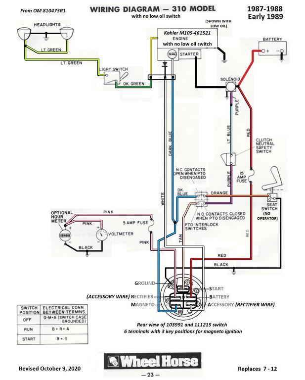

gwest_ca-(File Mod) 12,320 #2 Posted March 26 Here is a diagram modified to suit your application with no low oil switch. 1 Share this post Link to post Share on other sites
Railboy 13 #3 Posted March 26 (edited) So do this diagram and it involves the "Clutch Neutral Safety Switch" Relay? Thing is, I do not have that relay already. When the Electrical Seat Safety Switch was taken out, I guess they got rid of that relay for the "Clutch Neutral Safety Switch" now ties into my only Relay I have, the one after the Solenoid. And this Relay will be taken out during the Jumper Wire By-Pass of the Purple Wire and Light Blue? Totally even getting rid of the use and possible activation of the "Clutch Neutral Safety Switch" interaction? Thank you for your response and diagram. Just looks like I am going to tie together the Purple Wire after the Solenoid and Light Blue Wire at the Connector of the engine. This is where my "Jumper" will be. Edited March 26 by Railboy Share this post Link to post Share on other sites
gwest_ca-(File Mod) 12,320 #4 Posted March 26 You do not have any relays left - you removed the only relay the tractor ever had. The solenoid is a type of relay but it is not called that. The clutch neutral safety switch is just that a switch. Clutch pedal down the switch closes and powers the solenoid providing it gets power from the pto start switch with the pto off. I think your thinking is backwards. Power goes from the solenoid battery cable side to the fuse to the ignition switch. It is the ignition switch that sends power to the pto switches, clutch switch and on to the solenoid. The solenoid is mounted to the chassis sheet metal so that mounting grounds the solenoid. Power in on the small solenoid terminal actives the solenoid. The starter motor should then run. Make sure you connect the correct light blue wire to the purple. Needs to be the blue wire coming from the clutch switch. The diagrams call the clutch switch a neutral clutch switch and here is why. In reality the clutch switch is used on models with a gear transmission. The clutch pedal must be down for the switch to close. In reality the neutral switch is used on models with a hydro transmission. The motion control must be in neutral for the switch to close. I do not know what you are calling a relay. There is nothing but switches on the revised diagram. Share this post Link to post Share on other sites
Railboy 13 #5 Posted March 26 The Purple Wire runs to a relay. And the Orange Wire runs to a relay. When I by-pass with a jumper from Purple to Light Blue I will have a complete circuit. If I have this correct? Thing here is I am by-passing the Orange Wire's Relay for the Light Blue Ties into the Tan Wire to the Ignition. True? And then I have no more relays for all of them are by-passed? Share this post Link to post Share on other sites
gwest_ca-(File Mod) 12,320 #6 Posted March 26 Look at the diagram. Where do you see a relay? A relay is a device that acts as an electromagnetic switch to control circuits. Share this post Link to post Share on other sites
Railboy 13 #7 Posted March 26 (edited) I mentioned it. The Relay's on my tractor are like the Relays on a Saab, and other cars ect. There the little black boxes 1.25"X1.25"X1.25' Box Squares that have connectors plugged into them.. There is one at the Orange Wire tying in, and One at the Purple Wire Tying in. This is on the diagram. I am not talking of the Starter Solenoid. Edited March 26 by Railboy Share this post Link to post Share on other sites

gwest_ca-(File Mod) 12,320 #9 Posted March 27 I would get rid of the relays as you do not need them. They and the extra wiring are just complicating a simple system. Make sure the back of your ignition switch matches the one on the diagram for the number of terminals and terminal identifier location. These switches all look alike but differ in the way they function. Some have identifying letters on the back plate next to the terminal and others have the identifying letters on each terminal. The 1+2+2 cavities in the rear switch connector body should help you identify the circuits by wire color without removing the connector from the switch. Let us know what you find. Share this post Link to post Share on other sites

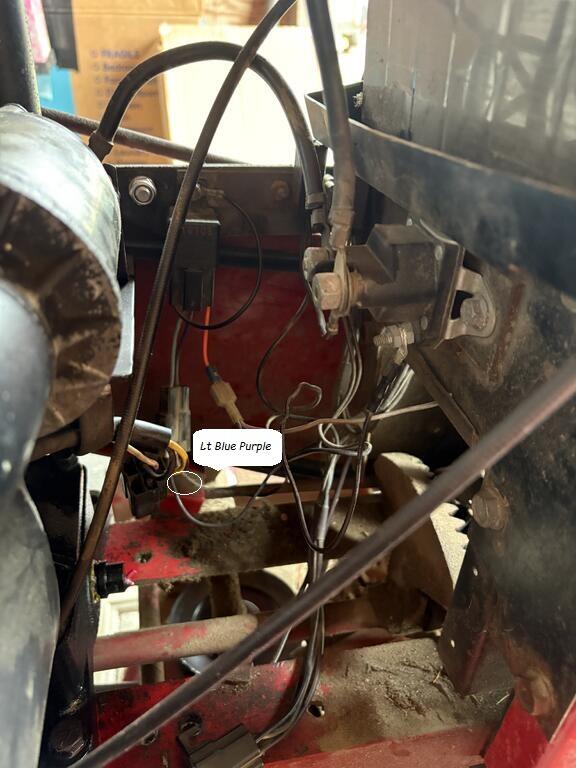

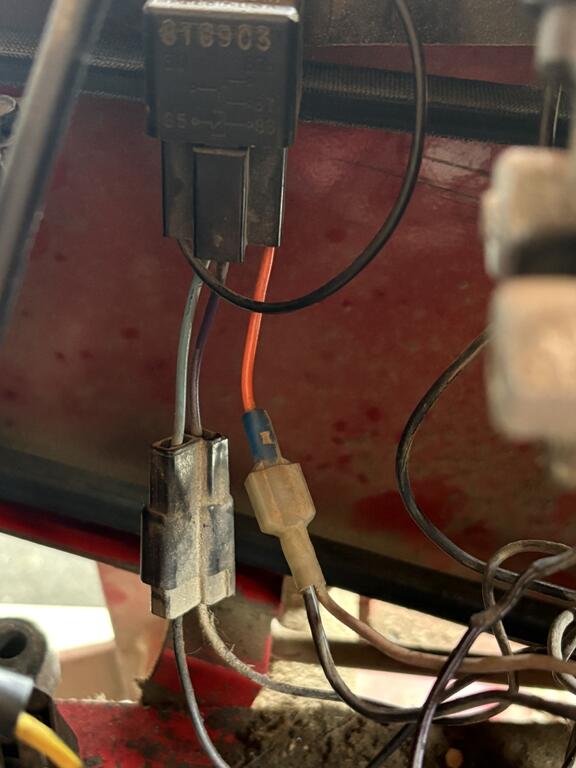

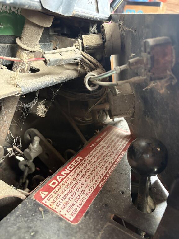

Railboy 13 #12 Posted March 27 As you will see, the wires got painted in the past. I do continuity checks on them to make sure I stay sure of the wires I am working on. But yes, there is only one relay, none hidden, why I took the photos behind the dash, but yes, she is a bit dusty, just the way it is. I am trying not to move to much around. 40 year old wires really do not like shifting there state of being, as in situated. Share this post Link to post Share on other sites

953 nut 67,194 #17 Posted March 30 Hello Mr. 953 nut, I have a question and it may be a basic answer for you. I have yet to do any wire work on the tractor, but pulled the dash and found out if you have been following my electrical threads as you mentioned to post, there is only one relay left in my tractor right now. Ok, you said to connect the Short Purple Wire of the Solenoid to the Light Blue Wire, which if works will solve my problem. And thank you for that. So this is it, do I pick up the Light Blue at the Relay with the Purple or go to the engine connector where as that light blue for sure goes to the Tan Wire then Ignition. Why I ask this, is that do to my modified electrical by the previous owner, I am not sure what up. But you said after the "Jumper" was put in, take the last relay out. I am thinking if you agree, at the connector run the jumper to the Light Blue, not the relay Light Blue after the Solenoid. Thank you for your time. Please ask all questions on the forum rather than via PM so you can have more input. Looking at the pictures of your wiring it is obvious that someone got in there and made a few changes before you. Not knowing where the wires are coming from or where they go after they leave the photo we may want to just add a new fuse holder with a 15 amp fuse and run it to the ignition switch. In your picture the Purple and Light Blue wires are circled, they need to be connected to each-other, not to anything else. Share this post Link to post Share on other sites
Railboy 13 #18 Posted March 31 (edited) @953 nut, thank you for working with me for you know where I am. So, to get this right which you have said is connect the light blue wire and purple wire here in the circle at the relay as in my image. The only relay I have. Then take out the relay. I know we are on the same topic for the up-tenth time. But wondered or the engine connector's Light Blue of the Oil Sender's Lead? But yet, you answered the question. Thing is this why I am hung up on the or which Light Blue to pick up? And this is what I think you know or see in the diagrams, is that if I go by the Light Blue Wire at the Relay, it runs into the Long Purple Wire and when they in the past did the wiring removing the relay and seat switch, they tied the Long Purple Wire into either the Light Blue from the Oil Switch or Tan Wire? Correct? And why you want me to pick up the Short Light Blue at the Relay with the Short Purple of the Solenoid? Ok, have this question that goes with it, the above. When doing this, the Purple will Electrify the Light Blue Wire and by-pass "ALL" safety switches as well? Correct? Thank you for getting back to me. And yes, my wiring is kinda a mess do to previous work in the tractor's past. But you know I am missing the other relay and its original wiring, why I like to by-pass all the safety switches, even though I have the PTO and Clutch Safety's, but want to by-pass. And one statement, when I am doing my continuity checks on the Solenoid Side of the Positive Fuse Side with out a fuse in the tractor, do I disconnect the Engine/Tractor connector? Why I ask is I do not know if the engine components as in the Magneto and Stater have grounds to the engine's block? And I know I am taking out the relay that is in the image thus getting rid of the ground you see is mounted with ground. Yea, I wish I was the wiring guy of my youth, and had everything to do it, but, I have a feeling I would screw up somehow in doing it. Plus need to the tractor for grass season is here. Edited March 31 by Railboy Share this post Link to post Share on other sites
953 nut 67,194 #19 Posted March 31 1 hour ago, Railboy said: @953 nut, thank you for working with me for you know where I am. So, to get this right which you have said is connect the light blue wire and purple wire here in the circle at the relay as in my image. The only relay I have. Then take out the relay. I know we are on the same topic for the up-tenth time. But wondered or the engine connector's Light Blue of the Oil Sender's Lead? But yet, you answered the question. Thing is this why I am hung up on the or which Light Blue to pick up? And this is what I think you know or see in the diagrams, is that if I go by the Light Blue Wire at the Relay, it runs into the Long Purple Wire and when they in the past did the wiring removing the relay and seat switch, they tied the Long Purple Wire into either the Light Blue from the Oil Switch or Tan Wire? Correct? And why you want me to pick up the Short Light Blue at the Relay with the Short Purple of the Solenoid? ? Ok, have this question that goes with it, the above. When doing this, the Purple will Electrify the Light Blue Wire and by-pass "ALL" safety switches as well? Correct? We never recommend bypassing any safety switch. Thank you for getting back to me. And yes, my wiring is kinda a mess do to previous work in the tractor's past. But you know I am missing the other relay and its original wiring, why I like to by-pass all the safety switches, even though I have the PTO and Clutch Safety's, but want to by-pass. We never recommend bypassing any safety switch. And one statement, when I am doing my continuity checks on the Solenoid Side of the Positive Fuse Side with out a fuse in the tractor, do I disconnect the Engine/Tractor connector? Why I ask is I do not know if the engine components as in the Magneto and Stater have grounds to the engine's block? And I know I am taking out the relay that is in the image thus getting rid of the ground you see is mounted with ground. Yea, I wish I was the wiring guy of my youth, and had everything to do it, but, I have a feeling I would screw up somehow in doing it. Plus need to the tractor for grass season is here. Below is a simplified drawing of a magneto wiring system that may help you understand how the components work together. It is for the standard 15 amp charging system, not the 3 amp system with AC for lighting. Just concentrate on the B, M, and S terminals of the ignition switch. This is not a Wheel Horse wiring diagram, it is only intended to show you how the systems work in harmony and are connected through the ignition switch. The ignition switch is the same 103 991 switch you have now. Your lights will be powered from the same wire they are on now. Your charging system will be attached to the same R terminal but you don't have a voltage regulator as shown in the diagram. Your volt meter and hour meter will be connected to the A terminal of the ignition switch. If you are unable to deal with this you may want to reach out to someone local that understands wiring and seek assistance from them. Share this post Link to post Share on other sites
