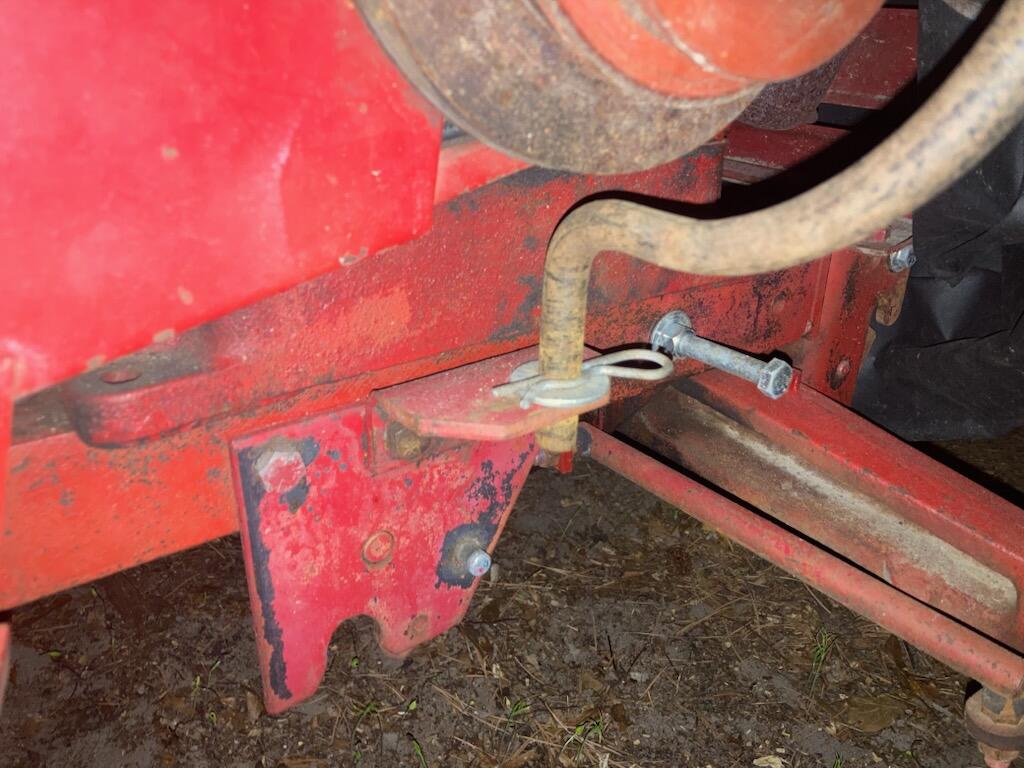

pfrederi 20,991 #6 Posted March 25 You will have to remove the shakerplate set up and make a lower mount for the PTO hoop. If the K321 oil pan isn't drilled and tapped for bolts on the PTO side you may have to use J hooks. 4 Share this post Link to post Share on other sites

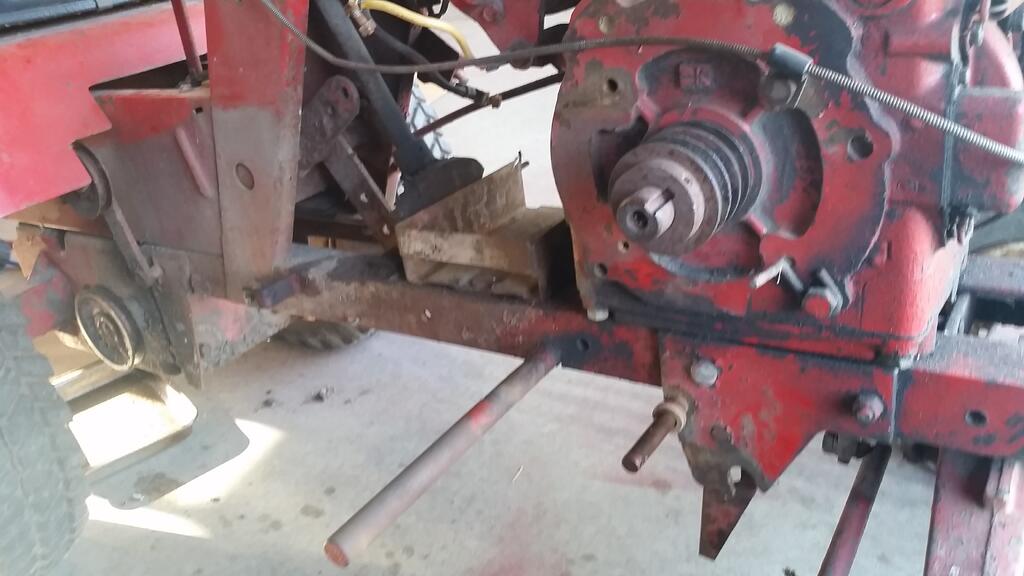

WHX?? 57,628 #15 Posted March 28 1 hour ago, Joshyg said: seem like a dumb question Only dumb question is one that doesn't get asked. Our bad for perhaps talking over your head. Early and some late horses they did bolt a AS it directly to the frame. Later models it was deemed to make them more vibration pleasing so they came up with isolation mounts and came up with different designs to do such. You'll see this in many other brands as well. Some K models were even adapted or designed to get a AS model under a short hood where frame to hood clearance was at a premium. As such as what we call a big block in a short frame. This is an example of a AS model directly mounted on the frame. If this doesn't clear things up for you Josh ask away. We are here to help you learn. 1 Share this post Link to post Share on other sites

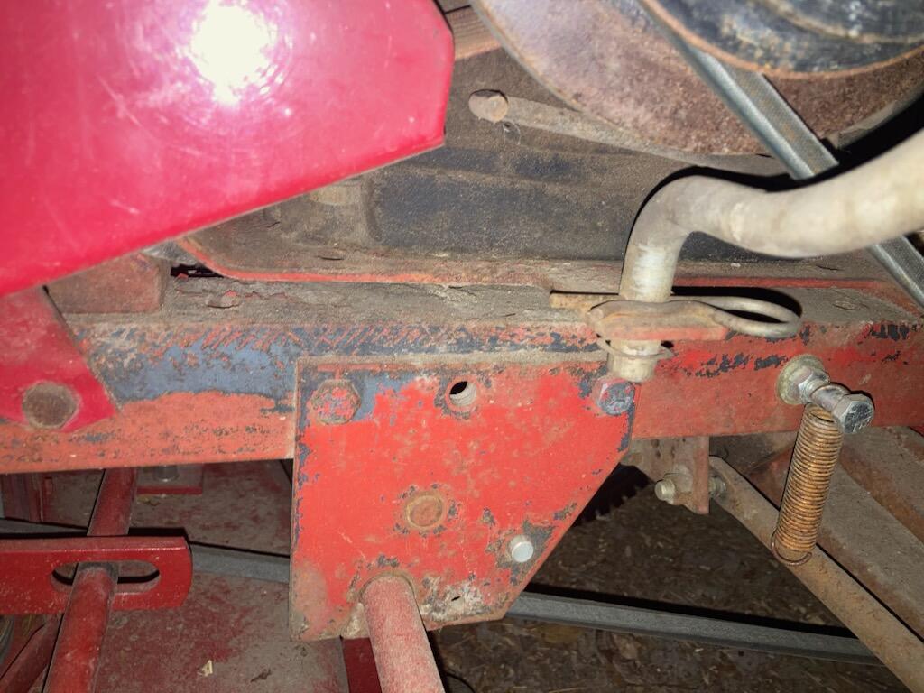

ineedanother 2,768 #16 Posted March 28 @Joshyg , not to create any additional confusion, but if your k321s has the correct pan for being frame mounted, I believe the only other mechanical conversion you would be faced with would be the PTO Housing Rod ("hoop") and bottom bracket for it. Notice the bottom bracket as part of a shaker plate, and the other one bolted to the mid-tach bracket when the engine is mounted on the frame. The bottom of the "hoops" are of different length as well. All are readily available parts from folks here... Share this post Link to post Share on other sites
WHX?? 57,628 #17 Posted March 28 (edited) 11 hours ago, ineedanother said: create any additional confusion, Well you just confused me Ineed ... and that ain't hard to do. I think what he means is what are you planning to do Josh? or just want to learn? INeed piced a example of a AS mounted on a what we call a shaker plate. His first pic. Where a AS is mounted on a plate with vibration isolators. Not directly mounted to the frame. Edited March 28 by WHX?? Share this post Link to post Share on other sites
