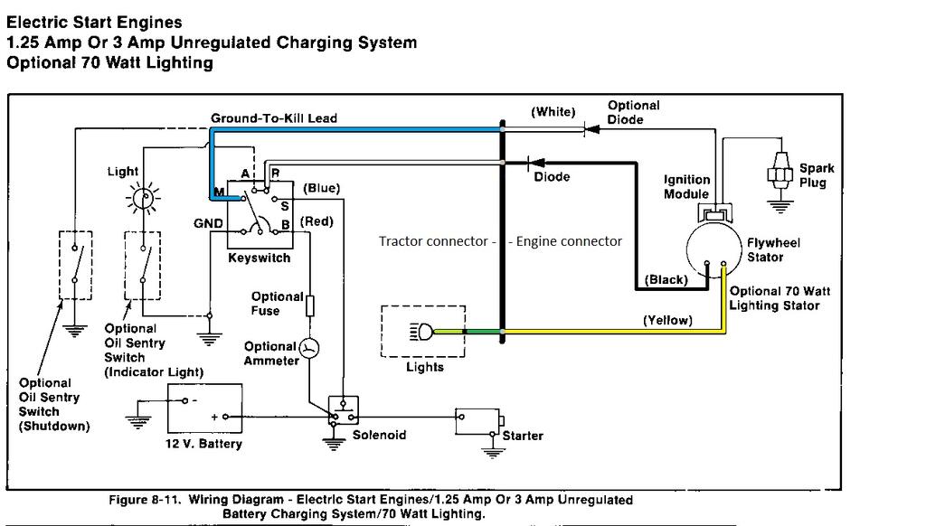

gwest_ca-(File Mod) 12,557 #4 Posted March 22 Will guess you have a 1987 model 21-10K804. The engine wiring was supplied by Kohler so not illustrated in the Wheel Horse diagrams. Going to the Kohler service manual found their diagram. The magneto is self-powered and the lone ignition wire to the ignition switch grounds the magneto to shut it off. Do not allow any battery voltage into the ignition wire. The wiring diagram shows a diode to protect the magneto but have never seen one. The yellow wire should connect to the dark green that provides AC to the lights only. Added tractor wiring to engine wiring 2 Share this post Link to post Share on other sites

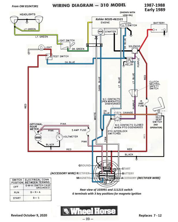

953 nut 70,661 #9 Posted March 22 According to the diagrams the 15 Amp fuse feeds power to the ignition switch and the test switch for the low oil test light. If you have a good 15 amp fuse in place and pushing the test switch eliminates the oil level light then the wires from the battery through the fuse all the way to the light appear to be good. Typically the low oil relay only receives power to its coil if the oil level is very low. With sufficient oil level, the ignition switch is in the start position with the PTO off and the clutch pedal depressed the solenoid should closer and the starter turn over. Could a 38 year old relay develop an internal fault, yes it could but it is much more likely that the insulation on a wire has become compromised. At what point in your operation does the fuse blow? Is it related to the oil level being low? Is it when the key is placed in start without the clutch being depressed? Is it when the clutch is depressed with the key in start? The more specific you can be t5he greater the likelihood we can help diagnose it long distance. Your low oil relay should be a metal can type relay, part # 106833, which has three terminals. There was a service bulletin changing over to the typical automotive five terminal relay at some point, see below. Share this post Link to post Share on other sites

gwest_ca-(File Mod) 12,557 #11 Posted March 22 Added Kohler wiring to the Wheel Horse wiring. 1 Share this post Link to post Share on other sites

953 nut 70,661 #13 Posted March 22 18 minutes ago, Railboy said: I am looking for all the switches in the unit now. My "Seat" switch was disabled before I purchased the Lawn Tractor. I have not found a "PTO" Switch yet, or, the Clutch Engagement Switch, but did find the "Brake Actuator" switch through the Gear Shifter area below the seat. The PTO switches are located inside the steering tower, removing the battery will make them more accessible. The clutch switch is located on the right side of the tunnel between the operator's legs, belt guard needs to be removed to see it. With the low oil switch being removed you should be able to connect the light blue and purple from the low oil relay and eliminate the rest of the wires to that relay. Share this post Link to post Share on other sites
Railboy 13 #14 Posted March 22 On the Light-Blue wire that you want me to connect, is that a positive wire or negative? See, the wires from the "Oil Sender" were cut off, and wiring prongs removed from the connector of the engine but "Stator" wires go into. Just trying to see and like you said, there is not much to go wrong. And I think from what I have read and seen the "Oil Sender" wires were (-) based. Do not know if this could be "Blowing the Fuse", which to me does not seam likely? But have a quick question on the Clutch Switch. If I can start the engine and run it, the Clutch Switch should be fine and no reason to pull the belt guard off to check it? But both the Clutch Switch and PTO Switch should be examined do to wiring rubbing and all? I really do not want to be opening a bag of worms up and creating more havoc, lol.. But up for investigations. Thing is, that I can not see in my diagrams is the "Polarity" of the wires, thus leading to the Blow Fuse? There is no smell or smoke when the fuse pops, just a Blown Fuse that you can see in the Fuse itself. Share this post Link to post Share on other sites
953 nut 70,661 #15 Posted March 22 Is the low oil relay connected to anything? The wires in the red circle would be the wires from the low oil switch, they should be gone leaving only the light blue and purple wires on the relay. Polarity is not an issue. 1 Share this post Link to post Share on other sites

oliver2-44 11,848 #18 Posted March 23 8 hours ago, gwest_ca said: Added Kohler wiring to the Wheel Horse wiring. What is indicated as "black wires" or wires with the "triangle going to ground "on this diagram are negative. Some of what looks like black wires on the diagram are just that piece/part directly bolted to the tractor chassis (so no actual wire exist) and thus grounded through the chassis. All other wires are positive. 2 Share this post Link to post Share on other sites
Railboy 13 #19 Posted March 23 (edited) So the Polarity of the Light Blue wire to tie into from the "Oil Switch/Sender" is what? Positive or Negative? This is what is missing. When the "Oil Sender" was taken out, all the wires were cut at mount to the block coming out from there. So, just wondering what ya'll may know to tie the Light Blue into at the Tractor's Side of the Engine Connector, Positive or Negative? And ya'll have read what I know. The "Oil Sender" is Ground based, but I could be totally wrong, thus blowing fuses... So Oliver 2-44, you are saying that going into the Light Blue is a Positive Input from the "Oil Switch" for normal operation of the lawn tractor in action? Edited March 23 by Railboy 1 Share this post Link to post Share on other sites
