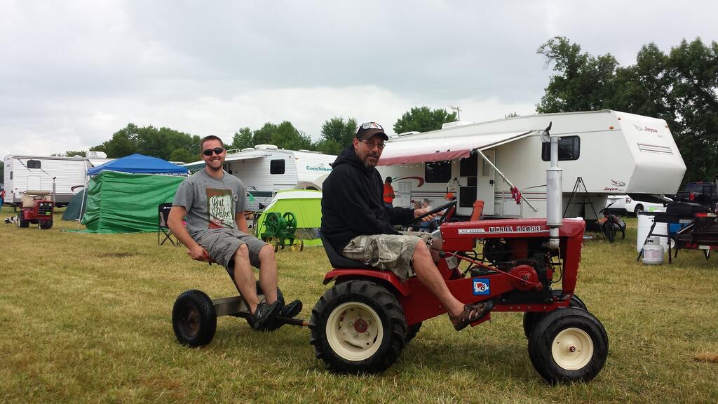

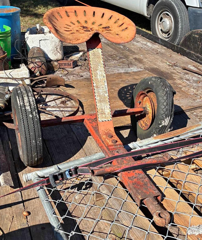

FLtractor 223 #1 Posted March 21 Morning, Came across this on marketplace.. seller about 50 miles round trip.. asking $10.00. Said he’s sat on seat and it’s not rusted through but will need 2 new 4.80/4.00-8 tires. Had idea of once I get my 856 driving running again. Would it be a safe or good idea to fix this up, paint it to match 856 and have someone ride on it behind possibly with a tongue extension between the tractor hitch and sulky? 14 Share this post Link to post Share on other sites
squonk 48,125 #2 Posted March 21 Absolutely! Looks like a Gravely sulky 5 1 Share this post Link to post Share on other sites
ri702bill 13,067 #3 Posted March 21 Nice! You may wish to improve the size & placement of the foot rest though... 1 Share this post Link to post Share on other sites
FLtractor 223 #4 Posted March 21 (edited) 42 minutes ago, squonk said: Absolutely! Looks like a Gravely sulky If I drive extra careful slow and on flat ground… could I put the sulky behind a metal yard wagon that weighs a couple hundreds pounds of steel. Big huge turf saver tires. Welded hitch holes for pins on each end and handle on one that pivots the front wheels.. it was a roofing cart used to move materials on buildings.. I could put tractor- roofing cart- sulky. Thinking along the lines of having someone help me do yard work, load cart, and just be able to hop off the sulky similar to hangin on back of recycle truck ect Edited March 21 by FLtractor Share this post Link to post Share on other sites
FLtractor 223 #5 Posted March 21 (edited) 27 minutes ago, ri702bill said: Nice! You may wish to improve the size & placement of the foot rest though... Good points, will have to see in person. Recommendation on what tires I should put on? Such those ones that never go flat Edited March 21 by FLtractor Share this post Link to post Share on other sites
WHX?? 58,128 #6 Posted March 21 15 minutes ago, FLtractor said: on what tires I should put on? Any 4/4.8-8 tires. Wheelbarrow tires you want to keep the cost down. Be sure to tube them. 5 1 Share this post Link to post Share on other sites
FLtractor 223 #7 Posted March 21 1 hour ago, squonk said: Absolutely! Looks like a Gravely sulky Is this what the orginal color scheme would have been? Might have to see about getting one of those seat cover online that fits and looks the same colors 2 Share this post Link to post Share on other sites
ri702bill 13,067 #8 Posted March 21 If it were "The Mother-in-Law" seat, the tongue would have been about 4X longer... 1 7 Share this post Link to post Share on other sites
squonk 48,125 #9 Posted March 21 6 hours ago, ri702bill said: If it were "The Mother-in-Law" seat, the tongue would have been about 4X longer... Plus an "Emergency Quick Release!" 1 5 Share this post Link to post Share on other sites

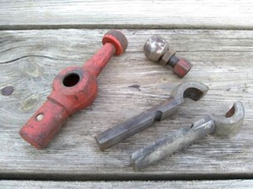

FLtractor 223 #13 Posted March 23 On 3/21/2026 at 8:05 AM, squonk said: Absolutely! Looks like a Gravely sulky What kind of hitch pin to connect the sulky to the tractor hitch? This kind? Share this post Link to post Share on other sites
squonk 48,125 #14 Posted March 23 That used a ball and clamshell connection. cut that off and make your own for the Horse. Share this post Link to post Share on other sites

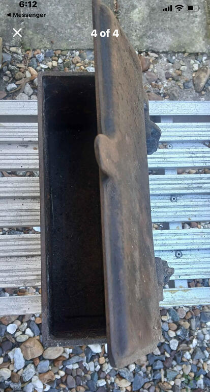

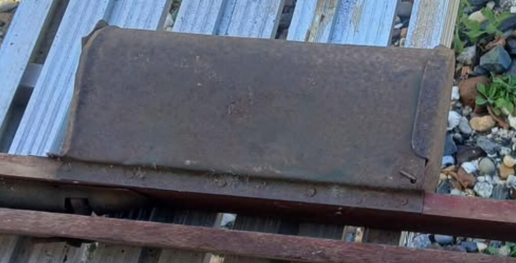

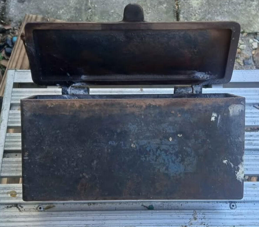

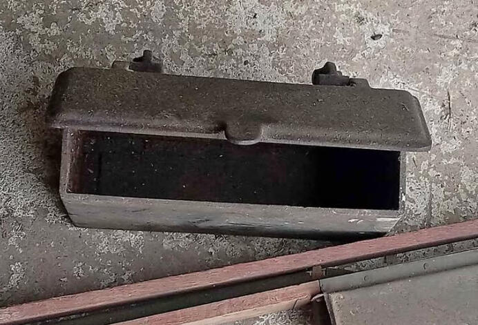

FLtractor 223 #15 Posted March 23 (edited) 8 hours ago, Lane Ranger said: You need to add a basket on that sulky to place all those parts you end up finding at Shows and Swap Meets! You won't regret adding that during your redo! Have a picture of what kind I should look for? Seller about 50 miles away is selling this.. says it weighs 15lbs.. asking $20.00. Would it be ideal to mount on the sulky, if so how would I go about doing so? Edited March 23 by FLtractor Share this post Link to post Share on other sites

gwest_ca-(File Mod) 12,488 #19 Posted March 24 Be nice if you could find a ball for the clam shell hitch. They mount upside down to a normal trailer ball. The drawbar on the sulky is 1-1/4" schedule 40 water pipe. Slide the clam shell into the pipe and insert the pin to hold them there. This was used with a heavy front attachment on the 2-wheel tractors. The other casting with the hole in it is for when no front mounted heavy attachment was used. It is called a roller rest and the roller on the front rides on a flat bar to keep the 2-wheel tractor and sulky horizontal. The roller allows for turns. Share this post Link to post Share on other sites

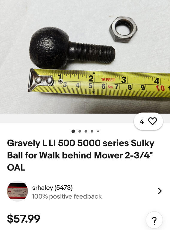

FLtractor 223 #20 Posted March 24 (edited) 3 hours ago, gwest_ca said: Be nice if you could find a ball for the clam shell hitch. They mount upside down to a normal trailer ball. The drawbar on the sulky is 1-1/4" schedule 40 water pipe. Slide the clam shell into the pipe and insert the pin to hold them there. This was used with a heavy front attachment on the 2-wheel tractors. The other casting with the hole in it is for when no front mounted heavy attachment was used. It is called a roller rest and the roller on the front rides on a flat bar to keep the 2-wheel tractor and sulky horizontal. The roller allows for turns. So if I kept the clamshell on the sulky.. the ONLY piece I need to safely tow it with the tractor is this ball here and it goes on upside down with the nut on top- just sits in the clamshell.. nothing else needed? More than I’d like to spend, gonna see if I can find cheaper option.. would this chrome ball 2 3/4 on eBay work as well upside down? Edited March 24 by FLtractor Share this post Link to post Share on other sites
