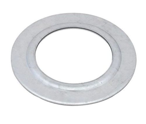

squonk 47,729 #2 Posted March 22 How much room are you lacking? You may be able to find and an electrical box reducing washer that will fit around your voltmeter. Maybe stack a few to bring the meter out away from the shaft. You can polish the washers and clearcoat them to pretty them up. Share this post Link to post Share on other sites
702854boy 1,072 #3 Posted March 22 2 hours ago, squonk said: How much room are you lacking? About a 1/4 to 5/8 of an inch Share this post Link to post Share on other sites
