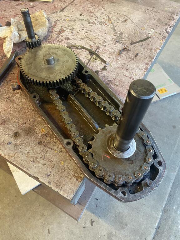

c-series don 12,752 #9 Posted March 20 Here is what it looks like in there. I put new seals in mine a few years ago. 3 3 Share this post Link to post Share on other sites
WHX?? 58,388 #10 Posted March 20 Pretty stout chain there Don #50? Is there a master link? Share this post Link to post Share on other sites
c-series don 12,752 #11 Posted March 20 Honestly Jim, that was a few years ago and I don’t remember!! 1 Share this post Link to post Share on other sites

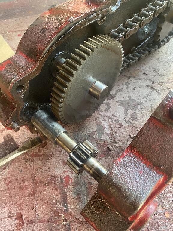

Skwerl58 843 #12 Posted March 20 Thanks for the pictures. I see the gear that I thought the chain was on and it is the one that drives the shaft that the chain is on. It had been separated before I got it because it has gasket maker in the seam. 3 Share this post Link to post Share on other sites
WHX?? 58,388 #13 Posted March 20 1 hour ago, Skwerl58 said: has gasket maker in the seam. Yep sure sign and now ya gotta wonder what the PO missed or worse cobbled. FYI Lowell has the gaskets. https://wheelhorsepartsandmore.com/product/toro-wheel-horse-6851-tiller-gearbox-gasket/ 2 Share this post Link to post Share on other sites
gwest_ca-(File Mod) 12,557 #14 Posted March 20 If you have the U-clip off the master link make sure the rounded end of the U-clip is facing the direction of rotation. 5 Share this post Link to post Share on other sites

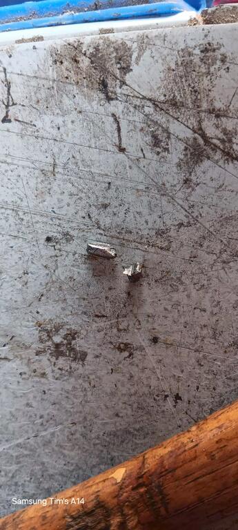

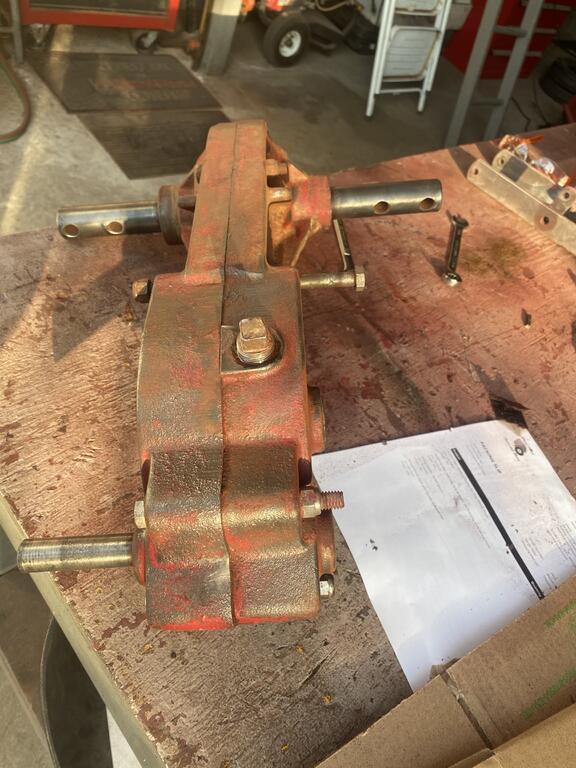

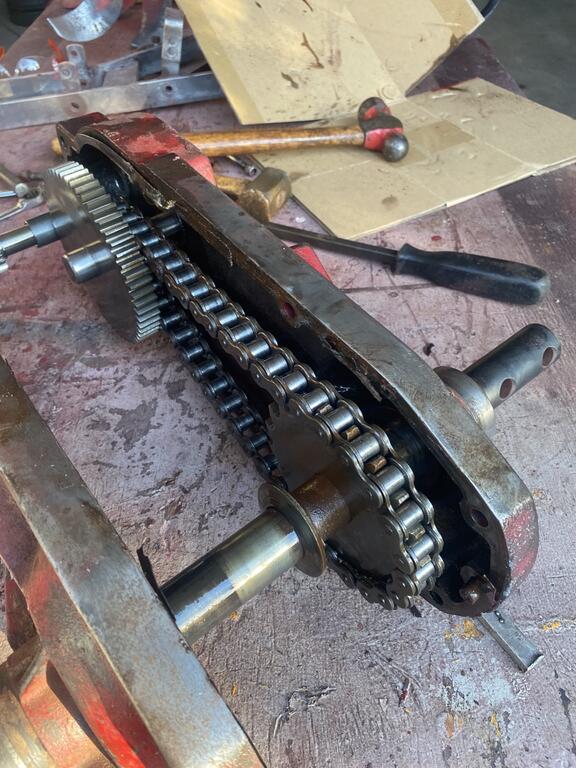

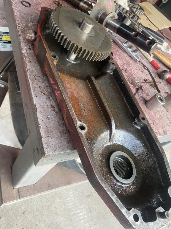

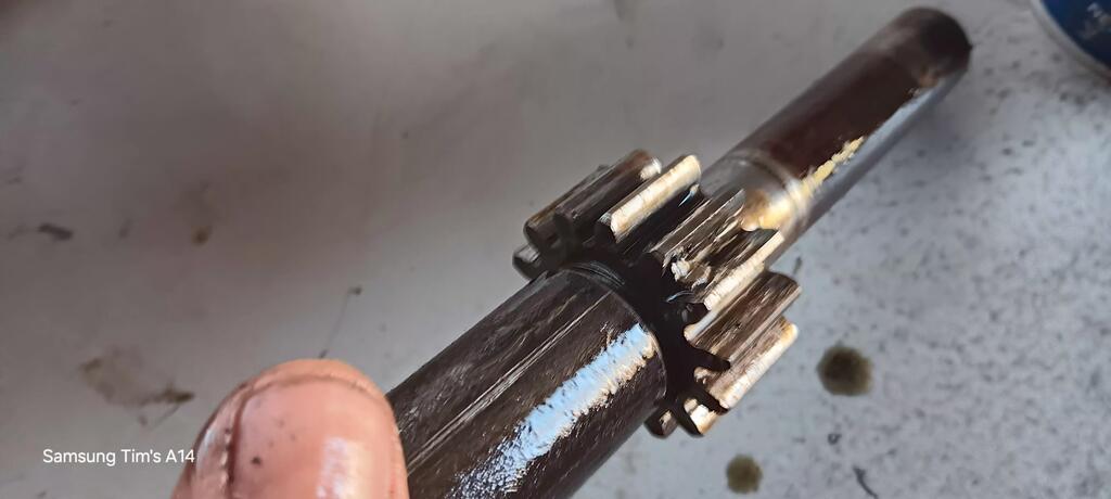

Skwerl58 843 #15 Posted March 20 Got the tiller apart and a small piece of metal had jammed in between the drive gears. I found another piece in the case. The only thing damaged was the e-clip that holds the small drive gear in place. I replaced it and cleaned up the cog where the metal was embedded. I looked at all bearings, shafts, gears and the chain and have no idea where the small pieces came from. The small piece of metal on the right is what was embedded in the cogs the other was in the case. Both of the pieces are probably combined the size of a bb. I have the two halves reassembled and it is turning great. Hopefully will use it next week to till some garden. 20260320_122456 (1).heic 3 Share this post Link to post Share on other sites
953 nut 70,649 #16 Posted March 20 1 hour ago, Skwerl58 said: have no idea where the small pieces came from. Could the piece of metal be from one of your bearings? Need to check them cdclosely. 1 Share this post Link to post Share on other sites
Skwerl58 843 #17 Posted March 21 I checked the bearings and re-checked them. Called my neighbor over to check it out too. We could not locate where it came from. I am puzzled by it and have been "scratching my head" over it. I packed the needle bearings with white lithium grease after checking. If I missed something it will show up and hopefully with no damage. 1 1 Share this post Link to post Share on other sites
kpinnc 19,107 #18 Posted March 21 Looks almost like someone drove a pin out of the chain to remove a link or something. Glad it didn't break anything! Share this post Link to post Share on other sites
