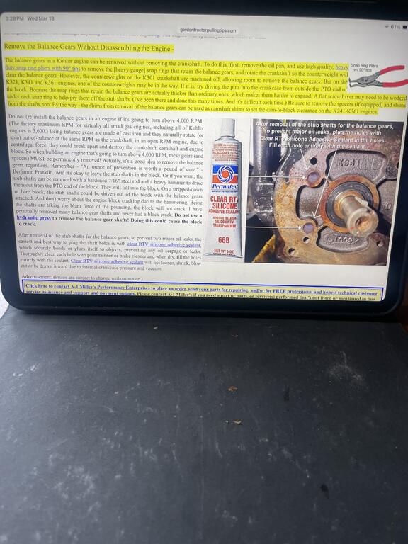

AHS 1,703 #1 Posted March 18 Ok, these engines are getting old! (As young as they may seem!!) 40+ y/o. What are your thoughts on this? On Brian Millers website, just take off the oil pan and ‘lighten the load!’ Curious to know what you guys think. 2 Share this post Link to post Share on other sites

Achto 32,963 #3 Posted March 19 (edited) 12 hours ago, AHS said: just take off the oil pan and ‘lighten the load!’ Sometimes you get lucky and are able to get the gears out without driving the pins out. If you do have to drive the pins out, I would use expansion plugs to fill the holes, not RTV. Edited March 19 by Achto Share this post Link to post Share on other sites
AHS 1,703 #4 Posted March 19 1 hour ago, Achto said: Sometimes you get lucky and are able to get the gears out without driving the pins out. If you do have to drive the pins out, I would use expansion plugs to fill the holes, not RTV. Ya!! I think it’s a 7/16” hole!! 1 Share this post Link to post Share on other sites
AlexR 3,139 #5 Posted March 19 It's recommended to remove the gears, especially if you can wiggle them at all. While you can inspect the gears make sure they are a newer style do new bearings make sure they are shimmed and timed right. The question remains is it worth doing all that. For most people the answer is no. You can take the bottom gear out for sure without pulling the pin, the top gear I was not able to remove with the pin so I drove that pin out and then drove that same pin back in from the outside and will cut it off. 1 Share this post Link to post Share on other sites
Mike'sHorseBarn 3,712 #6 Posted March 19 I just had the pan off on my cub 169 and thought about taking out the balance gears, but they seemed good and tight and I elected not to mess with it. I may regret that in the future, but I sure hope not 1 Share this post Link to post Share on other sites
