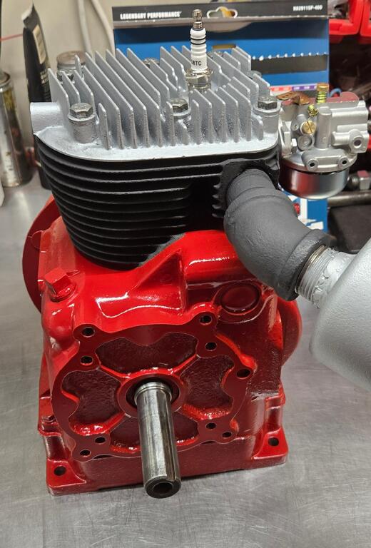

953 nut 68,125 #2 Posted March 17 The only part of your engine that becomes hot enough to damage regular spray paint is the head and the cooling fins around the cylinder. The head should never be painted and the cooling fins should only be given a light coat of high temperature paint, I prefer flat black for the fins. 5 Share this post Link to post Share on other sites
oliver2-44 11,655 #3 Posted March 18 You could also paint the fins with hi temp silver. Then paint the base of the block sunrise Red. 2 Share this post Link to post Share on other sites
Achto 32,243 #4 Posted March 18 I use the same acrylic enamel paint on the engine that I use on the rest of the tractor. I never paint the aluminum cylinder head or the bearing plate. The only place that the paint ever discolors is around the exhaust port. 4 Share this post Link to post Share on other sites
kpinnc 18,849 #5 Posted March 18 (edited) 4 hours ago, 953 nut said: The head should never be painted and the cooling fins should only be given a light coat of high temperature paint, I prefer flat black for the fins. Same here. Once the tins go on you can only see the PTO side of the fins, and it looks nice and clean. Edited March 18 by kpinnc 1 7 Share this post Link to post Share on other sites
Retired Wrencher 6,899 #6 Posted March 18 Nice job on the engine Kpinnc! 1 1 Share this post Link to post Share on other sites
WHX?? 57,628 #7 Posted March 18 (edited) 3 hours ago, Retired Wrencher said: Nice job on the engine Kpinnc! Mr. Honda ... That motor won't fit in with your repos ... I best come get it ... 11 hours ago, Achto said: paint on the engine that I use on the rest of the tractor. I'll second that. Worst problem I've had is getting the block clean enough to get regular paint to stick unless it's a full rebuild. Edited March 18 by WHX?? 2 Share this post Link to post Share on other sites
kpinnc 18,849 #8 Posted March 18 2 hours ago, WHX?? said: That motor won't fit in with your repos ... I best come get it ... Yeah yeah that's for the 701. I'll get it finished eventually. At least it's now bolted in the tractor! 1 Share this post Link to post Share on other sites
