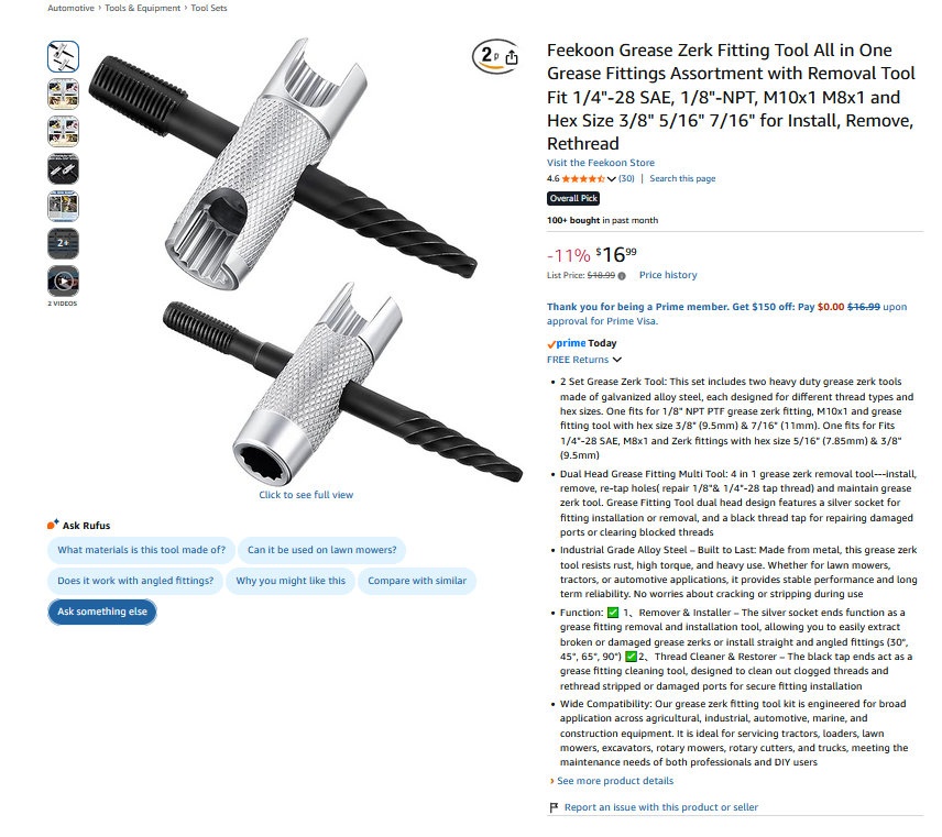

WHX?? 58,388 #8 Posted March 14 That's a handy one Paul. Share this post Link to post Share on other sites
