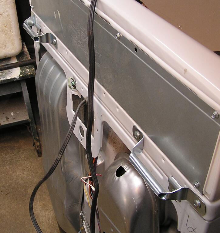

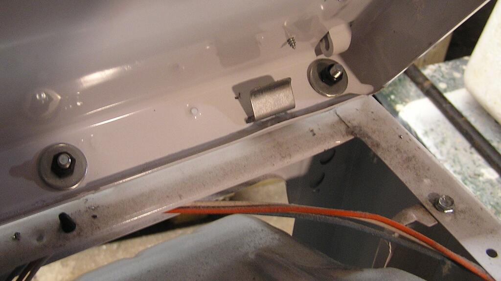

ri702bill 13,060 #1 Posted March 13 (edited) We take our gas dryer down off the pedestal it shares with the washer once a year to remove the back, front & drum to give it and the vent hose a through cleaning. It is a PITA to grab it from the rear, so I added a pair of Garage Door Handles. Truss head screws, Thick fender washers & nylock nuts. Much better... Edited March 13 by ri702bill 10 7 Share this post Link to post Share on other sites
ebinmaine 80,695 #3 Posted March 13 Nicely done sir. 1 1 Share this post Link to post Share on other sites

peter lena 10,065 #6 Posted March 13 @ri702bill nicely done on that !! , no matter what , a repetitive problem is , its showing you the way , to correct it , make it better . https://www.google.com/search?q=screw+in+eye+bolt+rings&rlz=1C1CHBF_enUS866US866&oq=screw+in+eye+bolt+rings+&gs_lcrp=EgZjaHJvbWUyBggAEEUYO added these to my shed framing , for a spring hook to hold my mower decks off season . makes heavy awkward holding easy . out of the box , pete 1 Share this post Link to post Share on other sites
