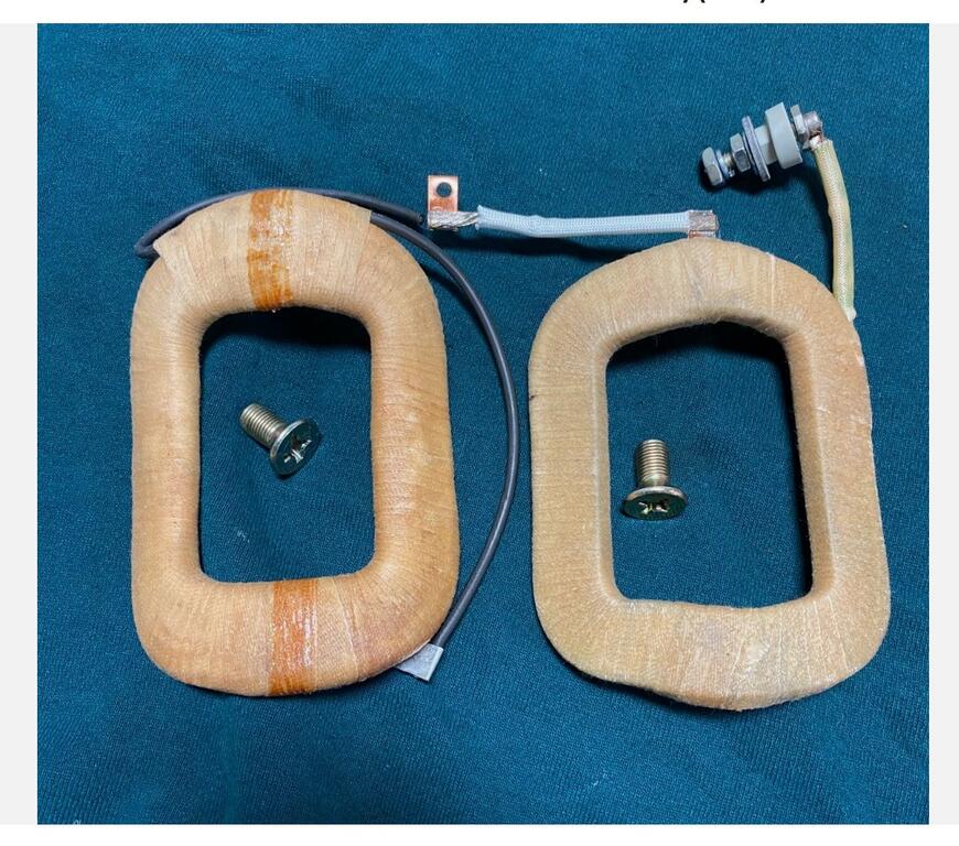

Since you did brushes and such likely failure is the Charging Field coil.
  • Like 1
702854boy
Does anyone still do winding rebuilds or do we have to try to figure out on our own or get a new one?
pfrederi
Posted (edited)
I think you pretty much have to buy the field coil   no way I would try to rewind one of these....
Edited by pfrederi
