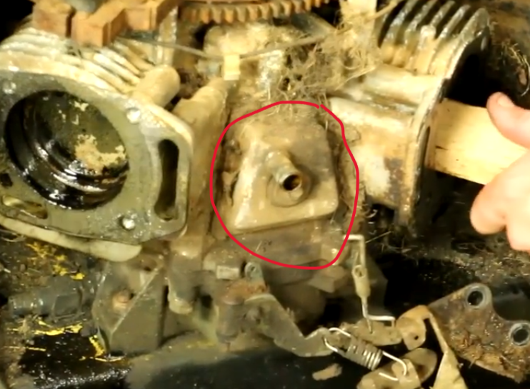

horseman with no horse 68 #2 Posted March 12 also how do i get the friggen pcv that sits in the valley off? its got one long bolt and idk if it pulls right off or slides, or what. i reefed on it and cracked the nipple on it the the pcv hose goes on Share this post Link to post Share on other sites
horseman with no horse 68 #3 Posted March 12 (edited) the nipple on the PCV question Edited March 12 by horseman with no horse Share this post Link to post Share on other sites

horseman with no horse 68 #12 Posted March 18 as for the breather it looks like it just gets pulled straight off based on the manual? Share this post Link to post Share on other sites
