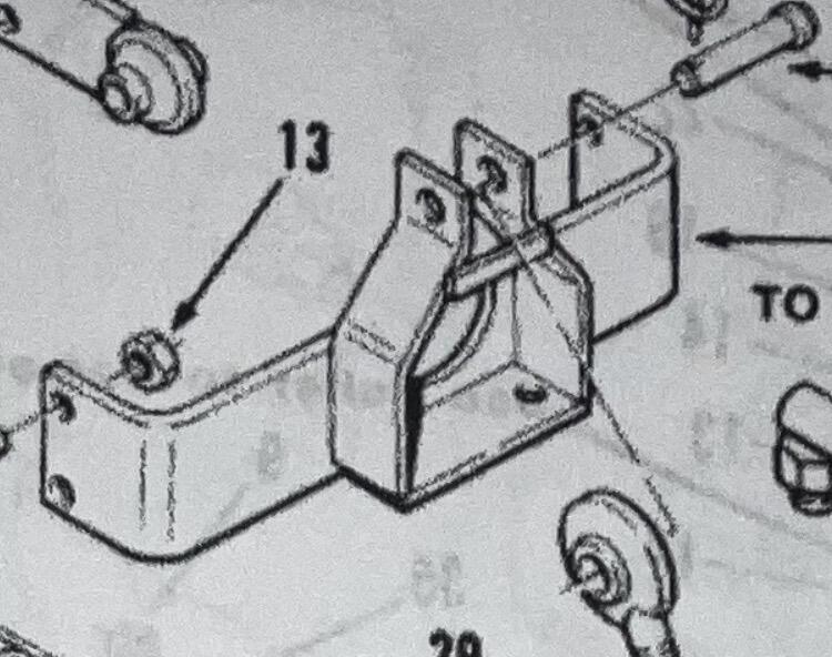

wh315-8 564 #1 Posted March 9 109791 ASSY UPPER LINK, seeking this part or the Measurements would be a great help. Share this post Link to post Share on other sites
Thor27 873 #2 Posted March 9 (edited) I don't know if this will help you, but it's the best I got. 3"×3/8 flat strap. 14" wide between uprights, ends have 2x 3/8" holes on 2" centers. The uprights on D stuff is 3" narrower. I widened one from a D, but haven't made the actual mounts for the center link yet, but they will just be flat bar. I'd have started from scratch but have no way to bend that heavy of material. Mine will be a dedicated loader tractor so there is no provision for a pto. I've been chasing that part for years. It's rare like bigfoot, There is a set on page 2 of the classifieds right now, linked below. I'm trying to buy these, but have no confirmation from seller at this time and dont know that it will happen. I don't restore, so correctness may be more important for you to pick this up. There are only 4 parts that are unique to a 195, the others are same as a D. #109791. (#11 on tpl) #109787. (#1 on tpl) 2x #109786 (#2 on tpl) these are on a 2-1/2 center, the D's are on a 2" center https://www.wheelhorseforum.com/classifieds/for-sale/wheel-horse-d-seriesc-195-3pt-hitch-r14399/ Edited March 9 by Thor27 Add + link 2 Share this post Link to post Share on other sites

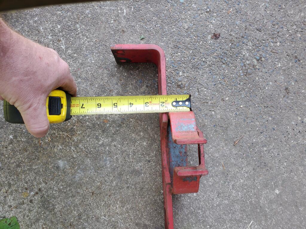

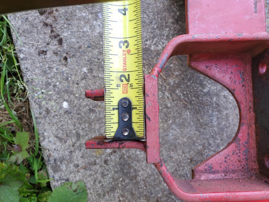

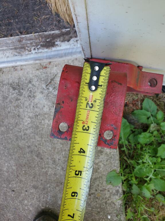

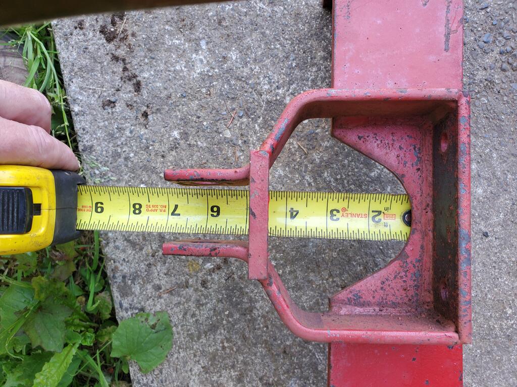

Thor27 873 #4 Posted 2 hours ago I did get my hands on one of these, here are the measurements I didn't have. It does sit farther out than I thought. Share this post Link to post Share on other sites
