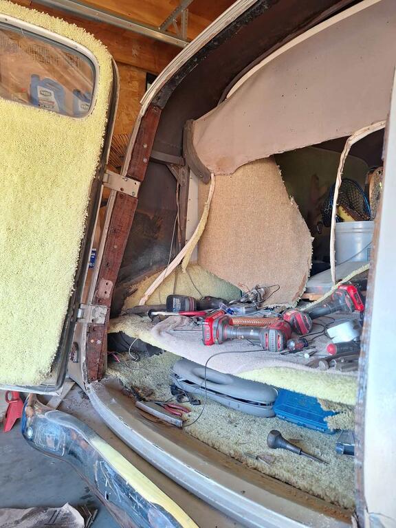

Beap52 2,497 #1 Posted March 7 Some 50 years ago I replaced the wood around the back door of my sedan delivery. It's been getting progressively harder to close due to sagging and a loose hinge. The suspect was the wooden door frame. Once I got into it, I found that some insect had bored holes and weakened the frame. Looks like I have a project on my hands. Of course I'm in to it deeper than I had planned. 6 4 Share this post Link to post Share on other sites

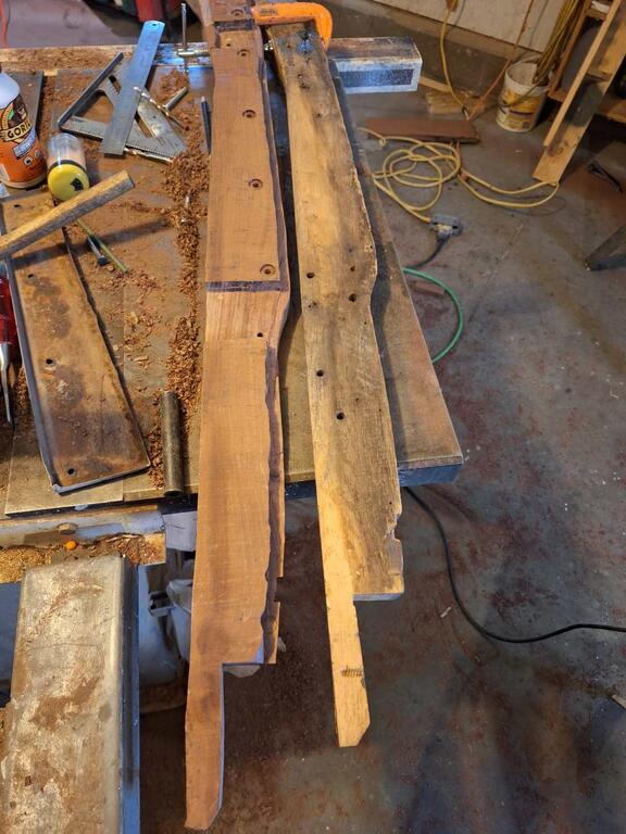

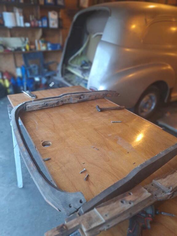

Beap52 2,497 #6 Posted March 7 After studying the situation, I've decided that I only need to replace one board on the hinge side. The sides are actually two boards sistered together. The one the hinges are attached to (which is one of them that I replaced years ago) was the one that insects decided to eat. I had to remove the whole wooden frame as a unit. The three boards in the first picture shows the one I am replacing on the right, the sister that goes behind in the middle and the left is the new board I am working on, It's an seasoned cedar (juniper), straight grained, knot free and hard. The two hinges are backed with metal brackets from the factory. The split in the middle board was filled with epoxy. The second picture shows the new board and it's backer board. I'm free hand routing the new board. I rough cut and held it in place scribing the body metal that wraps around the board. I spent a good deal of time trying to locate the hinges both by clamping the two boards together and aligning the holes used to attach the hinges, drilling pilot holes for the hinges by placing the new board along side of the door and finally measuring the opening. I can's say for sure that ever swung like I hope to make it this time. I've raised the door ~3/16 of an inch hoping it aligns with the striker better. Unfortunately, the door slipped and fell breaking the tear drop tail light lens that are specific to sedan deliveries. Fortunately I have a NOS still in the box in the glovebox for the past 50 years. Things that make you go HMMMMM. 3 1 Share this post Link to post Share on other sites

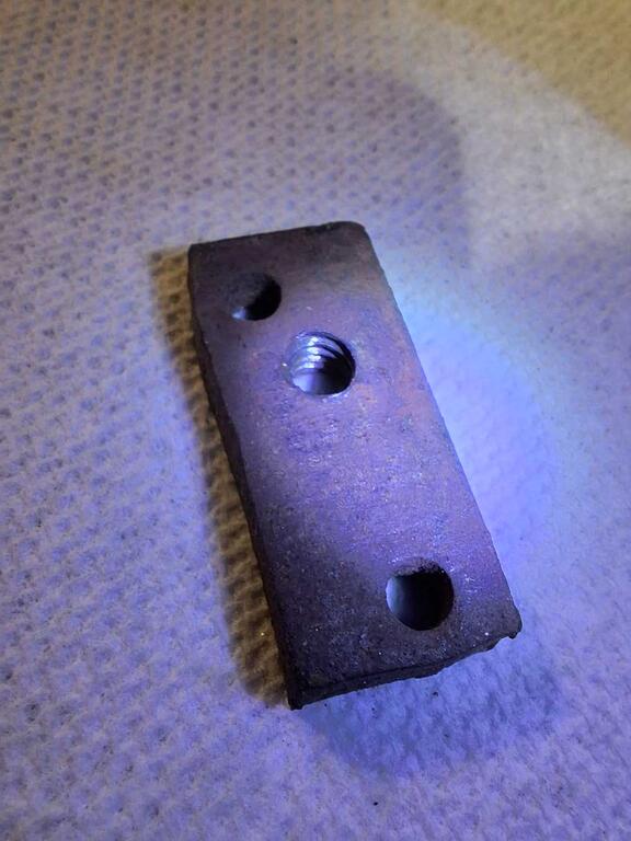

Beap52 2,497 #8 Posted March 9 Spent all afternoon working on the delivery door. I took the advice of using wood hardener and it sure sealed the wood and certainly will protect it even though it's kept inside and seldom gets wet. Pictured below is one of the eight "captured nuts" used are 1/4" by 3/4" by 1 1/4" steel that is tapped for 1/4 bolts/screws and held in place with a short roofing nail. They are a bit of a challenge getting them aligned so that took me a couple of hours. The door is hung. and swings nice. It will take another day's work putting everything back together. It wasn't as big of a project was I first thought and I glad it's almost done and get it back on the road. 3 Share this post Link to post Share on other sites
