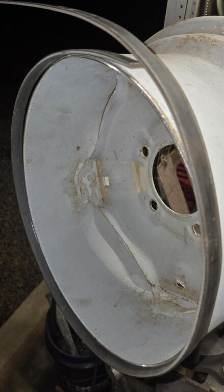

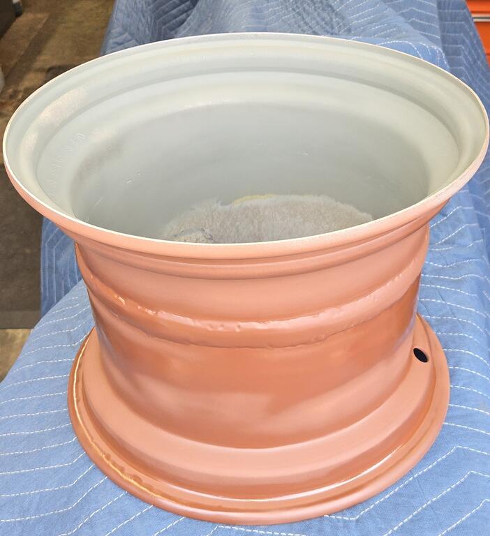

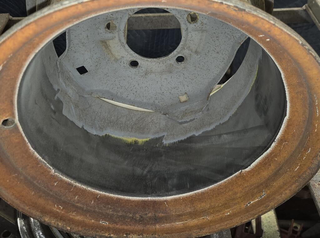

kpinnc 18,916 #55 Posted April 25 (edited) Well, one of my cuts got a little off by about 1/4 inch and didn't come out straight. The wheel horse wheel cut great but the other one didn't. So I bent a 1/2 inch wide, 1/8 thick steel bar to line everything up. I scribed a mark .150 along the edge as a guide since one half of the wheel was straight. I used the line as a guide and clamped every inch until I was all the way around the wheel. Then I tacked the other half, working my way around. I repeatedly measured the width as I went, and then filled the inside gap with multiple passes after. The grinder and a flap disc cleaned the inside up nicely. If I ever do another set of these, I absolutely will do it this way. Alignment was much easier and it's probably stronger this way as well. Edited April 25 by kpinnc 4 2 Share this post Link to post Share on other sites
sqrlgtr 3,805 #56 Posted April 25 Nice recovery, got any pics of inside rim (where tube goes)? 3 Share this post Link to post Share on other sites
oliver2-44 11,717 #57 Posted April 25 Just like a chill ring on the inside of a pipe weld, excellent, 4 1 Share this post Link to post Share on other sites
kpinnc 18,916 #58 Posted April 25 13 hours ago, sqrlgtr said: Nice recovery, got any pics of inside rim (where tube goes)? Yep. Welded all the way around both edges. Definitely more work than I wanted but if I ever try this again, this is how I will do it. Nice smooth edges. Won't harm a tube. 1 6 Share this post Link to post Share on other sites

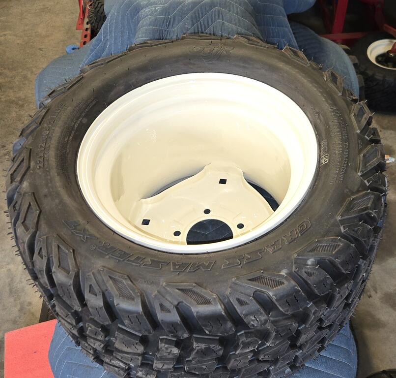

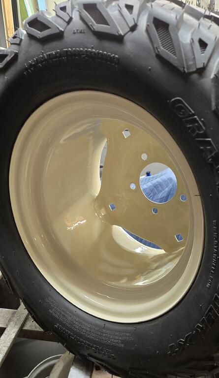

kpinnc 18,916 #59 Posted April 25 First side of the first wheel painted. Not perfect by any means but I like it. 2 7 Share this post Link to post Share on other sites

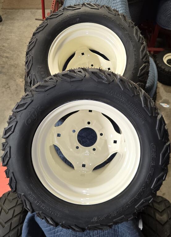

kpinnc 18,916 #60 Posted April 26 Second Wheel turned out much better. Painting wide wheels is a different animal than regular ones. Getting way inside the dish produces alot of overspray. But I found a better method on the second wheel by standing it up, placing a bag on the backside and painting about 1/3 of the way round and using a heat gun to firm it up before moving to the next third. Sounds strange but it works. First one might need some touch up, but I'm done for today. 3 7 2 Share this post Link to post Share on other sites

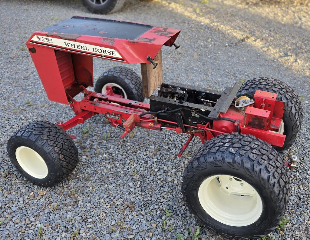

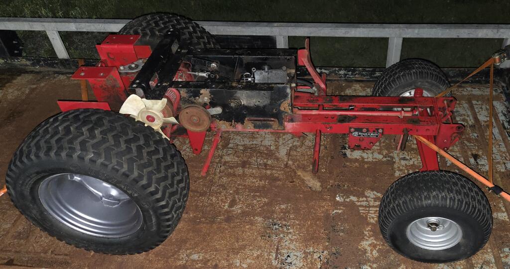

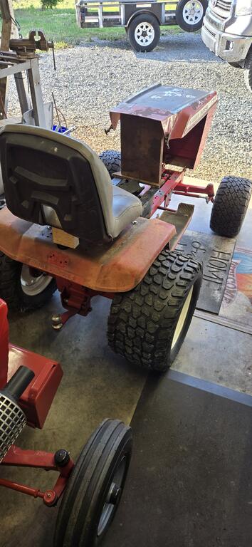

kpinnc 18,916 #61 Posted April 27 Got the donor frame/ hydro cleaned up this evening. It was really nasty so I just loaded it and went to the car wash. 2 5 Share this post Link to post Share on other sites

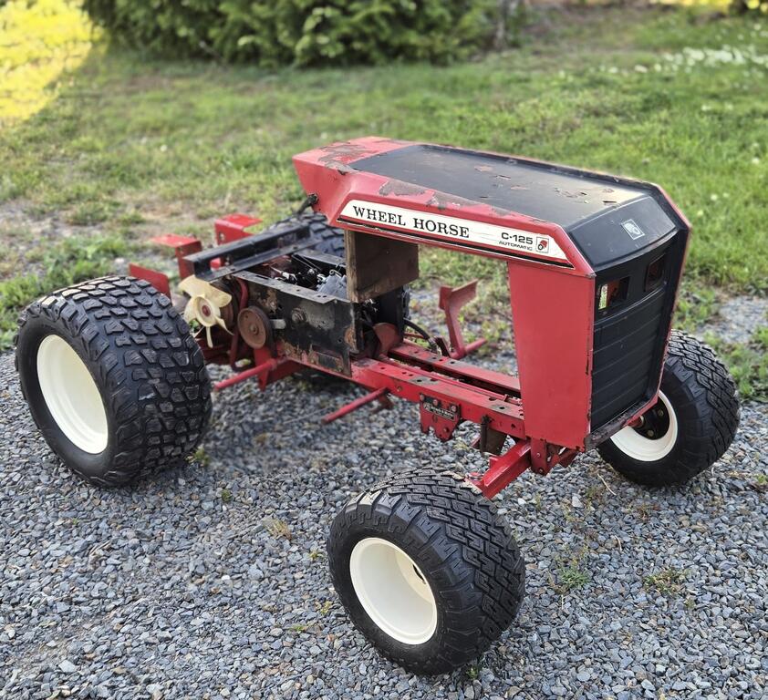

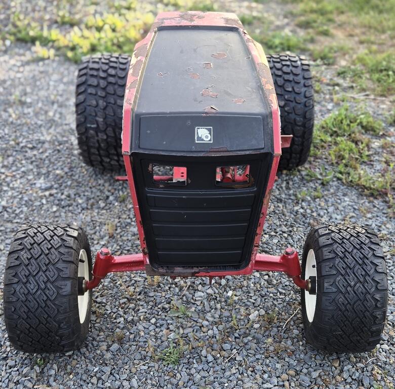

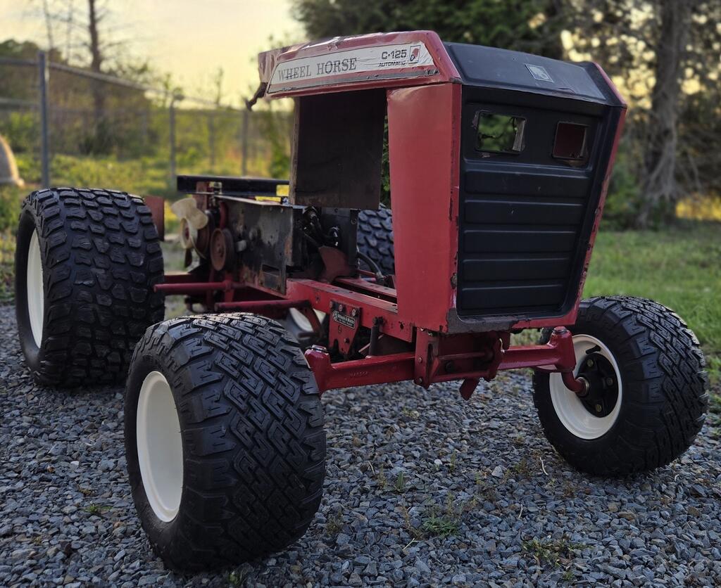

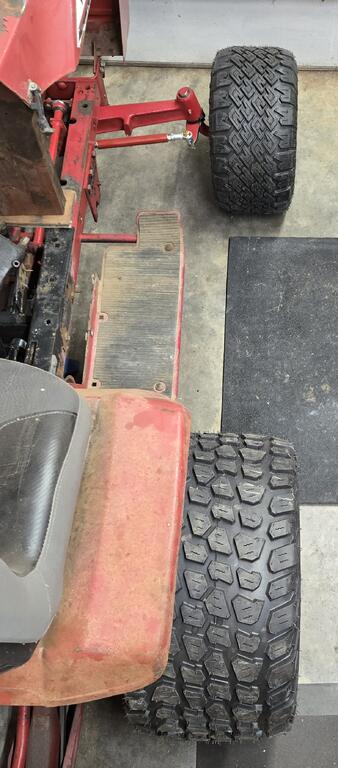

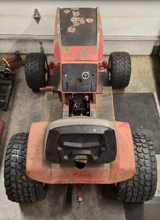

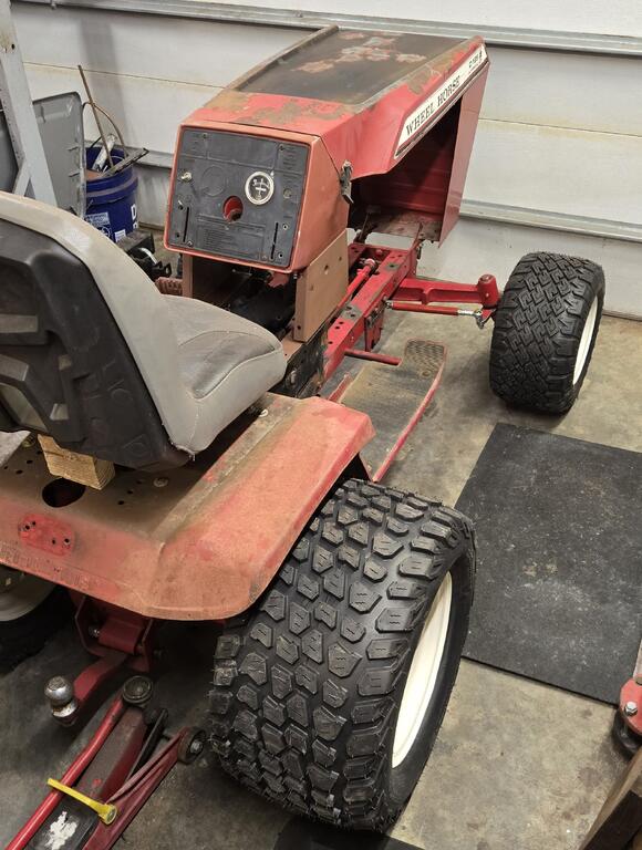

kpinnc 18,916 #62 Posted April 27 Just a little inspirational mock up to get an idea of where this is going. Front will narrow by over an inch, rear will widen by two inches. But the basic idea is there... 3 4 5 Share this post Link to post Share on other sites
sqrlgtr 3,805 #63 Posted April 27 @kpinnc looks pretty good the way it sits right know. 3 1 Share this post Link to post Share on other sites
kpinnc 18,916 #64 Posted April 28 32 minutes ago, sqrlgtr said: looks pretty good the way it sits right know. Thank you sir. Clearly a long way to go but I just wanted to get an idea of how it will go together. I've never had a black hood before so I'm excited to see how it will look. I also have to get the 701 finished so this one can go on my shop stand before I get too far on it. I'm getting too old to squat down to the floor too much. 1 2 Share this post Link to post Share on other sites

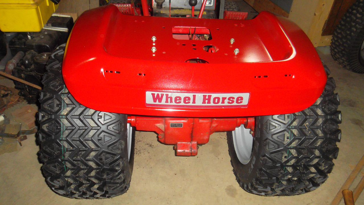

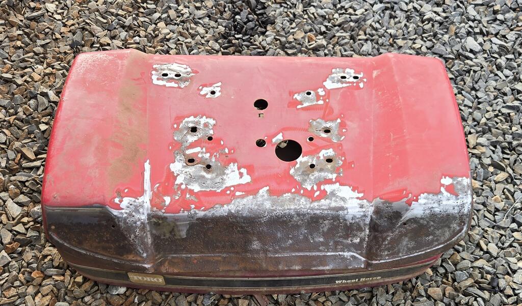

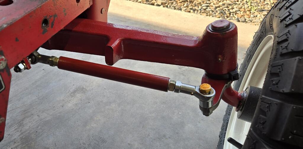

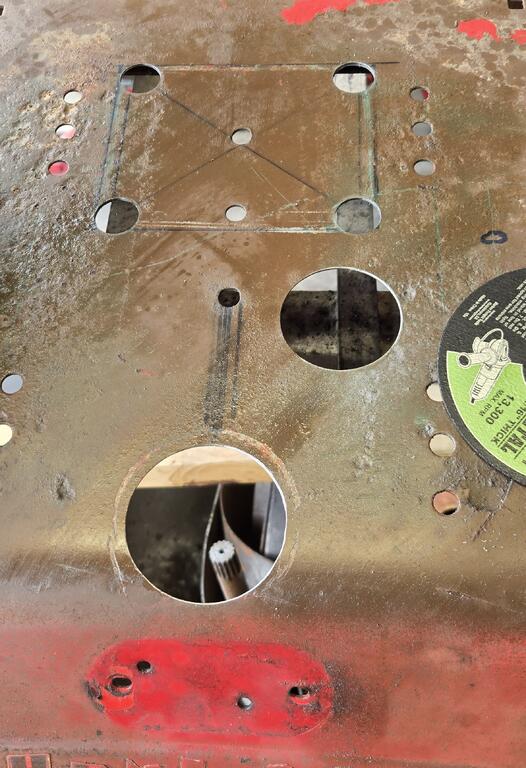

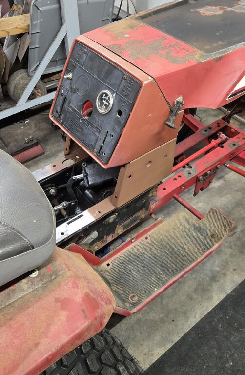

kpinnc 18,916 #66 Posted May 2 So anyone who actually owns a black hood can see that as with most of my machines, I end up adapting different parts for some things. That being said, I prefer the look of the older rear fenders on a black hood. I found one in my parts but it had several cracks and dents to fix. Not to mention the rear of the fender was badly rusted. In addition I was going to have to add the square hole over the eccentric to use on an Eaton. I had a fairly decent fender from a Charger, so I just copied the bolt pattern, square cutout for the hydro, and the dipstic and fuel holes. Turned out great and will need far less repair that the newer one. I also got the tie rods made up. Heim joints on both ends. 2 5 1 Share this post Link to post Share on other sites
ineedanother 2,845 #67 Posted May 3 3 hours ago, kpinnc said: So anyone who actually owns a black hood can see that as with most of my machines, I end up adapting different parts for some things. That being said, I prefer the look of the older rear fenders on a black hood. in I agree @kpinnc, that seat pan just does things right. Kinda like five spoke or rally wheels. ageless. 3 2 1 Share this post Link to post Share on other sites

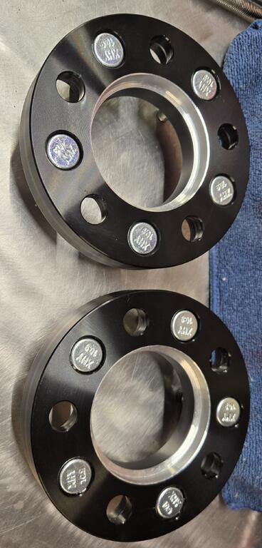

kpinnc 18,916 #68 Posted May 3 Some dummy ordered the wrong spacers... Luckily, said dummy has a lathe. Opened the center just enough to fit WH hubs. Quick and easy fix. Definitely brings the track back even. Much better! 5 2 Share this post Link to post Share on other sites

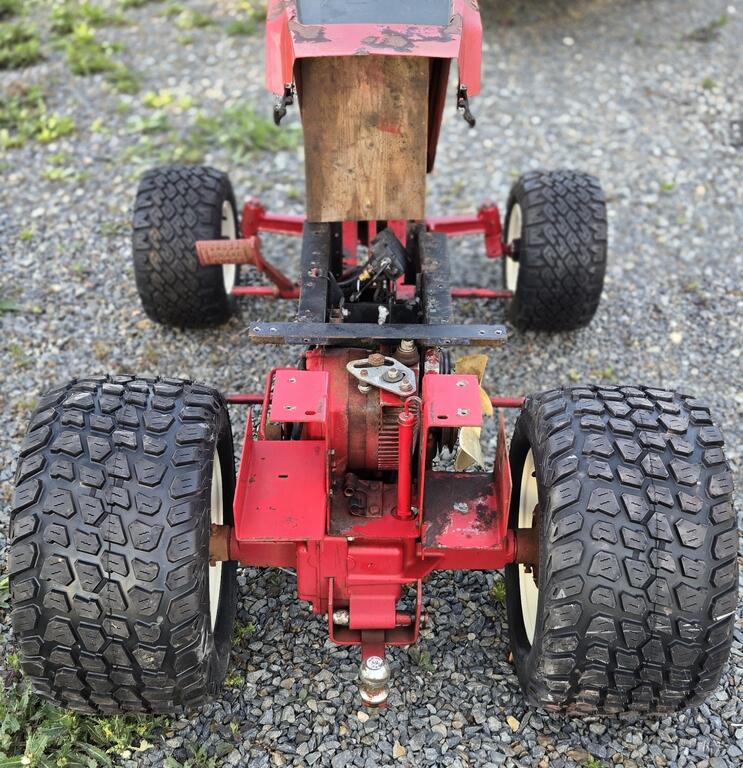

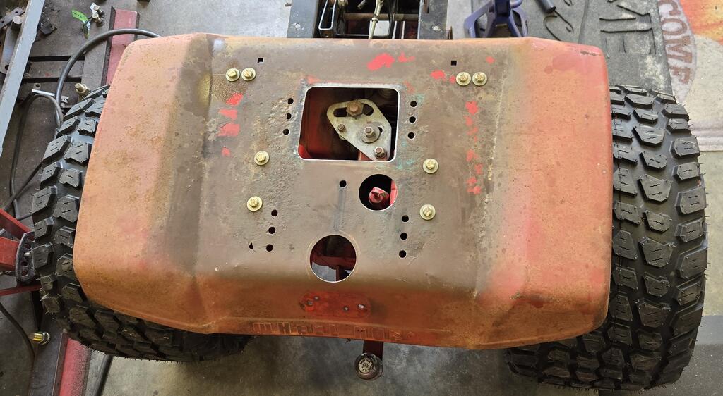

kpinnc 18,916 #71 Posted May 4 (edited) I finally finished taking the other donor machine apart today. It was a C-125 8 speed black hood. And it was one of the rustiest hunks of junk I've ever tackled. Everything on it is frozen, even the differential. No pedals or steering parts would move. After getting the tranny removed I poured a gallon of kerosene in it and set it aside for later. The differential did finally free up but the shifters are stuck. That is a project for a later date... The biggest thing I was after was the center console and steering support thingy. None of the side or belt covers will work because I'm building a hydro. Maybe I'll use the footrests. They look shorter than usual... maybe it's my uncalibrated eyes. I had to cut the steering shaft. Didn't want to risk breaking the aluminum supports up top. I'll e-tank the wheel and see if it the rest of the shaft can be safely removed later. Probably gonna use a larger wheel anyway. But- everything will line up and bolt onto this newer chassis. At least there's no mods to do there. Edited May 4 by kpinnc 6 2 Share this post Link to post Share on other sites

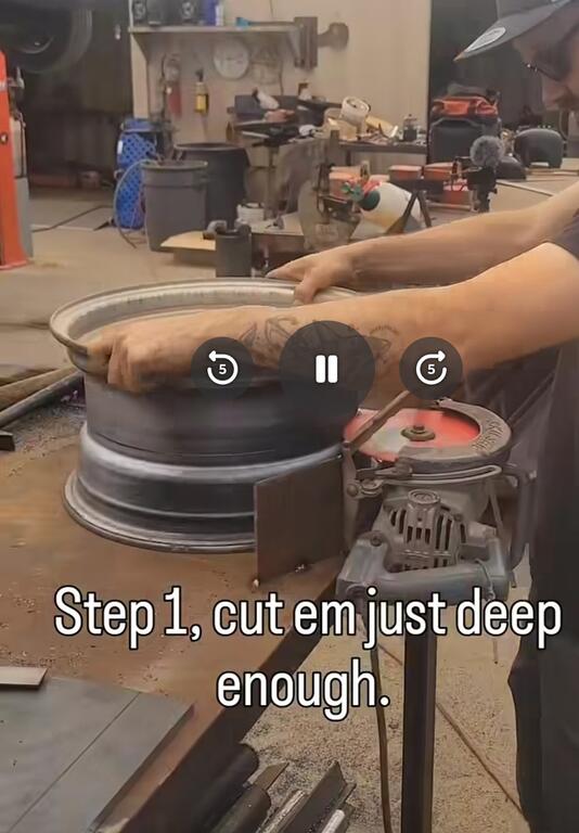

AlexR 3,084 #73 Posted June 7 Saw this in a clip, another idea for cutting straight on a rim. 1 2 Share this post Link to post Share on other sites
kpinnc 18,916 #74 Posted June 7 (edited) 2 hours ago, AlexR said: Saw this in a clip, another idea for cutting straight on a rim. I will say this: a wide set of wheels can be had for a couple hundred bucks. ...worth it! Mine turned out great. But I probably spent $100 in materials. And about 12+ hours of time. I'm glad I know how to do it now, but I'll buy the next set! Edited June 7 by kpinnc 5 Share this post Link to post Share on other sites
