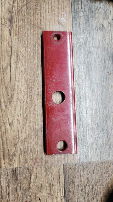

Racinbob 13,183 #1 Posted March 5 I'm in the middle of installing Matts foot control on a 314-H. I have most of it done but ran into something I want to verify that's not really addressed in the instructions. This part: Am I correct is saying that the top 1/4" hole goes on to where the original control rod to the lever was at, the hydro camshaft goes through the center hole making the bottom hole below hang below the cam and the 'L' bend of the new rod goes through it? 1 Share this post Link to post Share on other sites
JoeM 10,267 #2 Posted March 5 big hole on bottom for rod smaller hole on top for control 4 1 1 Share this post Link to post Share on other sites
Racinbob 13,183 #3 Posted March 5 That's what I was thinking.....I think. That means I have to deal with those two pesky C clips again.......tomorrow. Thanks Joe. 3 Share this post Link to post Share on other sites
