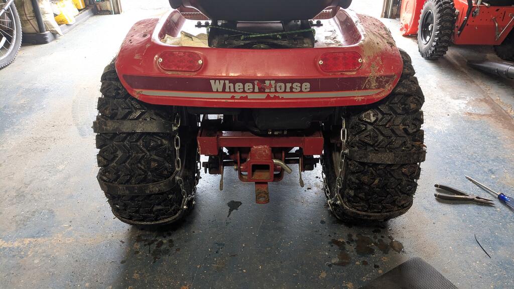

Alrashid2 476 #1 Posted March 2 (edited) Hey guys. This is my first time installing tire chains myself, and I bought myself some SoftClaw rubber tire chains. Installed them as per the instructions. Aired tires down, put the chains on, tightened up each side one link at a time. Was able to get tighten to the second link on both sides, but it took a long time. Spent about 45 minutes on each side and had to use screw drivers and pliers to pull the chain tight enough to get it tight. There is no way I can get to the third link on either side, let alone on both sides to make it tighter. Even still, the rubber bars seem way too loose. I can get my fingers under them, and they slide around on the tread. Aired tires back up to 10 PSI and took her for a spin in the woods. When I got back, the rubber bars were all crooked. None straight. And the entire chain assembly itself slide laterally, where the rubber was closer to the rim on one side of the wheel than the other... Needless to say something is up. My tires are 23x8.00-12, and the chains I bought are 23x8.00-12, so I got the exact size. If I can get these to work, I am for sure leaving them on all year long as this has been very difficult to install. What am I doing wrong? Do these just need to break in and mold to the tire? If somehow I can get one side up one link, is that OK to have 3 links tight on one side and just 2 on the other? Thanks all for the advice. PXL_20260302_180029553_TS.mp4 Edited March 2 by Alrashid2 Share this post Link to post Share on other sites

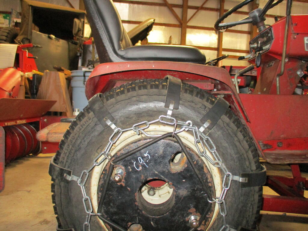

Ed Kennell 47,944 #3 Posted March 2 14 minutes ago, pfrederi said: Get another link on the inside Then hook the outside loosely and yank and pull to the outside. Then hook the outside as short as possible and install the chain tightener. After the straps conform to the tire shape, you will be able to retighten the outside chain. I put mine on and off in 10 minutes and never need to air down and up. I always cut the inside chain to the exact length so there are no loose links . Connect the inside chain with these. 1 Share this post Link to post Share on other sites

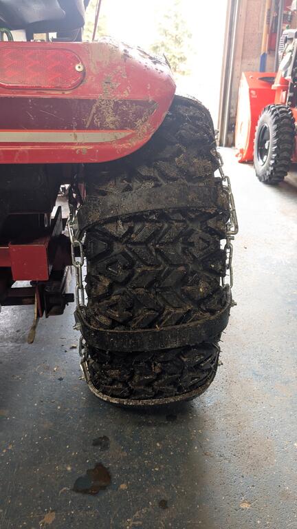

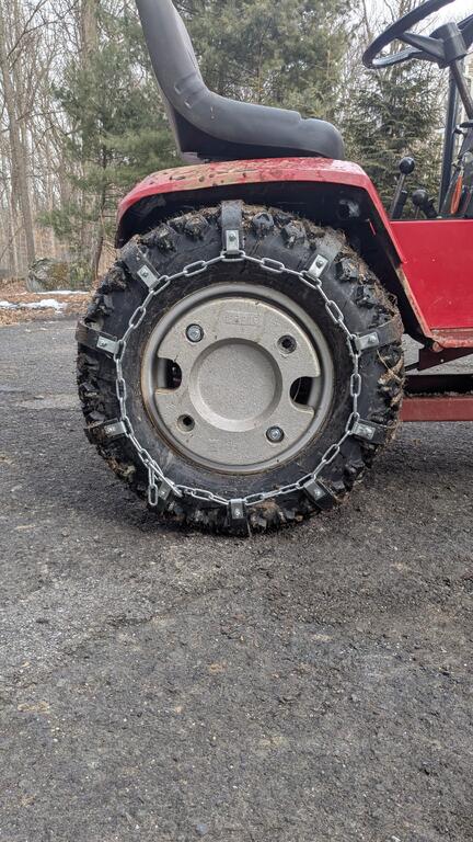

Alrashid2 476 #4 Posted March 2 Thanks guys! I've got an update. After driving for a bit on them I was able to tighten the OUTSIDE one more link. So 3 on outside, 2 on inside. I could only do it on the outside because that latch has so much more leverage, versus pulling the chain hook on the inside tighter. They are VERY tight now. Still able to slide crooked a bit, but not moving across the tread anymore. Going to run this a bit and see what comes of it. Unfortunately I don't think we're getting any more snow this year so will have to wait til next year to test them out officially! Share this post Link to post Share on other sites
Alrashid2 476 #5 Posted March 2 Another update. Took her around the property after tightening the outside one more link. Much better! They stayed tight, though one of the latches popped loose. It seems like it's just the way that side's chain is oriented. I tucked it back best I could and double zip tied it to the chain link. I've got ever so slight movement of the rubber but that seems to just be due to the way the links line up on either side. Also, the rubber bars are pulled more to the outside than the inside of the rim. This seems due to the 3 links vs 2 links, so the chain is tighter on the outside and thus pulling more. I still have full coverage across the tread so I assume that's fine? I'll also add, I took the tractor to an absolute mud pit of the property I never go to unless the ground is baked by the summer heat. Slipped in it for maybe a second or two, and then the rubber chains pulled me right out! How awesome! Think I'm sold 4 1 Share this post Link to post Share on other sites
lynnmor 9,081 #6 Posted March 2 You need to air the tires down to almost zero to adjust, even a few pounds can be too much, and then back up to your usual pressure. 2 Share this post Link to post Share on other sites

peter lena 10,125 #9 Posted March 3 @Alrashid2 your chain pull is not effective at all , https://www.google.com/search?q=tractor+supply+welded+rings&rlz=1C1CHBF_enUS866US866&oq=tractor+supply++welded+rings+&gs_lcrp=EgZjaHJvbWUyCggA using a center of wheel hub pull point , along with heavier hook end extension springs , like a thin straight screwdriver for spring slide lever , they also sell long extension springs , that you can cut your own out of , like a silicone aerosol spray for metal to rubber slide fit , helps it find itself , goes where it wants to be , low range crawl , will assist in setting , pete Share this post Link to post Share on other sites

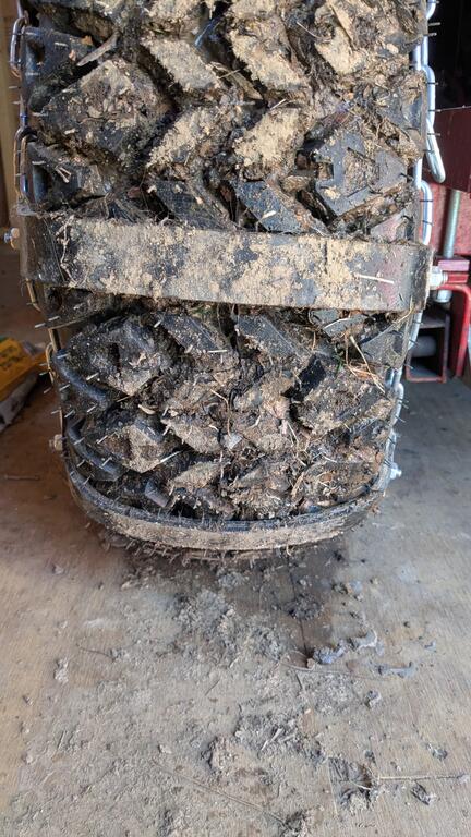

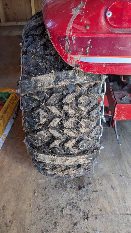

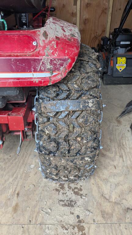

Alrashid2 476 #10 Posted March 9 Is this normal guys? Took the horse for a spin and post ride this is the result. I think it's because the outside is tighter by one link than the inside. I couldn't get the inside as tight to the same link, and loosening the outside one link to make them even was far too loose. As a result the links don't align so the rubber bars are oftentimes sitting cockeyed. Is this ok? Share this post Link to post Share on other sites
702854boy 1,245 #11 Posted March 9 I don't think that it will harm anything like that, it is still contacting the ground and isn't pushing into the tire or anything so I'd think it should be fine. Share this post Link to post Share on other sites
Ed Kennell 47,944 #12 Posted March 9 Now that you have used them and they molded to the tire shape, you may be able to gain another link on the inside. No harm if they move a bit, in fact, I believe the movement is what makes chains (rubber and steel) so effective. The movement keeps them clean while the gaps on a fixed tread tend to clog. 1 Share this post Link to post Share on other sites
