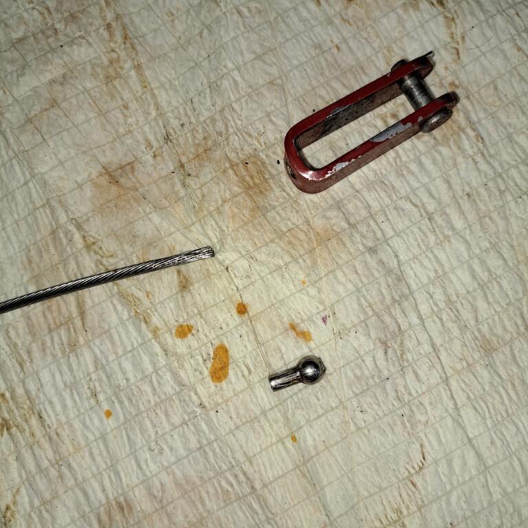

WHX?? 55,855 #1 Posted February 26 Well maybe not quite free but dang cheap. No offense Lowell but they can get somewhat pricey when one has more than one tractor. No idea if this will work but won't be for lack of tryin. Hardware store cable with a blob of braze on the end. 6 Share this post Link to post Share on other sites

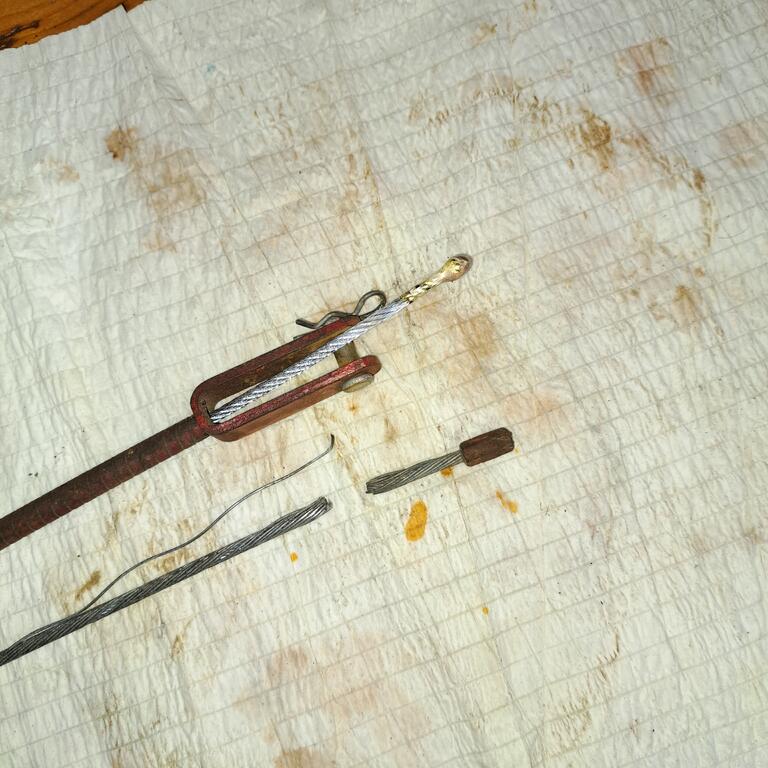

WHX?? 55,855 #3 Posted February 26 (edited) Here's one that will get the real test. Off the 1054 that broke when I was installing The @Pullstart's new drainage ditch. Brand new and again if Lowell was just down the road I know he'd give me a new one. For those who don't know about the weight of a long beam 953/1054 plow the cable sees humongous stress. This is why not having an extra on the plow field can put you out of action for the day. Edited February 26 by WHX?? 4 Share this post Link to post Share on other sites
Handy Don 16,143 #4 Posted February 26 It’ll be up to the cable strength where the heat of the braze might have affected its temper and how well the braze penetrated into the braid for adhesion. Frankly, I’m glad someone is giving this a try! Good luck 🤞 👍 😀 3 1 1 Share this post Link to post Share on other sites
WHX?? 55,855 #5 Posted February 26 2 minutes ago, Handy Don said: heat of the braze might have affected its temper and how well the braze penetrated into the braid f One thing that might affect it ... temper temper ... but flowed in the braid like water. As they say nothing ventured nothing gained. 5 1 Share this post Link to post Share on other sites

John2189 585 #9 Posted February 26 They sell crimp on ends for cable. 1 1 Share this post Link to post Share on other sites

WHX?? 55,855 #14 Posted February 27 (edited) 2 hours ago, squonk said: Make sure you drive it across Kevin's "yard " at high speed in transport mode. There fixed that for ya. 1 hour ago, John2189 said: They sell crimp on ends for cable. Yep thought of that and had one in my grubby mitts but I couldn't get enough crimp on it. 59 minutes ago, ineedanother said: I've considered crimping these a try I'm sure that's what Lowell uses and if a guy could make a die for his HF press. 13 minutes ago, AlexR said: brake cable from napa Does that come with the plastic coating on it? I like that ...smooth operation greasy Pete approved. What did you use for the crimp? Edited February 27 by WHX?? 2 Share this post Link to post Share on other sites

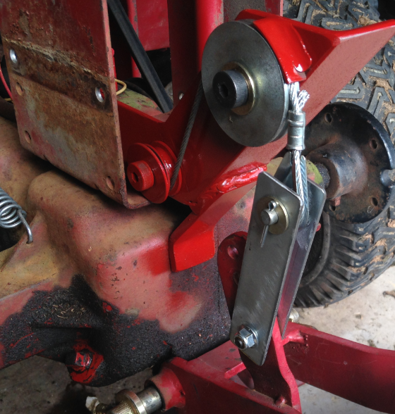

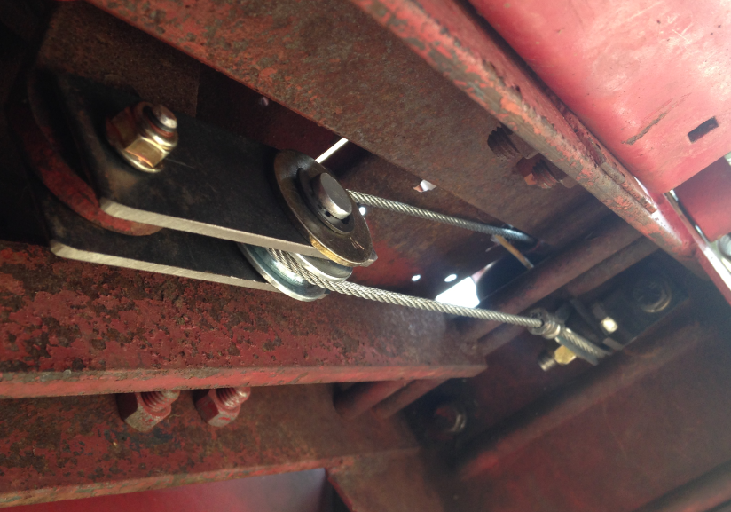

JoeM 9,718 #18 Posted February 27 I tried this contraption a few years ago, worked pretty good. 2 10 Share this post Link to post Share on other sites

953 nut 64,898 #20 Posted February 27 14 hours ago, Handy Don said: It’ll be up to the cable strength where the heat of the braze might have affected its temper and how well the braze penetrated into the braid for adhesion. Frankly, I’m glad someone is giving this a try! Good luck 🤞 👍 😀 The first home-made lift cable with a big glob of braze I made up didn't last very long, broke right near the braze. 11 hours ago, WHX?? said: I'm sure that's what Lowell uses and if a guy could make a die for his HF press. I cut "V" notches in a couple pieces of scrap steel to make a die. They were a PITA to align but got the job done. 1 1 Share this post Link to post Share on other sites
Handy Don 16,143 #21 Posted February 27 7 hours ago, JoeM said: I tried this contraption a few years ago, worked pretty good. Interesting since this appears to double the amount of cable pull for a given amount of lift lever movement. What effect did that have on the implements being lifted? 1 Share this post Link to post Share on other sites
JoeM 9,718 #22 Posted February 27 19 minutes ago, Handy Don said: Interesting since this appears to double the amount of cable pull for a given amount of lift lever movement. What effect did that have on the implements being lifted? Successful, I never calculated the total advantage, but the load was manageable. I used components that fit. the whole idea was born from an extra heavy box scraper. thinking with the manual lift It was less work to raise the heavy load. I later went to a hydro and the issue was null. I suppose the concept would work, say a given load like a tiller, could be lifted with a lot less effort using the sheave, while reducing the stress on the connection, just from an mechanical advantage?? 1 Share this post Link to post Share on other sites
8ntruck 8,713 #23 Posted February 27 31 minutes ago, Handy Don said: Interesting since this appears to double the amount of cable pull for a given amount of lift lever movement. What effect did that have on the implements being lifted? Drawback, though. This setup will also double the force required to lift the implement. 1 Share this post Link to post Share on other sites
WHX?? 55,855 #24 Posted February 27 (edited) 14 minutes ago, 8ntruck said: double the force required to lift the implement. I'm lost Truck ... I would think it would greatly decrease the force required? Kinda like a $natch block for a winch. No matter Joe that's using the old noggin for other than a hat rack. 1 hour ago, 953 nut said: broke right near the braze. What I'm afraid of Richard. Oh well it's a experiment. Edited February 27 by WHX?? 2 1 1 Share this post Link to post Share on other sites
