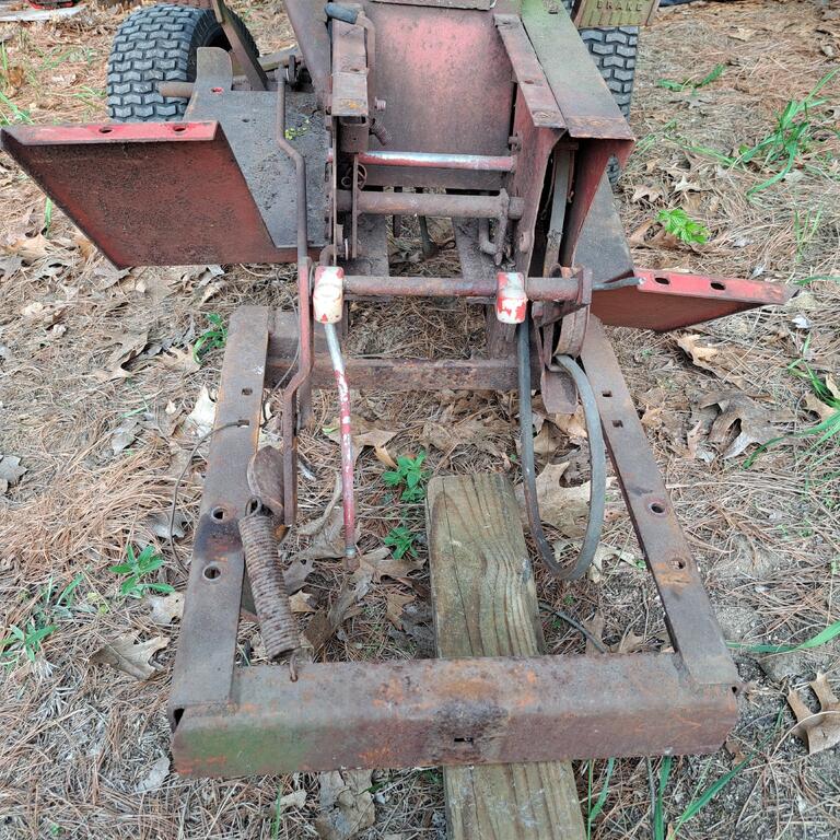

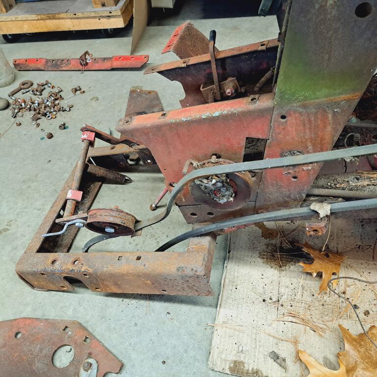

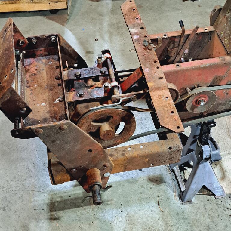

WHX?? 58,347 #21 Posted February 27 10 hours ago, Handy Don said: only with a different frame setup at the transaxle. Completely different. 10 hours ago, Easton Rich said: horizontal 8hp gen start Briggs Tecky ... the A-90 had a 8 HP SG Briggs These models were consider somewhat of a budget model and intended pretty much for mowing duties being the Peerless not being as stout as unidrives. One uses anything with the Peerless for ground engagement it's days are numbered. The rear setup with a Peerless so you can see how a using undrive would be a job. Share this post Link to post Share on other sites
Handy Don 17,668 #22 Posted February 27 1 hour ago, WHX?? said: These models were consider somewhat of a budget model and intended pretty much for mowing duties being the Peerless not being as stout as unidrives. One uses anything with the Peerless for ground engagement it's days are numbered. The rear setup with a Peerless so you can see how a using undrive would be a job. I've never seen one with the sheet metal removed before. Does the rear end of the frame have the F-plate where the Unidrive would attach? Makes me wonder if a complete rear-end swap (transaxle & fenders) might be possible if the drive belt could line up via the clutch pulley. Share this post Link to post Share on other sites
WHX?? 58,347 #23 Posted February 27 2 hours ago, Handy Don said: Does the rear end of the frame have the F-plate where the Unidrive would attach? No totally different animal. I suppose a guy could fab the F plate to match alignment but might be easier swapping to a F plate frame. Linkage is altogether different too. 1 1 Share this post Link to post Share on other sites
Handy Don 17,668 #24 Posted February 27 36 minutes ago, WHX?? said: No totally different animal. For sure. Thanks for the extra pictures. Learned good stuff today. Did some research on the Peerless. It was a common item in basic lawn tractors. Clever design for manufacture and operation to give six speeds in a compact package with a straight-line shifter but definitely a mower-grade transaxle. I once witnessed a fellow plowing a 3” snowfall on a level, paved driveway with a 10hp Snapper RER and it seemed to work well. In conversation, he relayed that deeper or wetter snow would stymie the machine. Share this post Link to post Share on other sites
