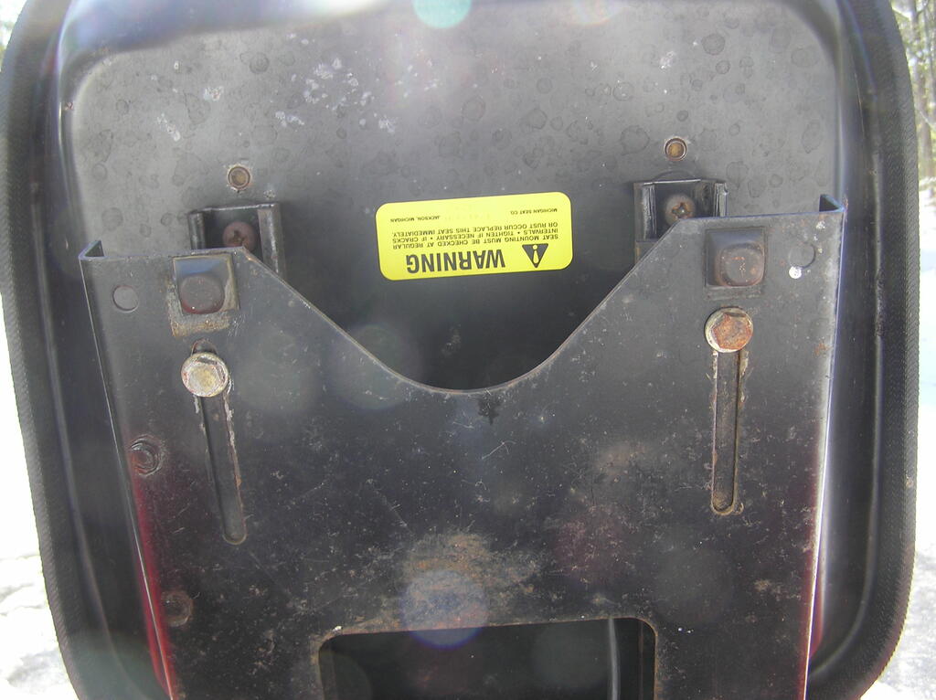

Wayne0 1,571 #1 Posted February 26 The seat is too far forward! The slider only goes back about 2 inches. Is that right or is there something wrong with it? The bracket is all the way back on the springs. Is there another set of holes in the seat pan? Share this post Link to post Share on other sites
ri702bill 12,470 #2 Posted February 26 Some folks have both raised the seat & moved it back - a bit - using square tubing. Don't overdo it - your weight needs to be on top of the rear axle, not behind it. Share this post Link to post Share on other sites
Ed Kennell 46,549 #3 Posted February 26 I used 2" wooden blocks under the seat pan to raise mine. Much better seat position and more clearance for the tire chains. Share this post Link to post Share on other sites
Handy Don 16,928 #4 Posted February 26 The slides WH used have only that short travel. Our family has operators with heights from 60” to 74” so I’ve added sliders from other vendors with 6.5” travel. They also raise the seat about 0.75" There have been some notable complications: 1. As @ri702bill notes, putting weight aft of the rear axle can negatively affect the tractor’s stability--surprise backflips become a real danger 2. The “button in the fender” style seat safety interlock becomes iffy when the operator is light and farther forward. I’ve lengthened both the spring and the plunger and added a sleeve guide to counteract this but it’s a balancing act to keep it both safe and effective. 3. Moving the seat too far forward can interfere with the gearshift and/or tunnel-mounted motion control 2 Share this post Link to post Share on other sites
Wayne0 1,571 #5 Posted February 26 25 minutes ago, Handy Don said: The slides WH used have only that short travel. Our family has operators with heights from 60” to 74” so I’ve added sliders from other vendors with 6.5” travel. They also raise the seat about 0.75" There have been some notable complications: 1. As @ri702bill notes, putting weight aft of the rear axle can negatively affect the tractor’s stability--surprise backflips become a real danger 2. The “button in the fender” style seat safety interlock becomes iffy when the operator is light and farther forward. I’ve lengthened both the spring and the plunger and added a sleeve guide to counteract this but it’s a balancing act to keep it both safe and effective. 3. Moving the seat too far forward can interfere with the gearshift and/or tunnel-mounted motion control I'm not worried about weight aft of the axle as there is a big a** 2 stage on the front that lives there. Safety switch is in the seat. I'll have to research longer sliders. Share this post Link to post Share on other sites
Handy Don 16,928 #6 Posted February 26 31 minutes ago, Wayne0 said: I'm not worried about weight aft of the axle as there is a big a** 2 stage on the front that lives there. ✅ Safety switch is in the seat. I'll have to research longer sliders. Seat switch: Then only need a heavy enough operator sitting in the right spot! Longer sliders: one set came from a Simplicity Sovereign. Another was from a go-cart supplier. I also saw that Surplus Center once had them with a complete seat subframe. Share this post Link to post Share on other sites

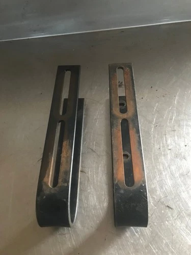

Wayne0 1,571 #7 Posted February 26 Thinking about these. https://www.amazon.com/gp/product/B0F2658W1Z/ref=ox_sc_act_title_1?smid=ATVPDKIKX0DER&psc=1 Share this post Link to post Share on other sites
Handy Don 16,928 #8 Posted February 26 17 minutes ago, Wayne0 said: Thinking about these. https://www.amazon.com/gp/product/B0F2658W1Z/ref=ox_sc_act_title_1?smid=ATVPDKIKX0DER&psc=1 Flag for me: - No dimensions listed: length, width, hole spacing, travel - fixed side-to-side postion - potential interference with the release actuator These interest me more, assuming overall dimensions and seat attachment can work. No futzing with rail spacing. Good travel. Share this post Link to post Share on other sites
Wayne0 1,571 #9 Posted February 26 (edited) On 2/26/2026 at 3:13 PM, Handy Don said: Flag for me: - No dimensions listed: length, width, hole spacing, travel - fixed side-to-side postion - potential interference with the release actuator These interest me more, assuming overall dimensions and seat attachment can work. No futzing with rail spacing. Good travel. That IS interesting! I'll have to take some measurements. The price is right!! Well, I won't be going that route. Shipping is more than twice the cost of the part! Edited February 28 by Wayne0 Share this post Link to post Share on other sites
Handy Don 16,928 #10 Posted February 26 8 minutes ago, Wayne0 said: That IS interesting! I'll have to take some measurements. The price is right!! And the slide alignment (which is fiddly) is locked in. 1 Share this post Link to post Share on other sites
squonk 47,360 #11 Posted February 26 1 hour ago, Wayne0 said: Thinking about these. https://www.amazon.com/gp/product/B0F2658W1Z/ref=ox_sc_act_title_1?smid=ATVPDKIKX0DER&psc=1 This might be a better choice https://www.amazon.com/Racewill-Slider-Assembly-Hardware-Universal/dp/B0BKRMS6NJ/ref=vse_cards_0?_encoding=UTF8&pd_rd_w=ujkuA&content-id=amzn1.sym.26dedd2b-540b-4bff-af75-7fea8d8f8913&pf_rd_p=26dedd2b-540b-4bff-af75-7fea8d8f8913&pf_rd_r=7TSCCXXXXRDMZ3JWMRMC&pd_rd_wg=tr4dB&pd_rd_r=eae0687a-8d88-4a6a-bf40-f8af8f094e0e&th=1 I was looking for some adjustability for my 875 and 875 seat. Went to a local Pick your Part and they had a couple of riders in the pile with slotted u shaped seat springs. 1 Share this post Link to post Share on other sites
Wayne0 1,571 #12 Posted February 26 Unfortunately the WH brackets are 11" apart where those are 14". I suppose I could fab new brackets, but the bolt holes don't work. I couldn't use both holes. I'm not giving up yet. May have to drill and tap new holes. Share this post Link to post Share on other sites
Wayne0 1,571 #13 Posted February 26 7 minutes ago, squonk said: This might be a better choice https://www.amazon.com/Racewill-Slider-Assembly-Hardware-Universal/dp/B0BKRMS6NJ/ref=vse_cards_0?_encoding=UTF8&pd_rd_w=ujkuA&content-id=amzn1.sym.26dedd2b-540b-4bff-af75-7fea8d8f8913&pf_rd_p=26dedd2b-540b-4bff-af75-7fea8d8f8913&pf_rd_r=7TSCCXXXXRDMZ3JWMRMC&pd_rd_wg=tr4dB&pd_rd_r=eae0687a-8d88-4a6a-bf40-f8af8f094e0e&th=1 I was looking for some adjustability for my 875 and 875 seat. Went to a local Pick your Part and they had a couple of riders in the pile with slotted u shaped seat springs. Good find on that one! Around here they don't have that kind of yard. Share this post Link to post Share on other sites
Wayne0 1,571 #14 Posted March 4 (edited) Update. I ordered a set and received them today. https://www.amazon.com/dp/B0DK9F6HVB?ref=ppx_yo2ov_dt_b_fed_asin_title. Looked like a drop in. Wrong! Holes in the spring are 8" OC, the sliders are 7.9! So close!! Hogging out the springs is a no go as to the hardness. I'm going to punch out the staked in bolts on the sliders and file out the hole. We'll get 'er done! Once I'm done the old sliders are available for the price of shipping. PM me if interested. Edited March 4 by Wayne0 1 1 Share this post Link to post Share on other sites
