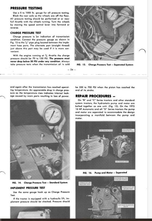

gwest_ca-(File Mod) 12,416 #3 Posted February 22 Do not have the answer but a link to some info. Should be model 90-1140 Share this post Link to post Share on other sites

ineedanother 2,768 #13 Posted March 3 On 2/23/2026 at 11:21 PM, Bdja54 said: Anyone in Rhode Island area that knows how to repair these? I don't think you're necessarily facing a "repair" issue. Your pump and motor seem to be working so my advice would be to download the manual in post #3 above and make sure the pieces and parts for the relief valves are present and installed correctly. 1 Share this post Link to post Share on other sites
