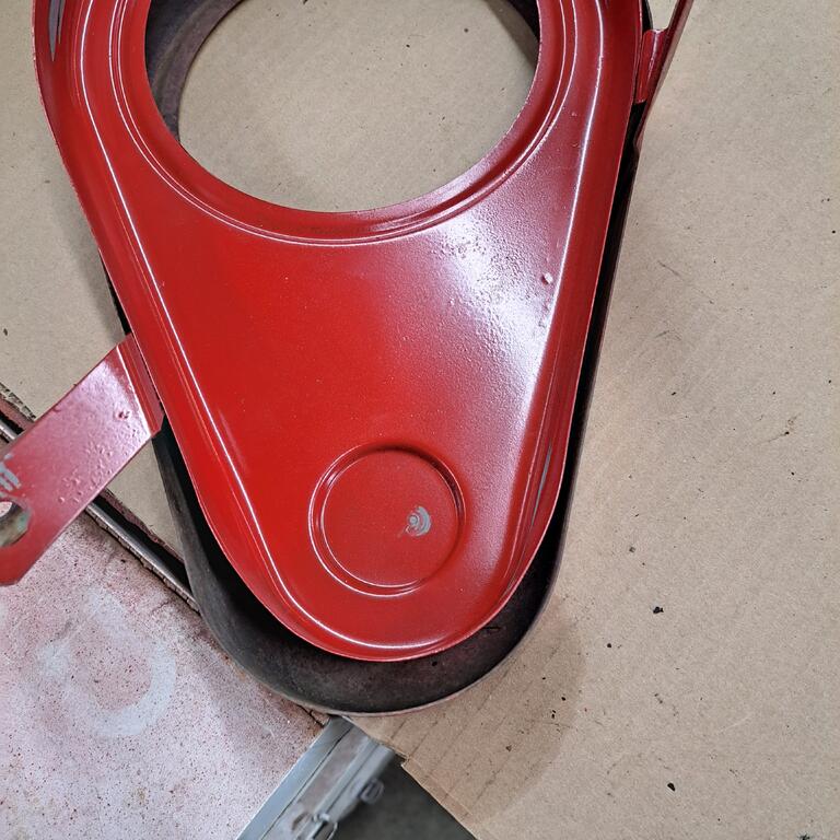

WHX?? 58,125 #1 Posted February 21 Had The Pullstart pick me one at the BS couple years ago. Went to install it on a 8 HP and could not get it to quit rubbing. No wonder they are not all the same size. The ones with the three indents are larger than ones without. Especially on the SG end. Smaller ones are for a 7 HP????? Share this post Link to post Share on other sites
wallfish 20,618 #2 Posted February 21 Hmmm. I've never really noticed that either but all the 7s I've had were pull starts. Maybe go with a 30" belt instead of a 31.5" 2 Share this post Link to post Share on other sites

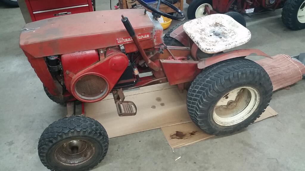

WHX?? 58,125 #3 Posted February 22 41 minutes ago, wallfish said: go with a 30" belt Thought of that too but was in githerdone so robbed from peter to pay paul. 2nd pic it looks bigger but it's not just the pic. Spent a hour of my life trying to get it to fit. There's an hour I won't get back. Share this post Link to post Share on other sites
wallfish 20,618 #4 Posted February 22 19 minutes ago, WHX?? said: Spent a hour of my life trying to get it to fit. There's an hour I won't get back All perspective. There's an hour you learned something too. Learning what not to do is just as important as learning what to do. It ain't gonna take you an hour the next time! 2 4 Share this post Link to post Share on other sites
WHX?? 58,125 #5 Posted February 22 1 minute ago, wallfish said: There's an hour you learned something too. Yah ... learned to not let Kev do my shopping ... 6 Share this post Link to post Share on other sites

ri702bill 13,063 #7 Posted February 22 AND there are a couple more variants... The 701 double-pulley belt guard, and the 702 style - similar to the one without the ribs, but has a much smaller dimple at the small end, not a full circle... 2 Share this post Link to post Share on other sites

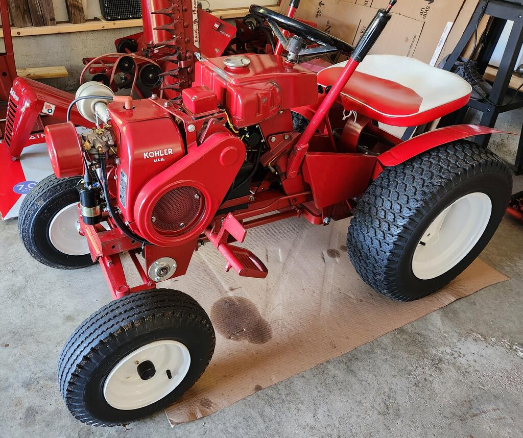

Racinbob 13,189 #8 Posted February 22 This is the 7hp I replaced the 8hp on my 854. It was a yank start so I put all the goodies from the 8 on to the 7 from the flywheel out to convert to s/g. If it's the grass screen rubbing could it be that it is a different screen? Note how the shroud is fully outside of the screen. 2 Share this post Link to post Share on other sites
squonk 48,124 #9 Posted February 22 12 hours ago, WHX?? said: Had The Pullstart pick me one at the BS couple years ago. Went to install it on a 8 HP and could not get it to quit rubbing. No wonder they are not all the same size. The ones with the three indents are larger than ones without. Especially on the SG end. Smaller ones are for a 7 HP????? 2 different Gen pulleys? Remember I have a 7 and 8 on the bench with the 2 pulleys and that may be the difference? 1 Share this post Link to post Share on other sites
WHX?? 58,125 #10 Posted February 22 4 hours ago, squonk said: 2 different Gen pulleys? Would stand to reason the smaller guard would have a smaller pulley. Might matter if it was the short or long SG? 1 Share this post Link to post Share on other sites
squonk 48,124 #11 Posted February 22 2 small blocks on the bench. Closest one is an 8. Had the larger guard with the 3 lines. 3" pulley. Farther one is a 7. Came with no guard. 3 1/8" pulley. 2 Share this post Link to post Share on other sites
Chris G 3,392 #12 Posted February 22 I can double check but I do believe those are actually listed with different part number, In the Kohler engine books i have Share this post Link to post Share on other sites
WHX?? 58,125 #13 Posted February 23 7 hours ago, Chris G said: different part number, You mean the guards? I'm sure they do. Are those both the longer starter Squonky? Anybody got a 161 they can measure the pully? Share this post Link to post Share on other sites
squonk 48,124 #14 Posted February 23 6 minutes ago, WHX?? said: You mean the guards? I'm sure they do. Are those both the longer starter Squonky? Anybody got a 161 they can measure the pully? Yes both long gens and that one to the right is a 161. 3 1/8" OD 1 1 Share this post Link to post Share on other sites

Retired Wrencher 6,989 #17 Posted February 23 19 hours ago, squonk said: 2 small blocks on the bench. Closest one is an 8. Had the larger guard with the 3 lines. 3" pulley. Farther one is a 7. Came with no guard. 3 1/8" pulley. That’s interesting Mike. I’ve always had a start gen belt that I bought from the dealership years ago and it never worked and it was too long so the information that you supplied is the reason why that belt never fit what I had. 1 Share this post Link to post Share on other sites
Handy Don 17,474 #18 Posted February 23 (edited) I have the “no indent” cover on the 854 with a short gen. No reason to believe these aren’t original. The IPL belt turned out to be too short which kept the generator tight up against the regulator and had the pulley rubbing the guard. Slightly longer belt solved both issues. I suspect there might be small and large versions of the “no indent”. I’ll measure mine later. Edited February 23 by Handy Don 1 Share this post Link to post Share on other sites
