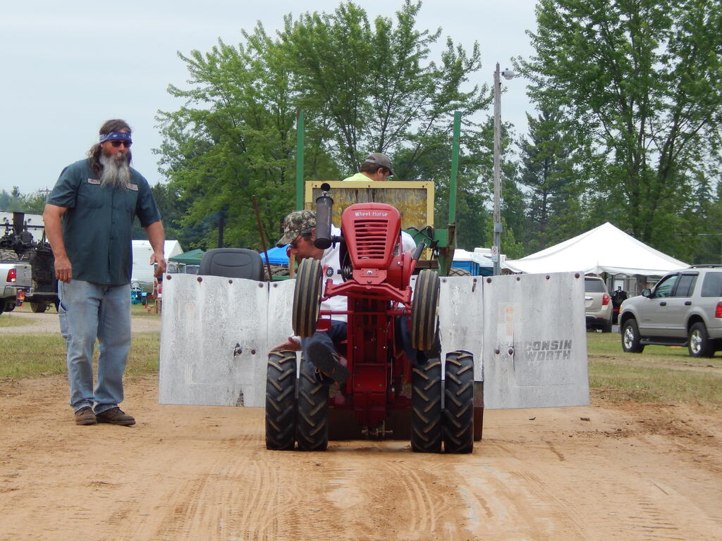

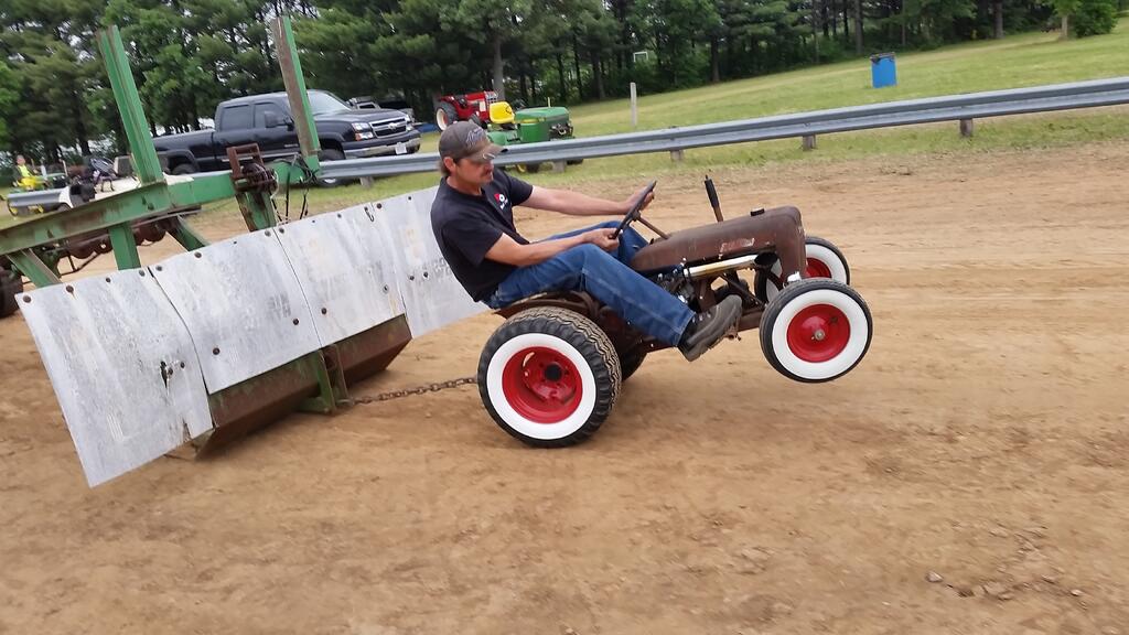

WHX?? 58,388 #8 Posted February 22 11 hours ago, wallfish said: will immediately go to wheelies So now you got something against wheelies????? 1 3 Share this post Link to post Share on other sites
wallfish 20,744 #9 Posted February 22 11 minutes ago, WHX?? said: So now you got something against wheelies????? If I see one more round hood wheelie 1 Share this post Link to post Share on other sites
WHX?? 58,388 #10 Posted February 22 6 minutes ago, wallfish said: If I see one more round hood wheelie Enough my gut hurts again... 1 1 Share this post Link to post Share on other sites
wallfish 20,744 #11 Posted February 22 2 minutes ago, WHX?? said: Enough my gut hurts again... Are you trying to make me go postal tonight! That's twice! 1 1 Share this post Link to post Share on other sites
