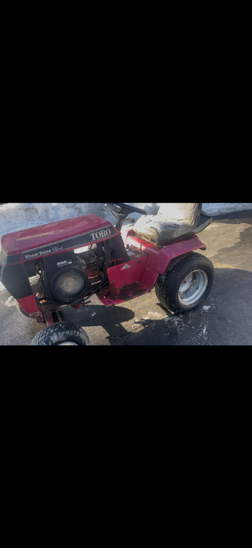

AHS 1,703 #1 Posted February 20 New to me! Oil change/ hydro oil filter/air filter. Fuel line/ petcock and filter change… and it’s running! (It’s running in the picture). Ive taken off the carb bowl and cleaned it out. Cleaned / Sprayed out the high and low speed screws. (Kohler spec) Set them to 2 1/2 turns out and it runs BUT…. It takes a long time to fire up. Let’s. Say you flip the throttle quickly.. it’ll die. But, wont if you gradually increase the throttle. What is the culprit that’s making it die when you throw it suddenly? Share this post Link to post Share on other sites

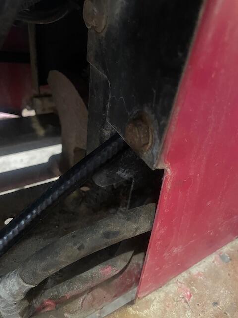

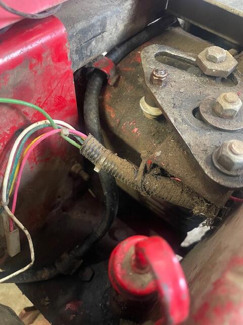

ineedanother 2,885 #5 Posted February 20 Long fuel line is most likely the culprit IMO. If you consider an electronic fuel pump wired to the "I" tab on the ignition you will be able to fill the bowl on the carb before you crank it and will likely see a great improvement. A fuel bulb is a cheaper and easier solution. 2 2 Share this post Link to post Share on other sites
kpinnc 19,107 #6 Posted February 20 13 minutes ago, ineedanother said: If you consider an electronic fuel pump wired to the "I" tab on the ignition you will be able to fill the bowl on the carb before you crank it and will likely see a great improvement. A fuel bulb is a cheaper and easier solution. On every machine with the fuel tank under the seat, this makes a huge difference. Heck, I think it improves with high mount tanks under the steering wheel. 4 Share this post Link to post Share on other sites

AHS 1,703 #8 Posted February 20 As you can see in the background, we have snow! It’s been creeping up close to 40 everyday. I am icthin’ in hands but my brain is telling my body to wait another month!! Another culprit, the fuel line is on the left (by the hydro filter); the fuel line makes a quick jump in the shifting linkage and then goes down slowly under the motor. Pictures would help! Ill get pictures this week coming! It’s that quick jump that concerns me! Share this post Link to post Share on other sites
AHS 1,703 #9 Posted February 20 Ive opened up my slow speed screw by 1/2 a turn. This is the hose routing i was talking about, it’s all in the clips, so it’s factory? The problem the fuel line goes way up near the gas tank. I would rather have the fuel go down slowly. How does your fuel line routed? I spotted that its got a aftermarket plastic fuel pump, but it works…. Share this post Link to post Share on other sites

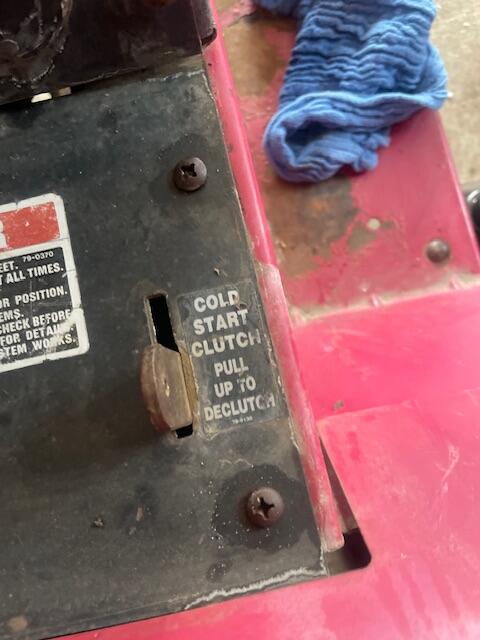

AHS 1,703 #11 Posted February 21 Ah hah!! At 12 degrees this morning, i pulled up the hydro tranny clutch. It spun over faster and started like normal!! Wow!! Huge improvement!!! Yesterday, and all the other times i had let the motor spin the transmission. 1 Share this post Link to post Share on other sites
