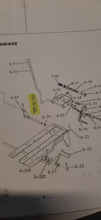

John c 224 #1 Posted February 19 Look at the picture, what's that thing called, and better yet has anybody got a part # ? Every parts manual I've seen don't give any details. I need one for the B100 project. Share this post Link to post Share on other sites
WHX?? 58,382 #2 Posted February 19 I would call it a neutral detent. Since it doesn't have a number in the IPL it might not have a part number. I'll take a look at carcasses see if I have one. 3 Share this post Link to post Share on other sites
ebinmaine 81,248 #3 Posted February 19 9 minutes ago, WHX?? said: I would call it a neutral detent. Since it doesn't have a number in the IPL it might not have a part number. I'll take a look at carcasses see if I have one. Seems reasonable. 13 minutes ago, John c said: I need one Meh.... You really don't. The detent on my '75 C160 Automatic hasn't been used in years. The little metal groove actually has very little to do with the neutral hold. That's built into the shifter. 1 Share this post Link to post Share on other sites
gwest_ca-(File Mod) 12,554 #4 Posted February 20 Appears it was used on other models as well. Item #6-34 https://www.partstree.com/models/61-12ks02-c-120-toro-lawn-tractor-1976/6-000-brake-clutch-speed-control-linkage-4/ The parts lists it shows up in Part #103996 https://www.partstree.com/parts/toro-103996/ Share this post Link to post Share on other sites
John c 224 #5 Posted February 20 I don't know what I don't know, this whole sunstrand hydro game is new to me, so IDK. The ole B100 I'm fooling with has one with the middle part missing, the theory of it seems sound in my mind, I figured I'd start looking for one now. ? thanks 1 Share this post Link to post Share on other sites

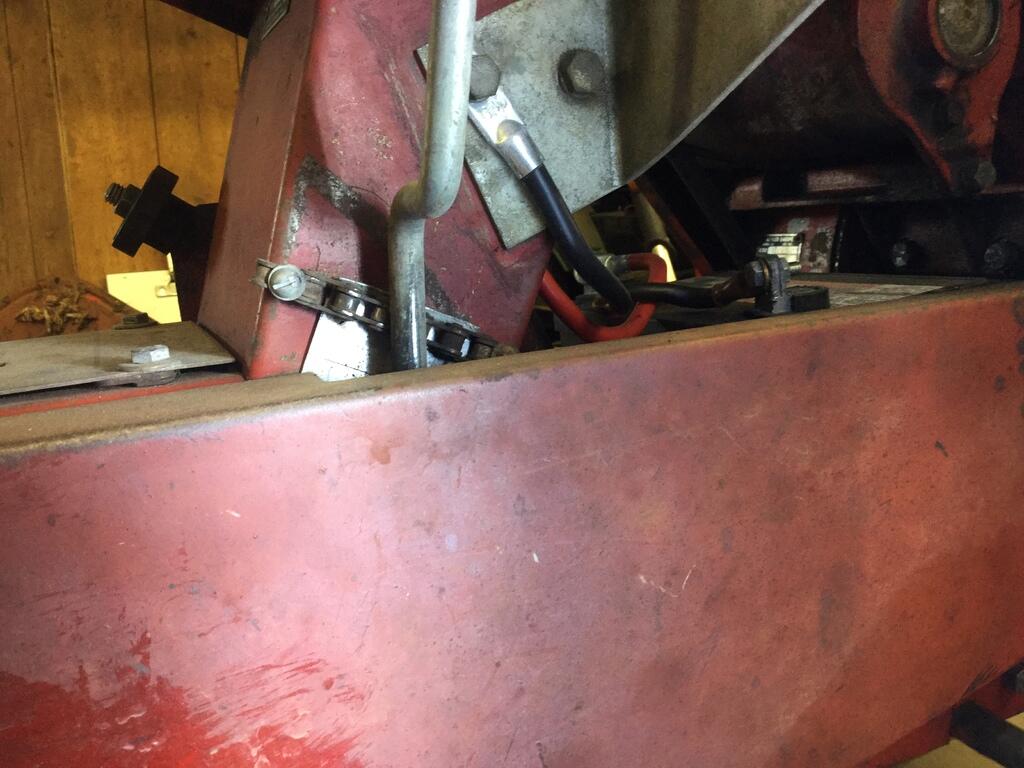

ACman 7,762 #6 Posted February 20 Don’t know if this would work for you but the previous owner of this 1276 was an engineer for GM . He used roller chain to act as detents so he didn’t have a creeping problem . 2 2 Share this post Link to post Share on other sites
